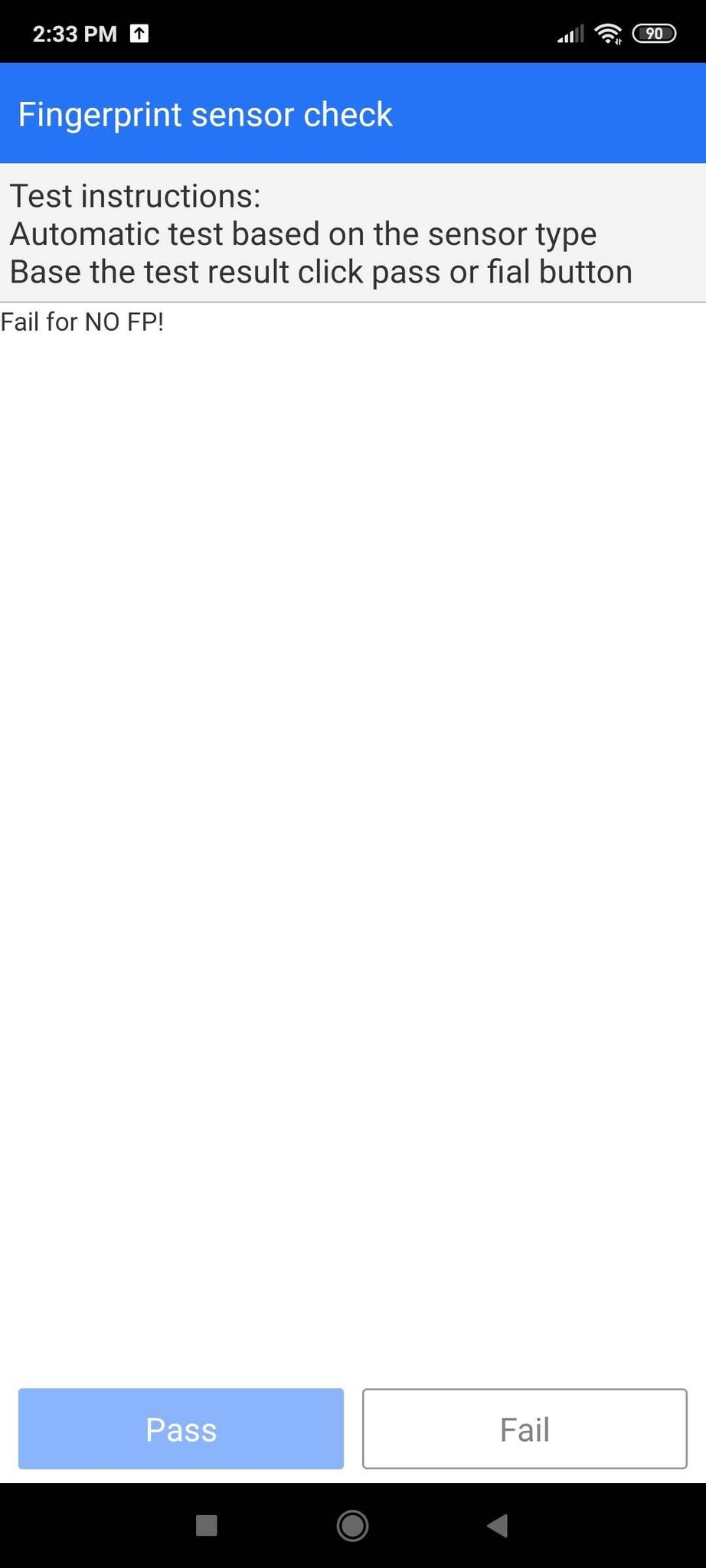

Hey all. I'm new in town here and the F2 pro is my first Xiaomi phone. I have a history with OnePlus devices and did a lot of flashing on them.
I originally flashed the Miui12 zip for my phone, but I really want to use root so I tried flashing back to miui 11.
I formatted in TWRP, transfered the Miui 11 zip (v11.0.19) and magsik etc, flashed them both and everything has booted fine. My issue is the fingerprint sensor appears to be disabled somehow.
I checked the CIT menu and ran the fingerprint sensor check, and it told me "test fail NO FP". I'm a little lost. If anyone has any support if greatly appreciate it!

As a Dev posted here https://xiaomi.eu/community/threads/weekly-confirmed-issues-faq.46800/post-447858 in the Frecuently Asked, maybe you should try that.

First and foremost, thank you for your response!
Tried looking at the link, but didn't really find any solutions. However, I didn't realize that the stable MIUI 12 build was still Android 10 and not 11, so I'll flash that and should hopefully have magisk working for root. That was the main reason I even tried to flash the MIUI 11 zip.

I have the same prioblem ,I lost my fingerprint too! what to do now how to fix it please help????
