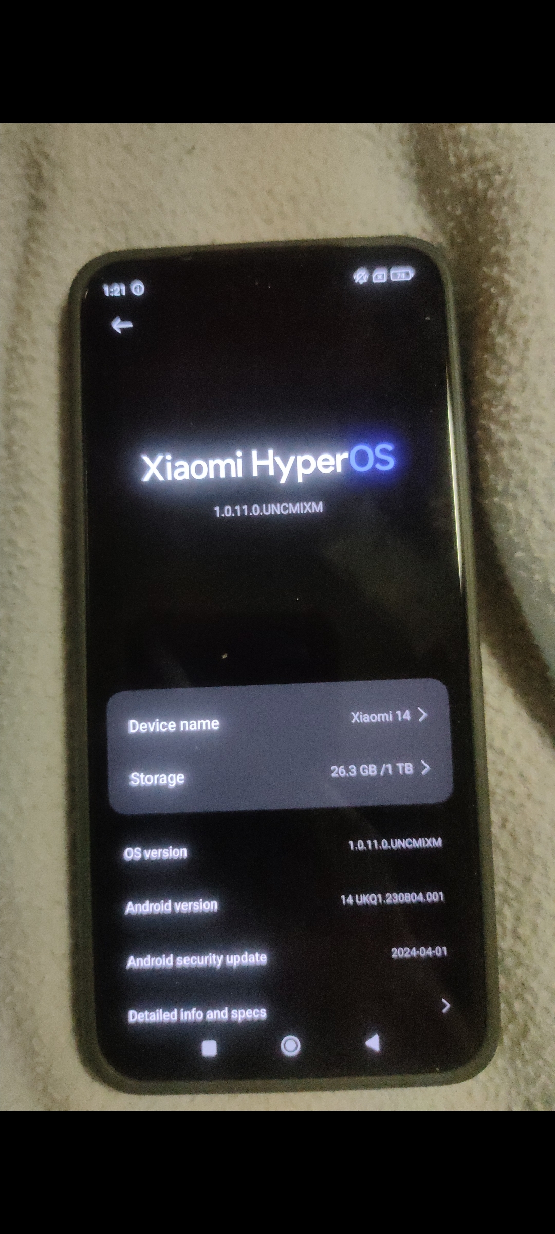

hi, fogging lens are true in Xiaomi 14. outdoors, the main lens fogs up after 3 minutes of shooting in 4k.
is a manufacturing defect. Fog is condensation of moisture.Condensation is bad, after a while the lens will be dirty and need to be cleaned.Return the Xiaomi 14 phone to the seller immediately. The lens must be dry and clean!
