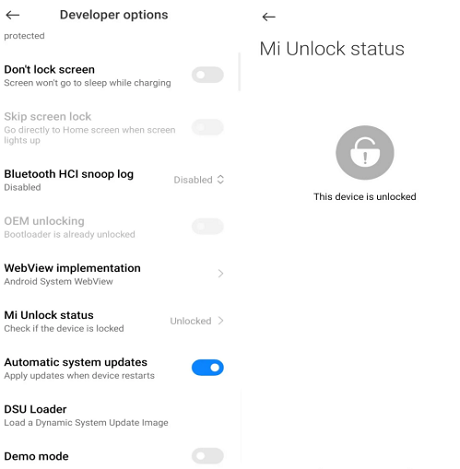

I have updated the Xiaomi community and the unlock bootloader already shows i can unlock on 28 june
If you have a CN device you cannot unlock the bootloader.
As I wrote above, I assume that your bootloader is already unlocked. Check it out.
1. Restart your device and you should see the "lock" unlocked or locked.
2. or check it in developer options

1 & 2 confirmed says unlocked but i will try number 3 tomorrow thank you so much again for replying my queries
I think you have an unlocked bootloader and there is no need for exam 3. You can proceed to install the xiaomi.eu ROM.

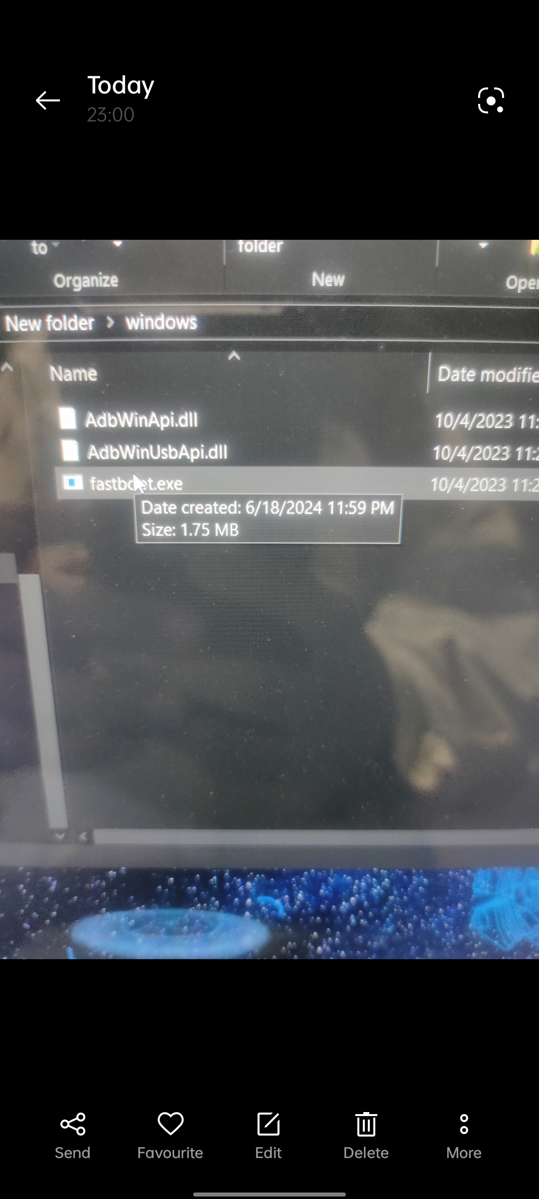

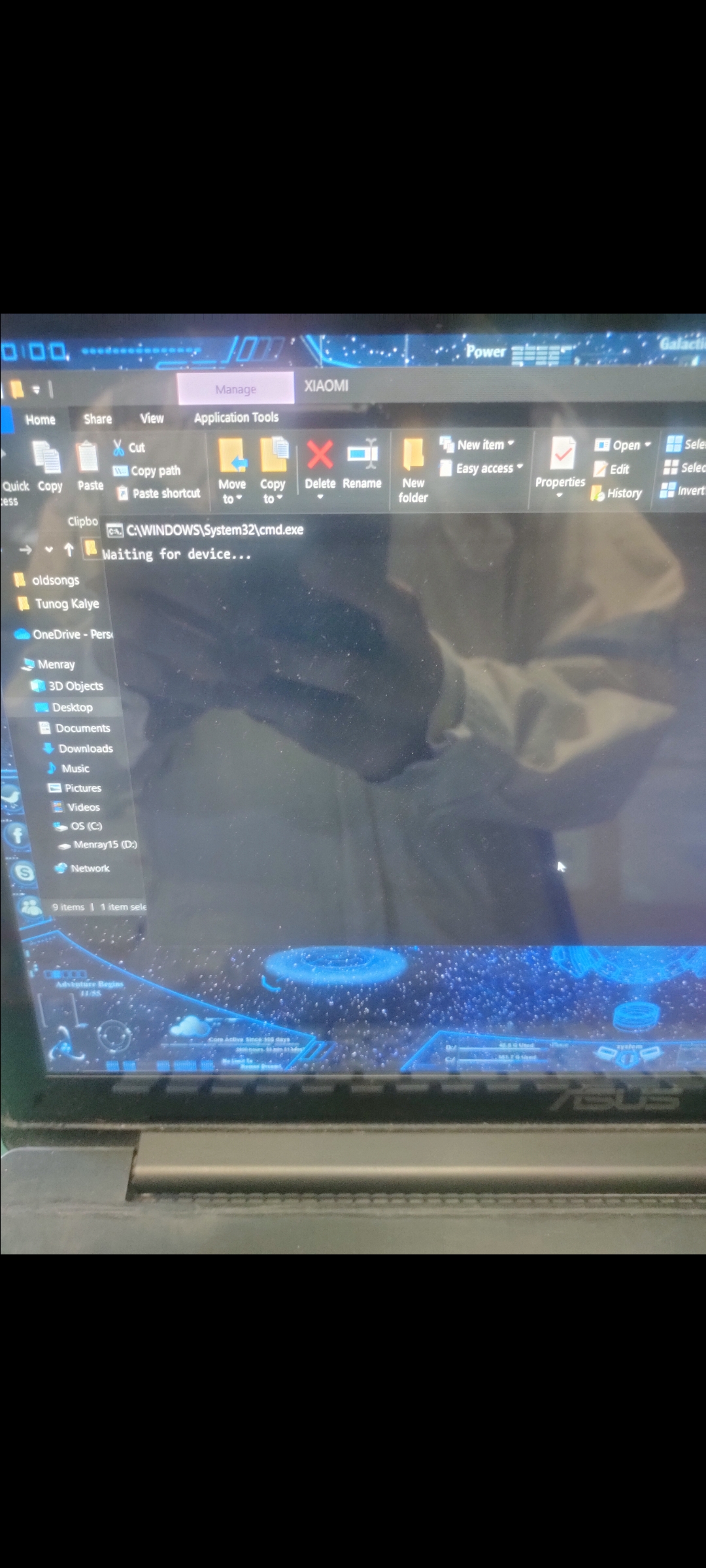

Im starting to flash using the fastboot method from your guide is it usually takes long time?

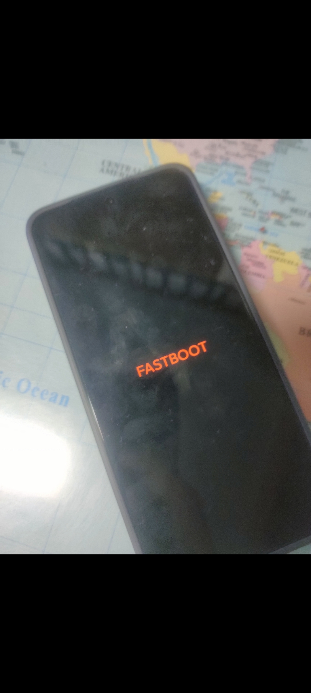

Thanks I've done flashing but the phone still on FASTBOOT mode and the windows bat already closed itself

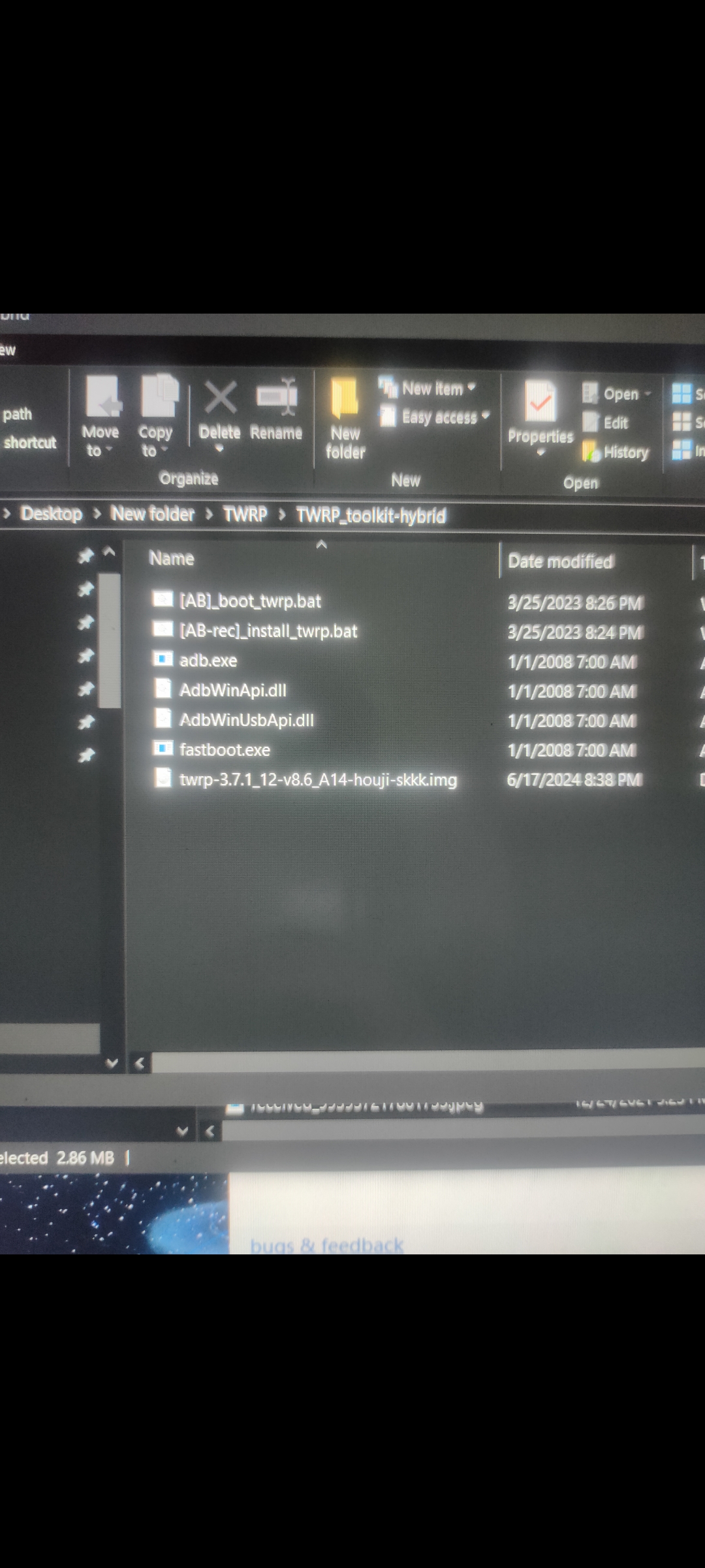

Update i install the TWRP with A/B rec the repeat rom flashing the it shows MI logo then back to FASTBOOT mode
You have not installed TWRP. You don't have a renamed TWRP file.
Read the instructions again and carefully.
Sorry i sent the wrong photo. I haved follow the TWRP but transferring the ROM to phone storage i didn't try because the phone is on FASTBOOT mode. Is it okay i will open to put the rom to phone storage then put back to FASTBOOT mode again?
I renamed to twrp.img then run AB rec and follow instruction volume up and power long press then fastboot again
I did not write that you should boot the device into TWRP (recovery).
1, Install TWRP twrp-3.7.1_12-v8.6_A14-houji-skkk.img
2, repeat the ROM installation in fastboot
3,Install the app for GPayFix XiaomiEUModule_2024.05.22.apk
I give up, I cannot endlessly repeat the information already written. Sorry.
