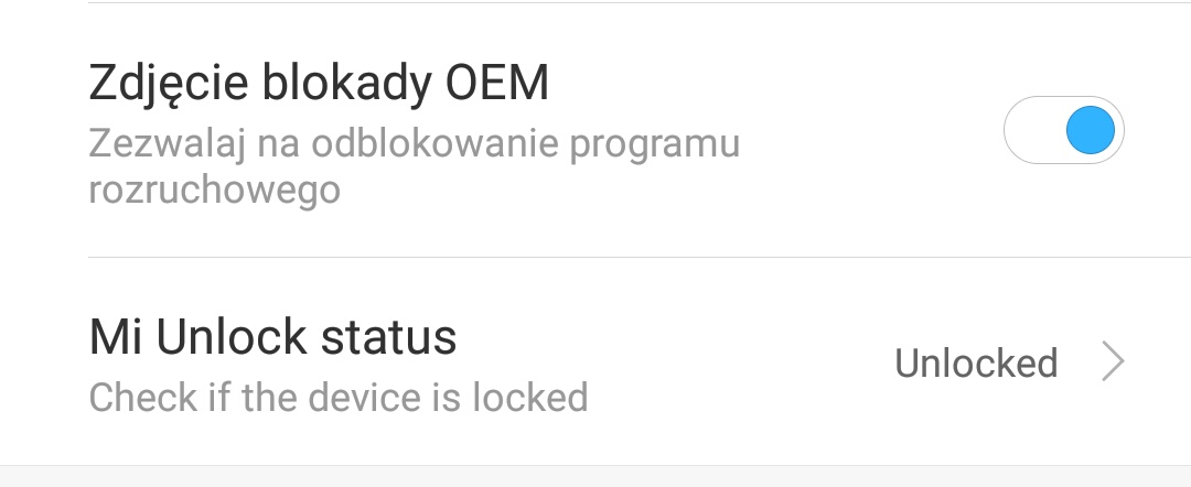

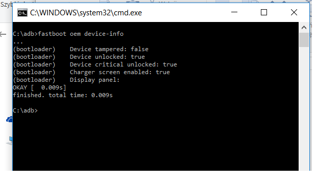

1) turned off "find my device" option in MI Account
2) went to "developers options" -> "Mi Unlock Status" -> clicked "add mi account" or something like this (there is only one button there if the phone is locked), OEM Unlock option has to be turned on aswell.
3) rebooted to fastboot, used mi flash unlock tool (official one)
4) rebooted the phone and it's unlocked
screenshot attached

1) turned "find my device" option in MI Account
screenshot attached

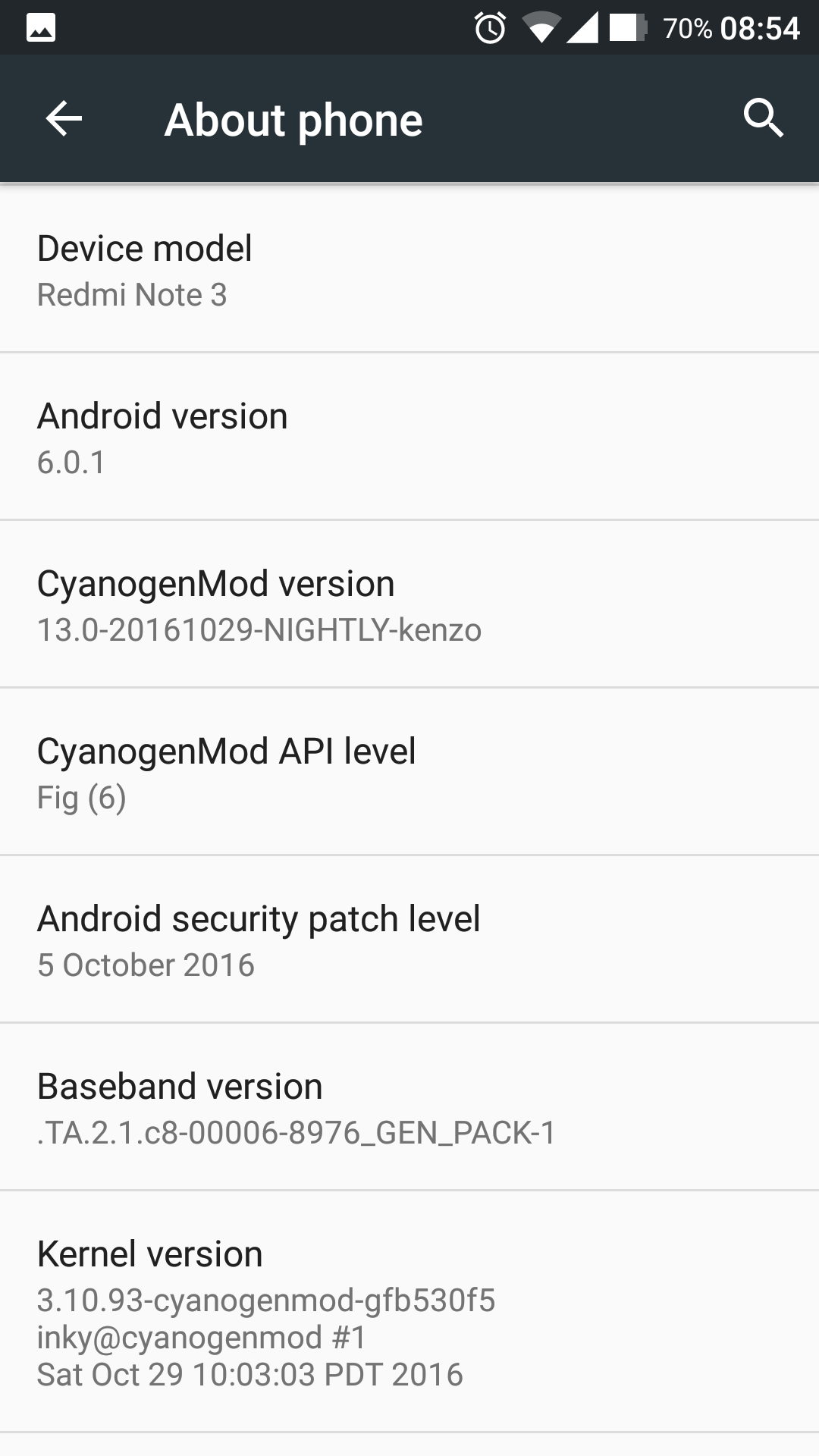

can you post here screenshot from About phone screen? are you sure, you got "kate" and not "kenzo"..? as you are only one who say "Unlocked it officially"
screenshot attached

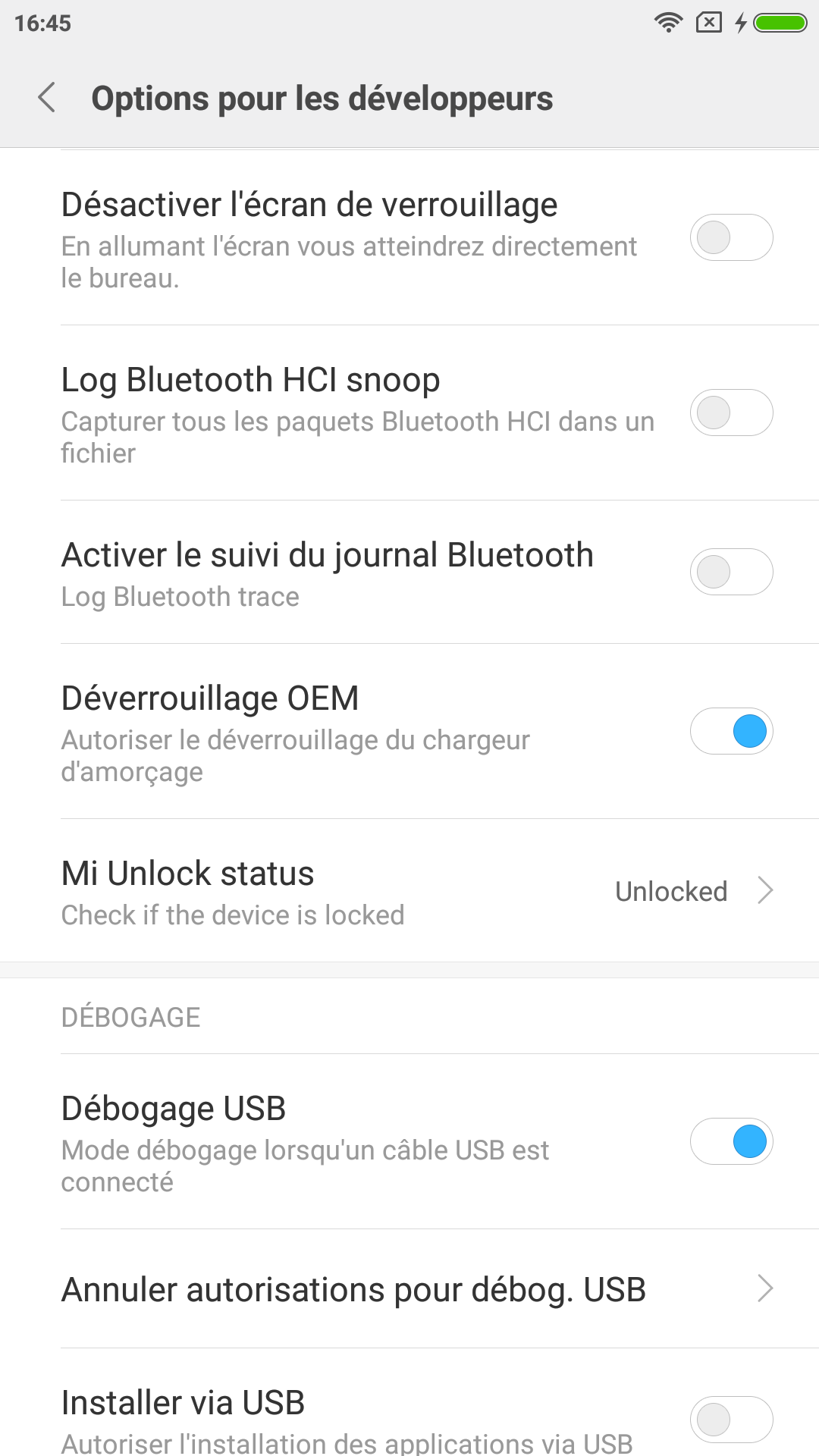

indeed, an in addition it worked for me but only with global dev 6.10.13
can you post links on the exact TWRP versions you use ? Thanks.

I unlocked my "Kate" as well using the official method. Permission to unlock arrived within a few minutes after I applied for it.

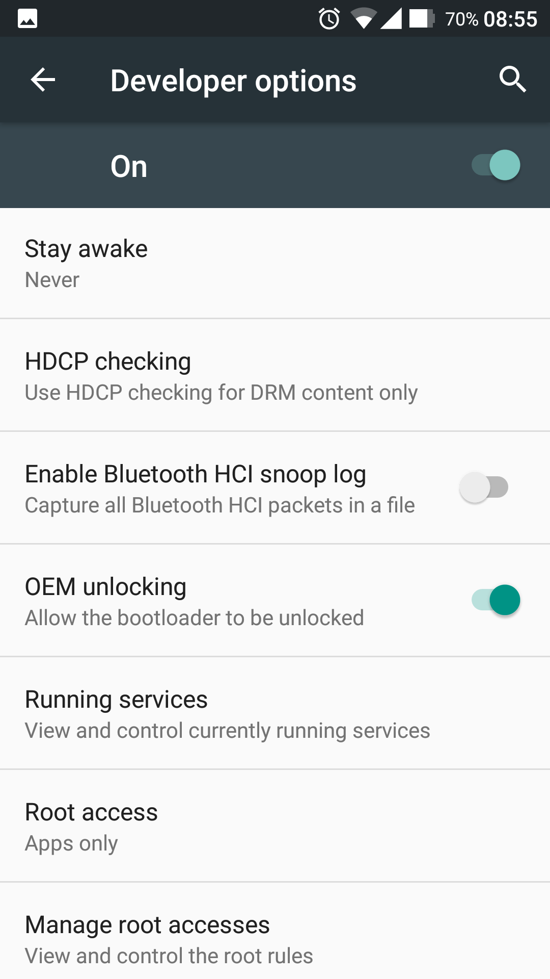

I was on Global Dev 6.10.13. Had to turn on "OEM Unlock" in developer settings. (I also turned on "USB Debugging")
I installed ZCX TWRP through fastboot with the included .bat file (includes SuperSu 2.76. Updated to 2.78 in Play Store).
(http://forum.xda-developers.com/redmi-note-3/how-to/zcx-twrp-install-twrp-flash-supersu-t3462448)
I also ran the Mi Unlocker as administrator on my PC.
