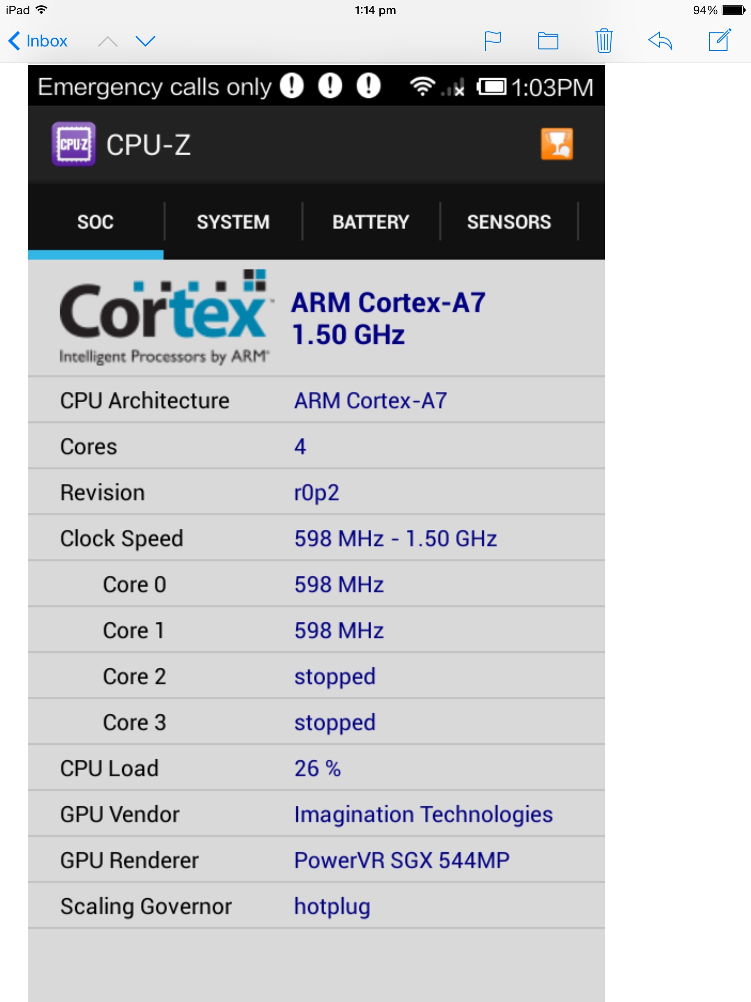

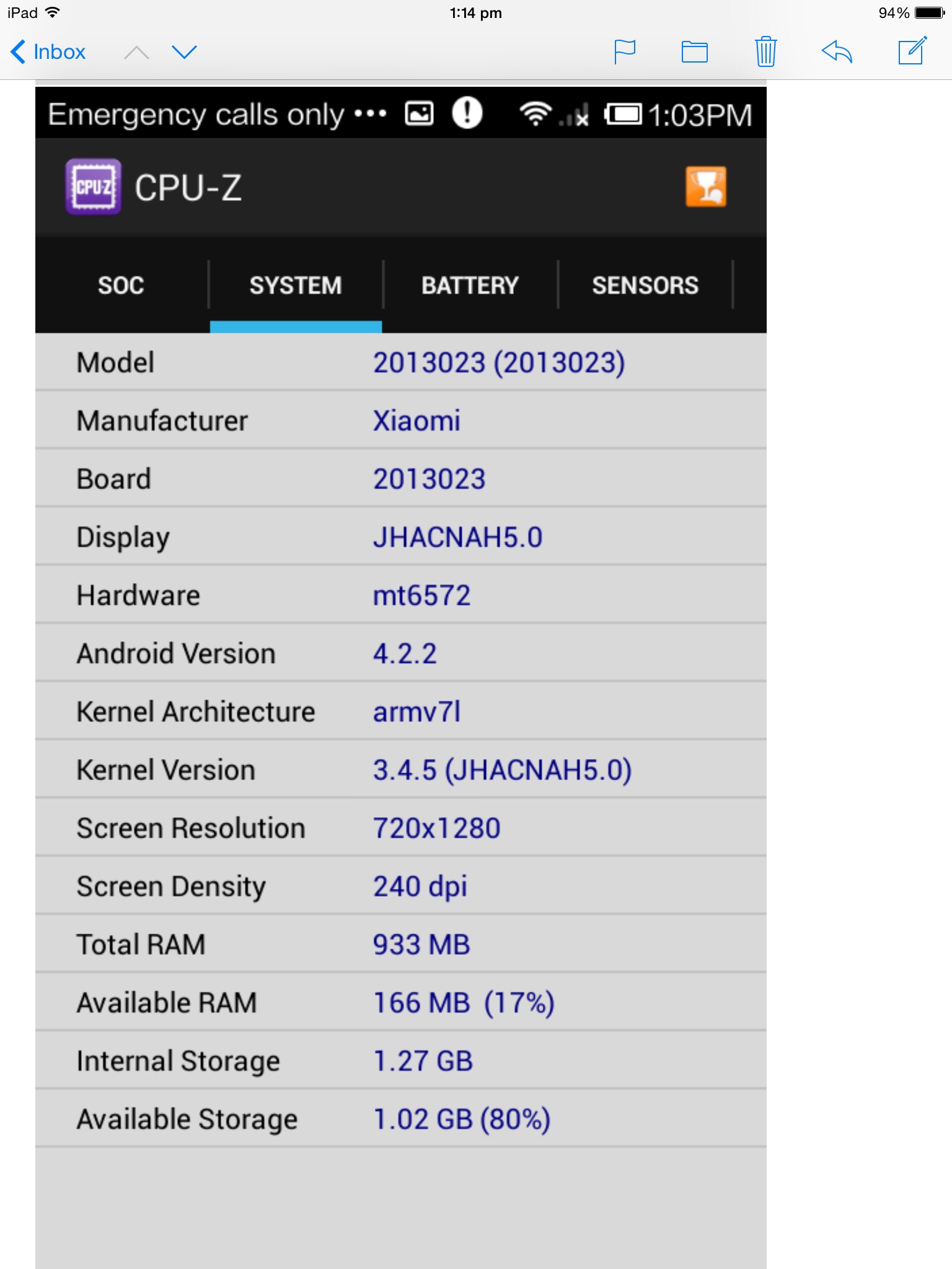

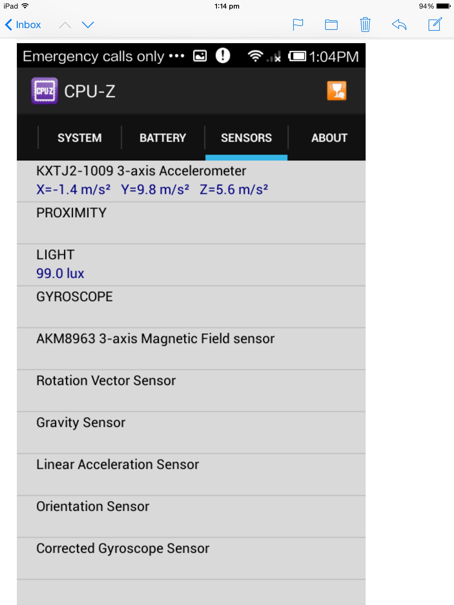

image.jpg image.jpg image.jpg hi guys just wanted to check whether mine is real, would appreciate your help! Thanks!
Isn't the dpi supposed to be 320, and the processor mt6589? Not so sure about this though, sorry!
to end this question, you should install a new stable rom, and than run the cpuz
How should I go about doing that? I've tried using the method on another post on this forum but it wouldn't install.

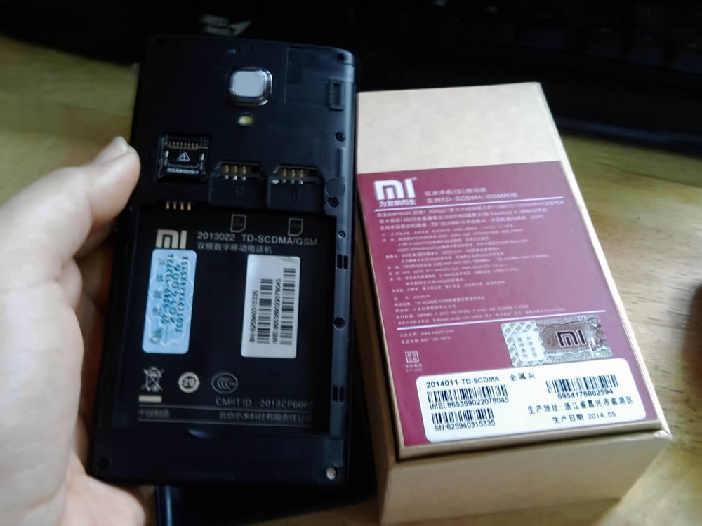

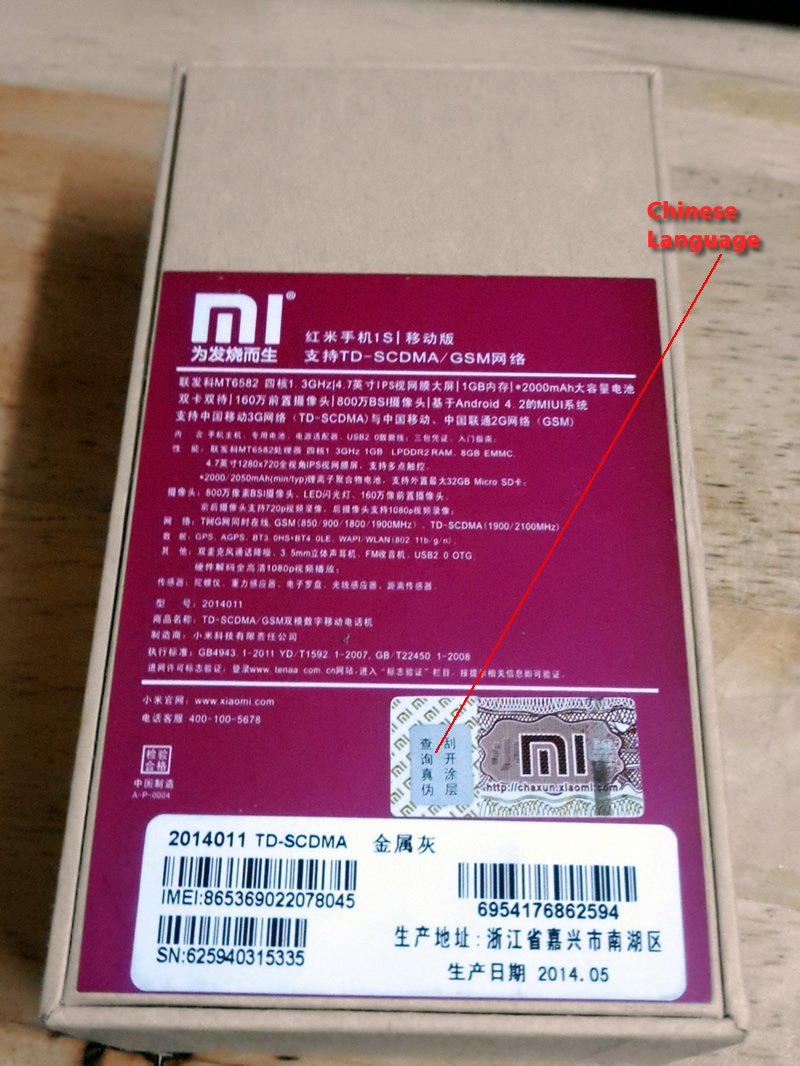

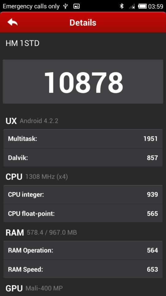

I confirm with the seller before that I want Original Xiaomi Hongmi 1S Qualcomm MSM8228 with WCDMA version. The phone that I received is wrong version.It's TD-SCDMA version and cannot spport 3G in my country. I ask to return and get full refund from the seller but they still shirk me and still confirm that the phone that they sent to me is original and it's right version by show me the invoice that they bought from Xiaomi.com and impute me take another phone to show them and said the phone is their phone that sent to me. How can I do with this seller? How can I check that the invoice that the seller show me is real or not.

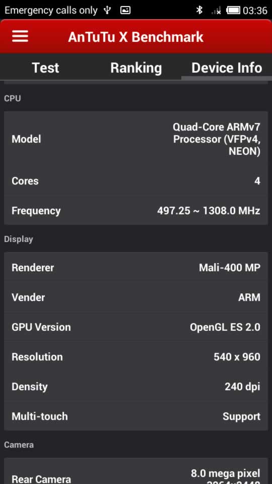

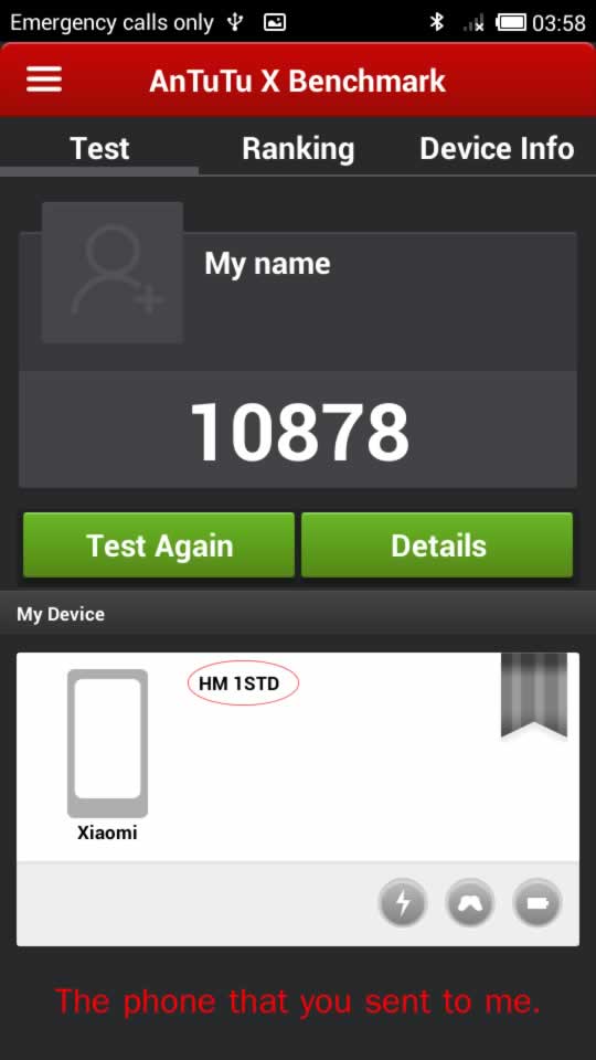

However, one thing that is real, the phone that I received, isn't same as description surely. The CPU is MTK 6582 1.3 GHz. This spec is made for china use only if it's original, isn't it? Please can help me prove about this.

All original Hongmis use MT6589 @ 1.5ghz, AFAIK. It's fake. What's the GPU? I'm betting it'll be Mali 400. Original should be PowerVR SGX 544. Check the screen resolution, too. Probably less than 1280x720.
Also, TD-SCDMA is China-only, for the most part.
Fake. Screen resolution and renderer are wrong.
Christ, the fake I got scored way better than that.
