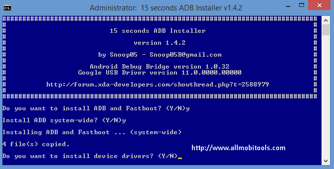

Download ADB Sideload Tool.
restart mobile mode recovery menu sideload.
copy folder platform-tools at root c:
cmd mode admistrator
C:\WINDOWS\system32>cd\
C:\>cd platform-tools
C:\platform-tools\adb sideload 1.zip ( rename file rom 12.5.2.0.RJWMIXM.zip to 1.zip)
yes lost all data.
