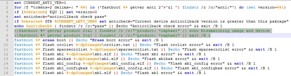

I desperately need a mod to solve the opposite issue... Since installing Xiaomi.EU my phone device name has changed to Raphael and no matter what I do I can't go back to the Raphaelin default software I used before, even hard flashing from Fastboot using the Xiaomi restore tool (I know what I'm doing I'm not a total useless noob)... I've tried every TWRP and every possible Fastboot command, nothing seems to stick it's driving me insane, although I can install Xiaomi.EU weekly betas to at least have a functioning phone.
Is it possible? Basically I'm somehow, goodness knows how on 9T Pro when I should be Raphaelin (Redmi K20 Pro India Variant)
Codered
Mar 14, 2014
30
Exactly what do you want to do? You want to flash stock raphaelin firmware? if so, you can download raphaelin fatsboot rom, extract it, you can edit marked with two lines in flash_all.bat.
