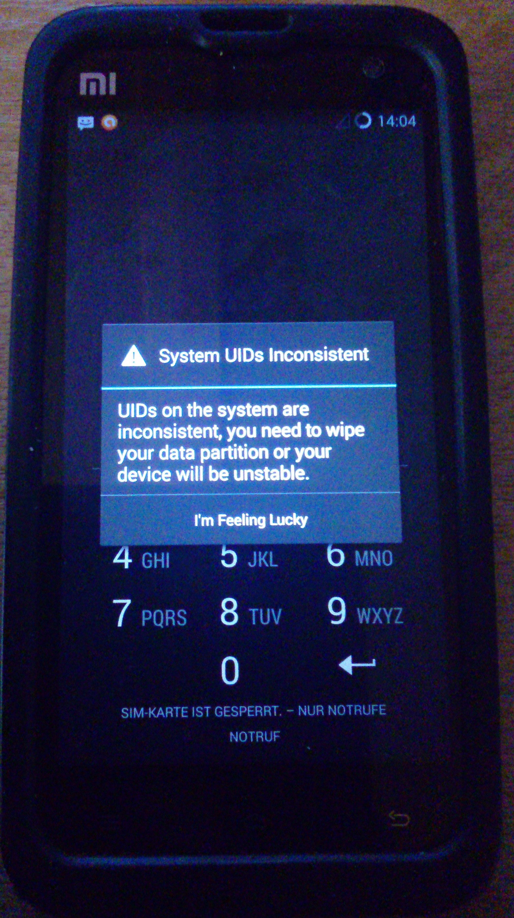

// Edit:
Something strange happened: i did a full backup (system 1 + 2) and then rebooted back to cm11, now i'm getting this error message. My Miui installation on system 1 isn't booting anymore, too! :(
Restoring the freshly made backup causes cm11 to bootloop, too!
I was using the fix partition script and installed everything as i had it before, rebooted some times etc. and then did the backup which broke everything..
