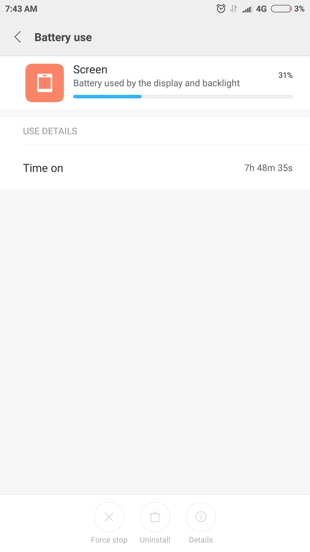

Hello to everyone.
I am a little noob in all this and I want to ask you some help.
I own a xiaomi redmi note 4 which came with 8.0.5.0.0 which i think it was a fake rom.
I installed via fastboot the rom 8.1.2.0 official stable from miui.com
After that I request to unlock the bootlader. I made the unlock. After that I installed the twrp from cofface 3.0.2 after I had some problems : lost recovery part (no miui recovery) but finally I fixed.
After twrp install I flashed the update for fix the battery issues , I flashed the sleep update and the auto-brightness update.
After all this work I made with my phone, I want to ask:
- if I receive OTA update and I install -> I will lose my unlcok bootloader and the twrp?
- if I want to install official stable rom, how can i proceed to keep the twrp and the unlock bootloader?
- which rom should I use if I want to keep twrp ?
I use my phone only to talk and browsing internet. I play game very rarely : clash of clans. I keep all the time the wifi/data opened and bluetooth conected to watch/car. I am looking to have the best battery possible. What you can recommend me?
Now with 8.1.2.0 I experince 13h with 1h SOT, 22 min talk and 78% battery left. Pretty wellI said but with the 8.1.2.0 and the patch for fix better rom my phone has a little laggy than before.
Thank You and sorry for my poor english.

Now with 8.1.6.0the battery drain very fast. I also flashed the zips which fixed that issue....I think I will re-flash the stable 8.1.2.0 stable....
