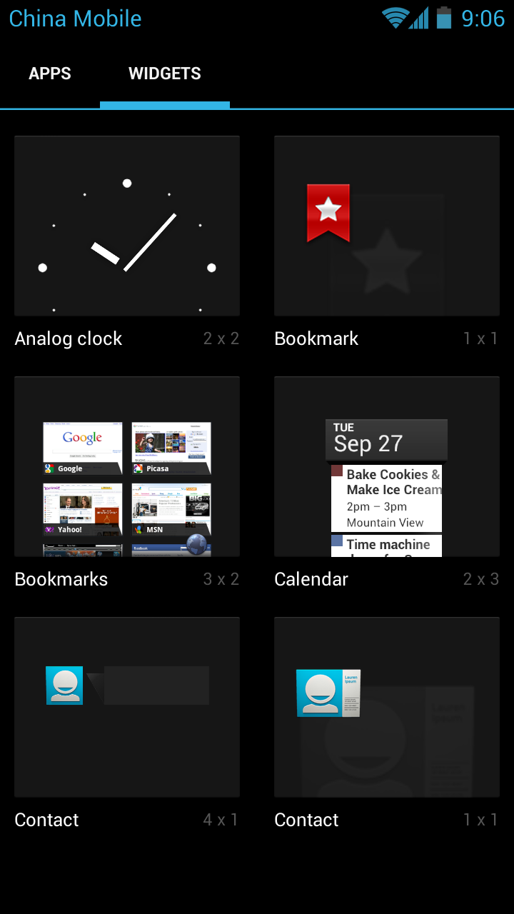

Xiaomi ROMs are great but i saw some post asking for the stock android on xiaomi M2.
M 2 have the official stock Jellybean 4.1.1 ROM form xiaomi if you preffer.
For Complete list of MI2 ROMs please check this threadhttp://en.miui.com/thread-1885-1-1.html

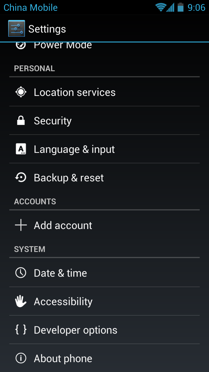

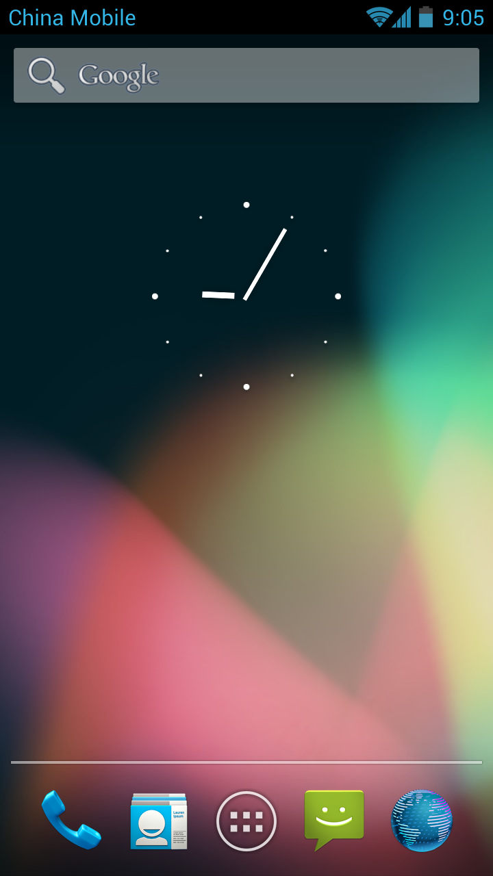

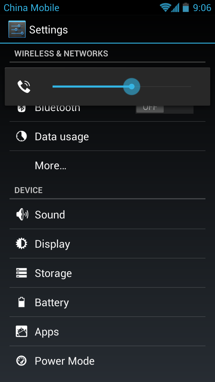

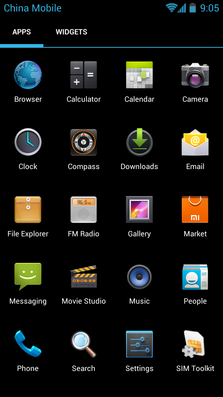

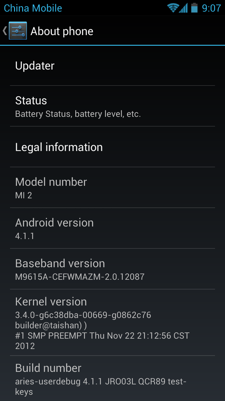

Screenshot_2012-12-09-21-05-48[1].pngScreenshot_2012-12-09-21-05-59[1].pngScreenshot_2012-12-09-21-06-08[1].pngScreenshot_2012-12-09-21-06-33[1].pngScreenshot_2012-12-09-21-06-55[1].pngScreenshot_2012-12-09-21-07-34[1].png
As its stock so no need for corrections in English . This ROM have only English and Chinese language. It starts in chinese but you can select the english from settings. I found two builds, here are links to the latest build which was built on Nov 22, 2012. its a zip file, install it as usual but you have to wipe all of your user data :( (except internal partition (sdcard)). Here is the link to the zip file.

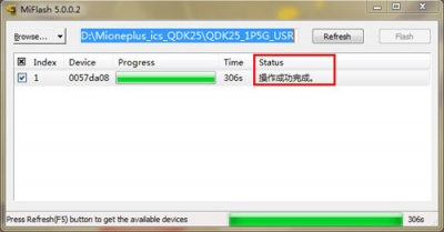

Backup all your data from phone!!!! Because flashing ROM via MiFlash erase all the partitions & data. No need to do any wipes whith this method.
To enter fastboot mode U must keeping pressing "vol -" press power button - the rabbit repairing android on screen must appear
old Miflash (but easy to use) U can download here for example....
1 Download fastboot version of needed ROM (JLB 5.0 or 2.12.7....) Unpack it into the new folder on your PC
2 Enter MiFlash & plug in MITU in fastboot mode to your PC
3 in MiFlash whith "Browse" button, U must choose the directory where U unpack your fastboot ROM
4 press "Refresh" button.
5 Press "Flash" button to flash ROM
ROM flashs in both systems!!!

Thanks, this clears a lot of things up. But since this is a stock Jelly Bean firmware.. it would be advisable to use the MiFlash method to have both partitions using the same firmware right? Because following your tutorial, I can't have English MIUI in partition 1, and flash a stock Jelly Bean firmware into partition 2 (data not aligned)?
Yes if you have the mi flash and stock JLB in .exe format.

So if I use MiFlash, I can't flash this stock Jelly Bean because it's in a zip file? But the official downloads on miui.com are also zip files.. where do I find these exe files from?
thanks a lot for the links , now i've got bot the android and the JLB miui .exe but unfortunally it seem i cannot download the MIFlash from the link in the post above , can anyone give a different link thanks
and also , i'm on windows8 , do i need to install drivers ? if yes , where can i find it ?
