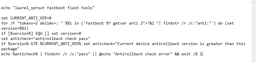

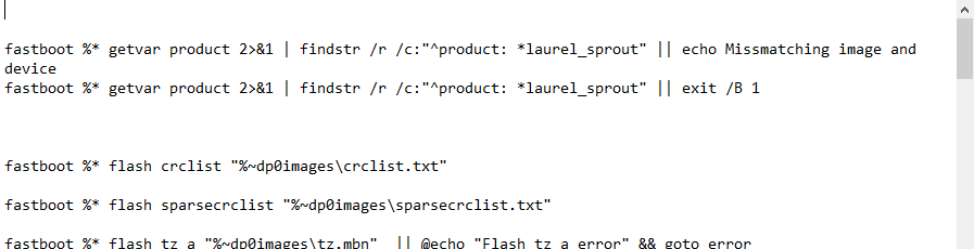

By following what you said and deleting this part:
30724
and leaving as is the rest from this point:
30725
this is the final result I've got:
30723
This thread was very helpful. I have edited the script, to set back my Mi Note 10 to Android 9/ MiUI 11 and lock it. I´ve changed a little the way to do this, because i´ve renamed the "flash all.sh", which produces the error notices at the end, in "flash all.txt" and copied the folder with the unzipped image to C:/ (root). I´ve marked "clean all and lock" and flashed with the notice "success" at the end. Before i read your thread always the "failed" message was shown before flashing anything, with the information, that anti rollback was active. Without this thread i have had no chance for warranty service, so thanks for the informations.
Hy,
Sure. The way you mention it, it seems to be simple. It wasn't for me because I tried that a lot of times. Every fastboot ROM that needs to be flashed via Mi Flash has those installation scripts coming with it. Those script perform a anti rollback error check and that kept returning the error "Anti Rollback check error!" everytime I tried to flash the ROM on my device.
I have fixed this issue by editing those script, removing all rules on the top of the script that performed the anti rollback error and runned the flash again. It returned an error after the flash but my phone booted up finally and everything works fine now!
I hope my tread will help some other people to!
Kind regards,
Sander

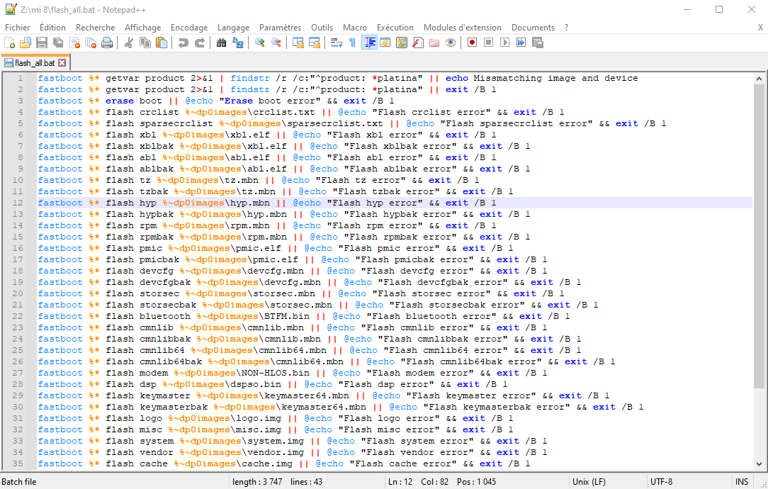

hello I have a mi 8 lite rom. And there is not line without fastboot but the problem is always there. the error is ''mismatching image and device'' Please help me sander97
Delete line 1 and 2.
But be sure the rom is for your device else you will hard brick
