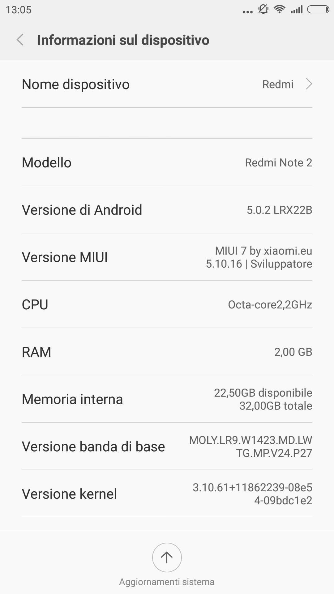

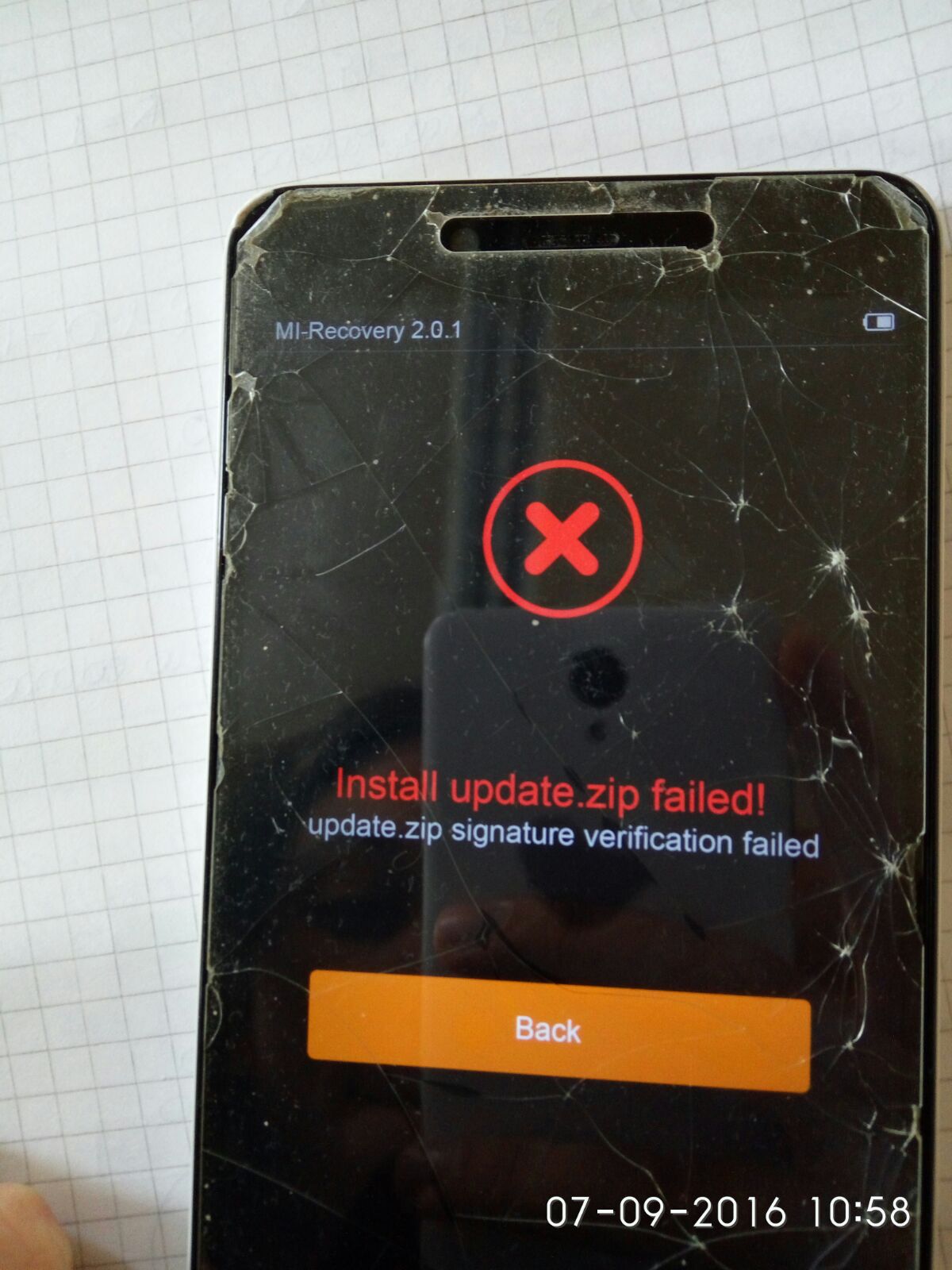

Good afternoon, yesterday a trojan malware attacted my Phone.. appears publicitary page and erotic page.. (also when i enter in whatsapps for example).. i saw that the problem Can be the ROM.. i tried to remove by factory reset but malware is now locked but not removed.. i tried to change rom but it show that it is impossibile.. the installation of new rom is locked by trojan malware.. i'm not an informatic expert and i don't know how Can i solve this problem..

Just tried that Vareth , I get the error message "install update failed, update.zip is corrupted"
What update.zip? Its not in bootloader, but is system settings update. Bootloader is only to wipe data from phone for my way.
Do not rename it, upload to the device and go to Update App in android.
In the top right corner is menu and there is second option "Install update from .zip file" or like that.
Then select downloaded file from en.miui.com called miui_HMNote2Global_V8.0.1.0.LHMMIDG_e88d21e2a2_5.0.zip, and now system reboot, and starts install new rom.

Thanks for your patience Vareth, I downloaded the developer version and that worked fine it just didn't like the stable version, so all fixed and learnt something today.
