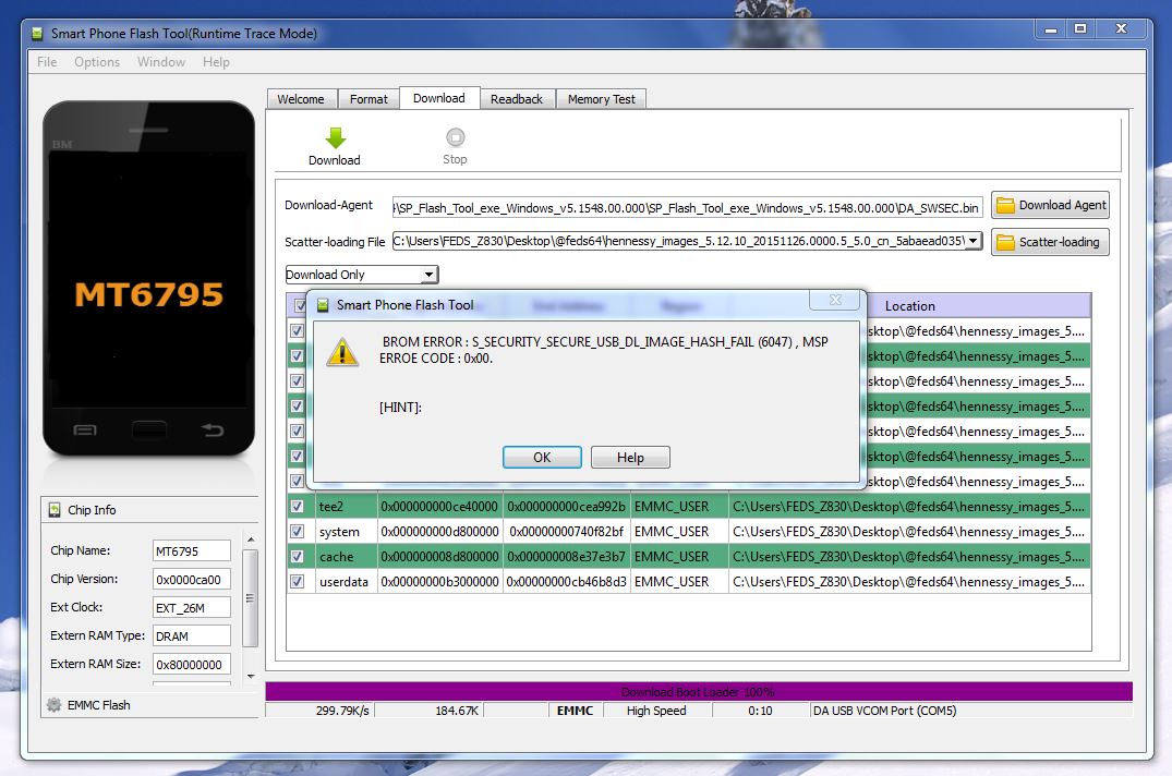

After plugging, managed to get red then purple line, and this error came out. What is happening here?

In the pic, can see that scatter file is for 5.12.10 (Developer China ROM).
And you saying 7.1.1.1
Also, 7.1.1.1 to 7.0.16.0 is intact downgrade as number seems.
Please clarify. Is 7.1.1.1 is the latest update? Where can get it
Sorry, uploaded the wrong pic, was trying both Dev and stable rom with various SP flash tools, so got mixed up...

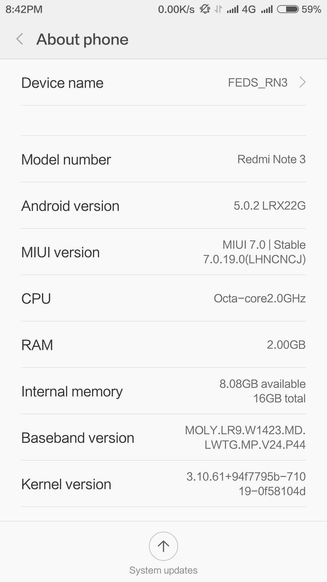

Solved my problems and went on to update from 7.0.16.0.LHNCNCJ to V7.0.19.0.LHNCNCJ using the updater...

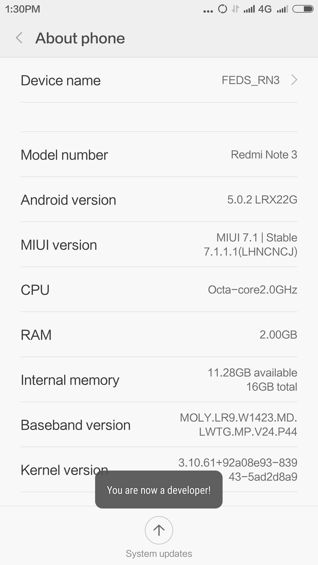

Note: As you can see it is MIUI 7.1 / 7.1.1.1 is pre-loaded by the vendors in China... which comes with Google Play Store...

My phone was preloaded 7.0.9.0 and I believe all other people also got same.
7.1.1.1 is believed to be the newer then 7.0.9.0 or even 7.0.19.0

I am gonna write a tutorial about flashing the ROM too, what I have done before this was flashing my Redmi Note 3 3GB/32GB which later had a problem with the fingerprint sensor which I threw back to the vendor. What I learned here was just that the flashing SP_Flash_Tool_exe_Windows_v5.1520.00.000 was the right for me, eventhough I had downloaded another v5.1520 from another source which was not working giving me the error I posted earlier. Dont bother ask me, cos I am puzzled too. I just there something different in that pacticular version.

Thats what I got after my replacement from my first unit, it is a not an Official Rom from MIUI, lets just say they just make life difficult to update it... cos all the available roms are older as per version number...
Hm.... And u r having 2gb version ? Maybe for that have 7.1
I didn't see anywhere online.. 7.1
Yes they replaced and refunded accordingly, cos I asked to downgrade the phone, so if there should be any mishap it would be a minimal one...
