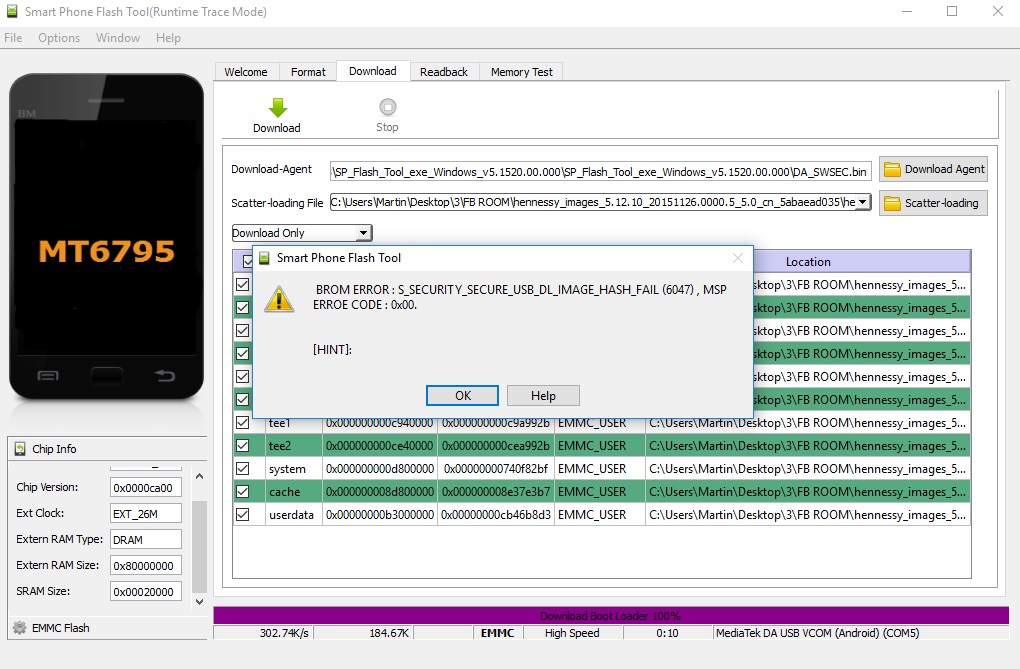

please help!!
i got this error : "
S_SECURITY_SECURE_USB_DL_IMAGE_HASH_FAIL"
what to do !?

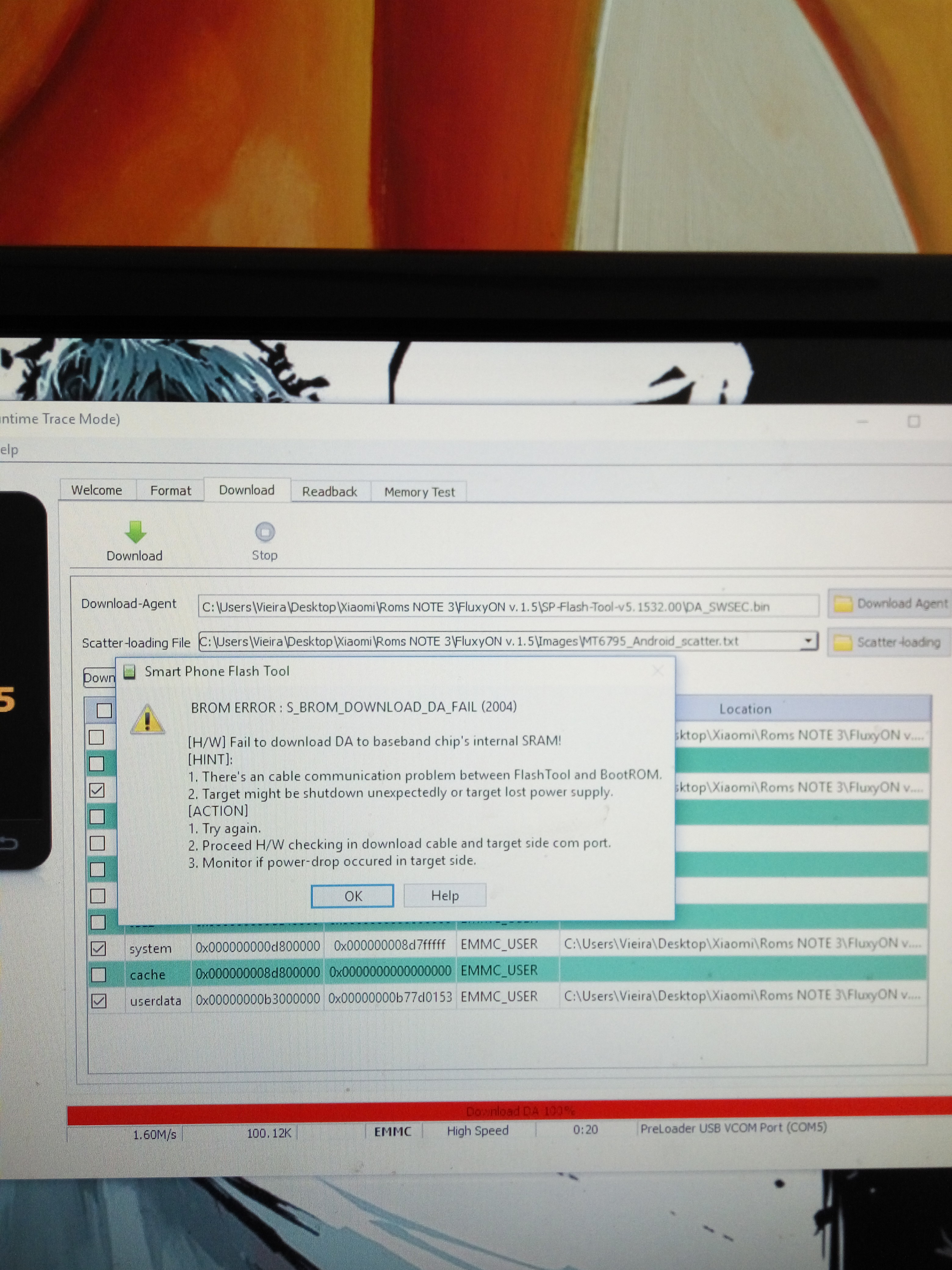

I have the rom - SphinXv2b Stable_Redmi_Note3_MIUI7.1 - V7.1.3.0_Global_ManhIT . since then i can not I install another .... the updater is where you choose the update package that says k can not verify the update , either flash of me always a error brom 2004.. ...need help ...
Thank you

perhaps to look at the XDA developers. I found there SphinX v2b Stable_Redmi_Note3 MIUI V7.1 - V7.1.3.0 Global_ManhIT and is quite well written. Maybe you should ask someone there on the forums or the author of the ROM
