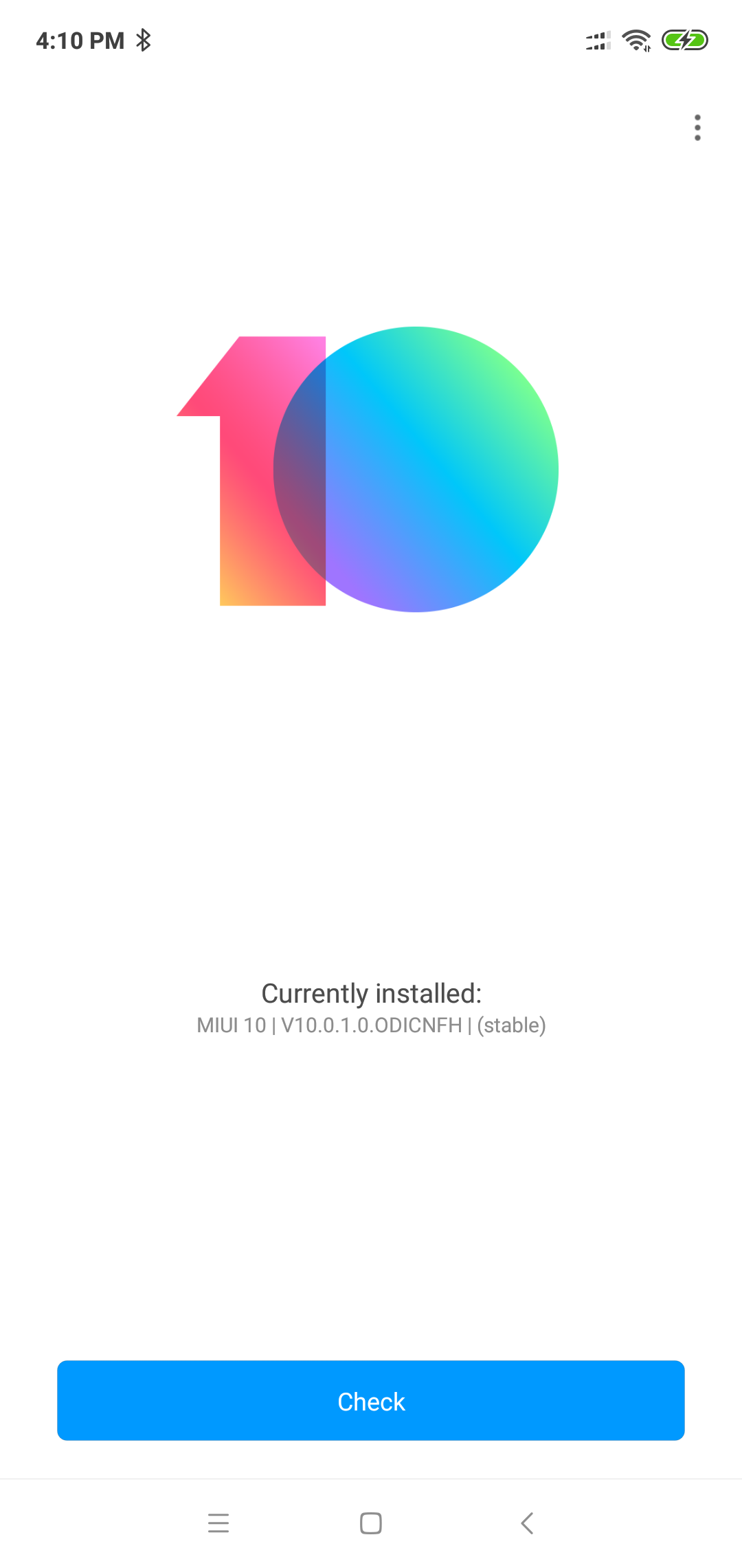

Finally, I got it work and installed MIUI 10 STABLE RELEASE
1 - I run commands:
fastboot boot twrp.img
- but it asks for password
- I cancel and wipe data
- I install ROM (installation ends with errors)
- I restart
- phone boots in fastboot screen
2- I run commands again:
-now twrp dose not asks for password
-I install twrp.img
-I install ROM
- Restart
Every thing works ok :)
