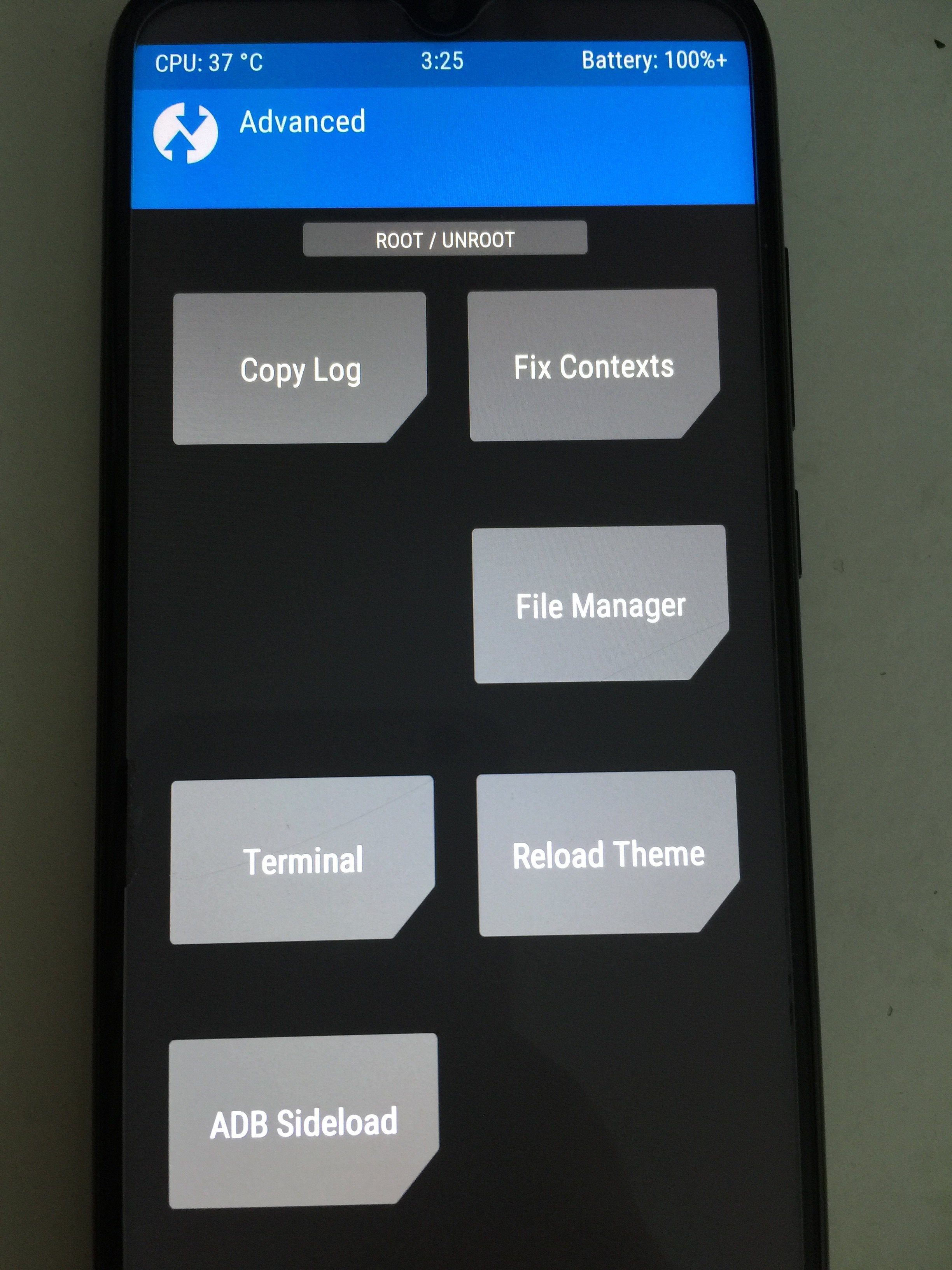

Hi, sorry, have to preface that I’m a total noob at this.
I got to step 3 of the installation, but I have no idea where NO-VERITY-OPT-ENCRYPT is located and how to install it. There’s no option for it in the Advanced menu and I can’t find it easily in the File Manager.
Help!

touch ROOT / UNROOT (top center)
