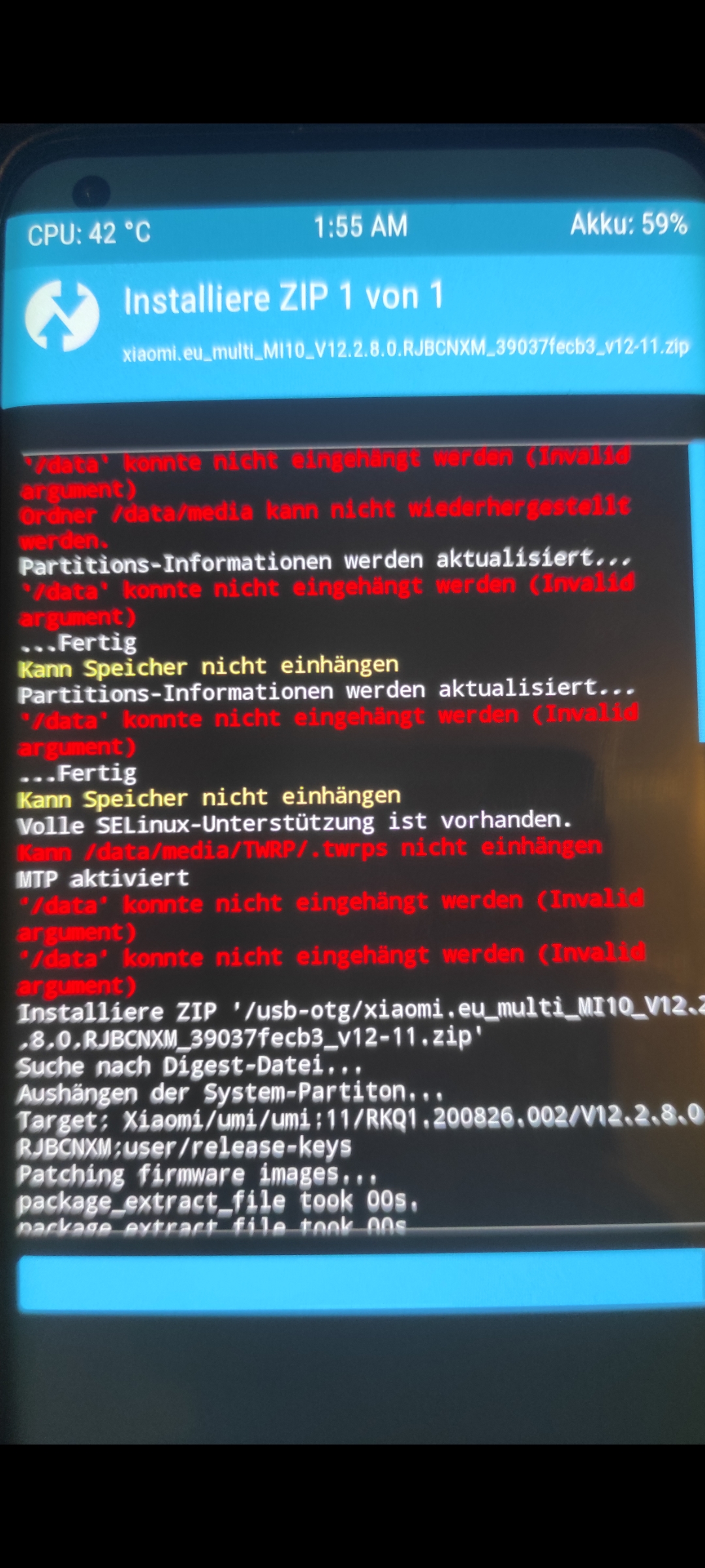

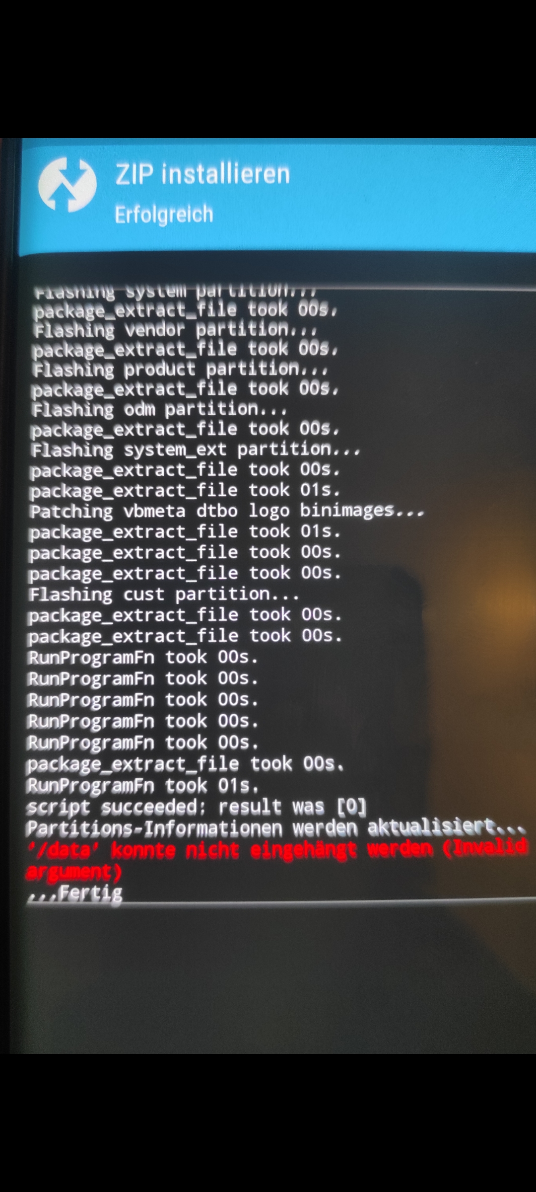

If I make a OTA update from my mi10 and xiaomi.eu rom the phone reboots in twrp. But I can't use the internal storage to select the zip file. Only installing from usb is possible. The internal storage is 0mb and twrp doesn't ask for Android pin code to unlock. Why is the internal storage not mounted and how can I solve the problem without full reset the phone?
Screenshots at the bottom, but sorry in English
The installation from usb is still successful
