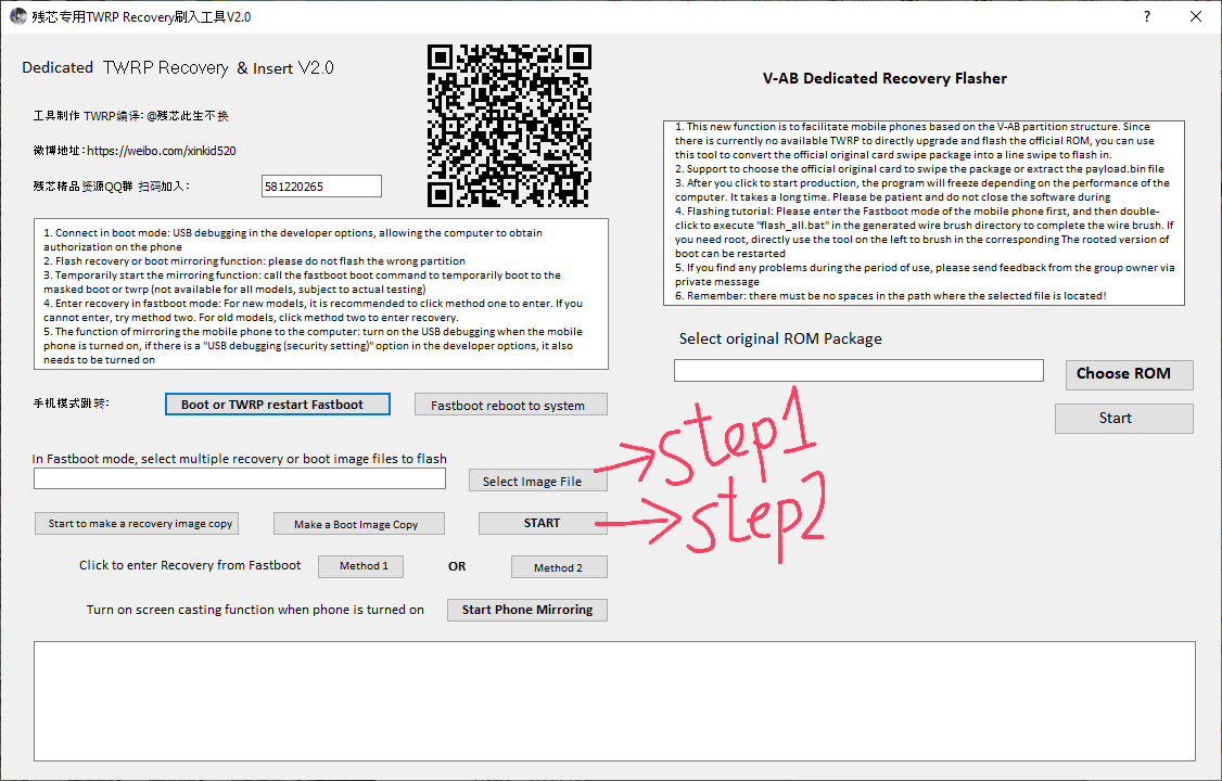

TWRP Recovery Installation:
You should turn off Antivirus software
Download files at
here
1. Before starting the process, the bootloader must be unlocked (bootloader unlock)
2. Install the Xiaomi USB drivers
3. Settings - Additional settings - Enable Usb debugging from the developer options.
4. Download the attached files.
5. Extract it from zip and copy it to C: directory (zip password: vutruonghainam)
6. Double click the file "残 芯 专用 TWRPRecovery 刷 入 工具 Win 版 V2.0 " in 1 file.
7. Select file TWRP you moved to C like step 1 in picture below.
8. Turn off your phone and put it into fastboot mode by holding down the volume down and power keys.
9. Connect your phone in fastboot mode to your computer.
10. Click on the flash button marked like step 2 in picture below.
11. Your phone will boot up in TWRP.
P/s: This TWRP is a one-time install. So after you have exiting TWRP, it will return to the original recovery. To make TWRP permanent, change the language to English from the language selection, you can use the TWRP / Advanced / Onekey Inject TWRP option.

Just to confirm that this works fine. Once booted in to TWRP, select third option down on the right and then the little world sysmbol on top row and then English and the return button on the right lower down. Using the TWRP / Advanced / Onekey Inject TWRP option, both A and B slots are set and you can reboot system. Just to ensure it worked, I rebooted back in to recovery and it was all fine. And yes, I did not disable my anti virus.
No problem at all with this TWRP. This is the new method to sideload TWRP to new phone because of few Android 11 restriction. Cheers
I have attached a very rough translated PNG copy of the program to assist in flashing. As I said, it worked fine using instructions from above and no hidden apps installed or viruses found in the app or after installation.
