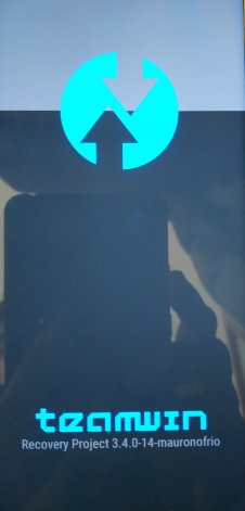

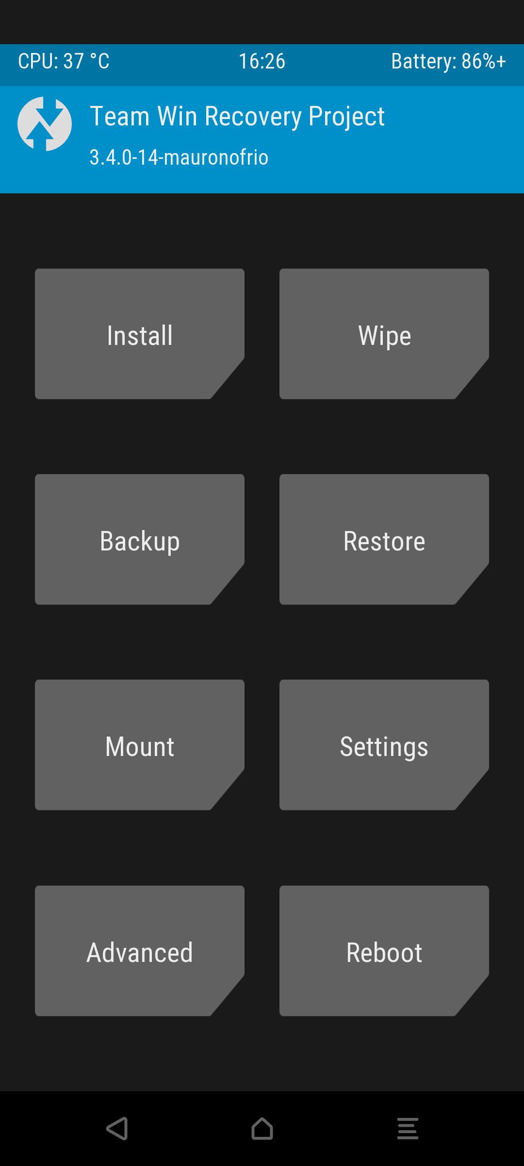

Edit November 12, 2020:
TWRP 3.4.0-14 by mauronofrio (developer working with official TeamWin Recovery Project)
-> multilanguage
-> universal version usable for models Redmi Note 9S, Redmi Note 9 Pro, Redmi Note 9 Pro Max and Pocophone M2 Pro (Curtana, Joyeuse, Excalibur, Gram)
View attachment 32178View attachment 32462
Mauronofrio's TWRP download folder: https://sourceforge.net/projects/mauronofrio-twrp/files/Curtana-Joyeuse-Gram-Excalibur/
For Joyeuse download latest file for Curtana
It works well for me
How to install:
- Install from old TWRP -> Install / Install IMG / select IMG file TWRP / select Recovery partition / Swipe to confirm
- Restart to Recovery

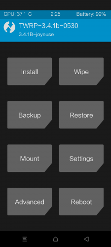

Edit October 23, 2020:
LR.TWRP 3.4.1B 0530 by russian
pages1 and pages2
-> made by modifying LR.TWRP for Redmi 9S
-> english /russain languages
-> multilanguage made from en/ru version by Cuvetto
View attachment 31338View attachment 32407
Edit:
Redmi Note 9 Pro uses two type of displays (Huaxing, Tianma), on Tianma display the "Swipe to unlock" button does not work after the display goes out. The solution is to turn off the "Enable screen timeout" option in TWRP Settings.
