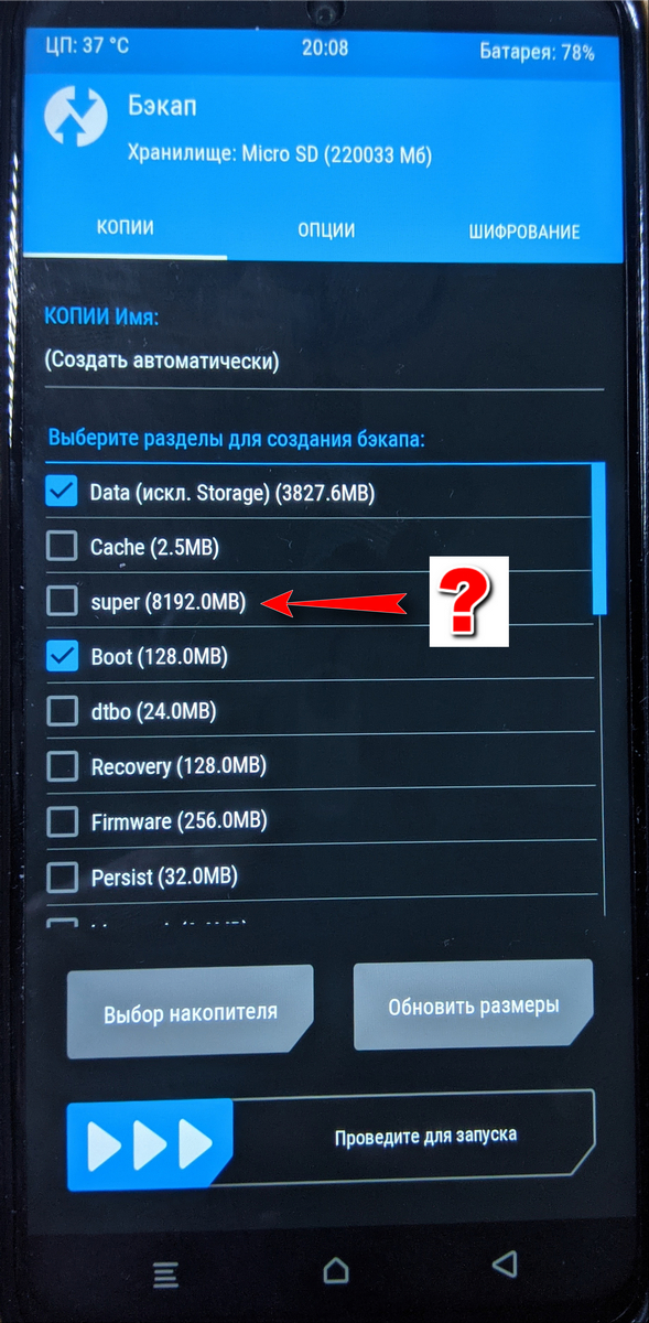

What does a backup item named as super include?
This is TWRP-3.4.1B-0530-joyeuse-fix.zip (From instructions in the 1st post)
Super is a new partition introduced in Android 10. It enables Dynamic Partitons. The ROM specifies which partitions live within super (dynamic_partitions_op_list). For this ROM it's System/Product/Vendor.
This is also the cause of failure when trying to modify the /system partition. The correct method now is to use adb remount which creates a overlay fillesystem. I've not actually tried this though.
Reactions: EU_User
Hence, Super does not include Data.
