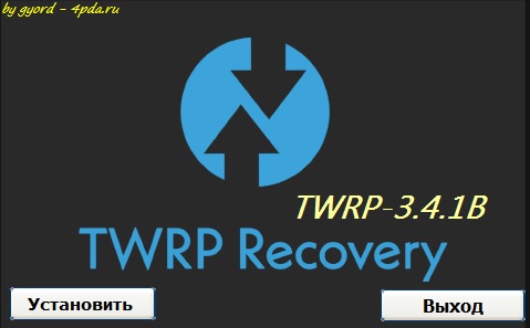

b) by automatic installer, using an EXE program in Windows
Download autoinstall EXE: https://uloz.to/file/qidj7XRHX6wm/joyeuse-twrp3-4-1b-autoinstall-exe
Instructions for install Twrp with automatic installer:
-Back up all your data (photos, videos, files, etc.), the whole phone will be deleted
-The phone must have the Bootloader unlocked
-You need to have drivers installed (you probably already have them when you unlocked Recovery - they are packed in a ZIP)
-Restart the phone to Fastboot mode (turn on the phone by holding down Vol- and Power), this picture will appear on the phone
-Run the file "joyeuse_TWRP3.4.1B_autoinstall.exe" on your PC
-Now connect the phone to the PC and click on "Установить"
-Installation will take place, a black text window will open where you have to press Enter several times
-Close the program window on the PC by clicking on "Bыход "
-After installation, hold down the Power button to turn off the phone from Fastboot mode
-After turning on, phone will boot into TWRP, if not jump to TWRP by pressing at the same time Power and Volume+ buttons
-When the TWRP starts up for the first time, you need to immediately click on the language setting button and select English
-Then setup your TWRP, time zone, etc.

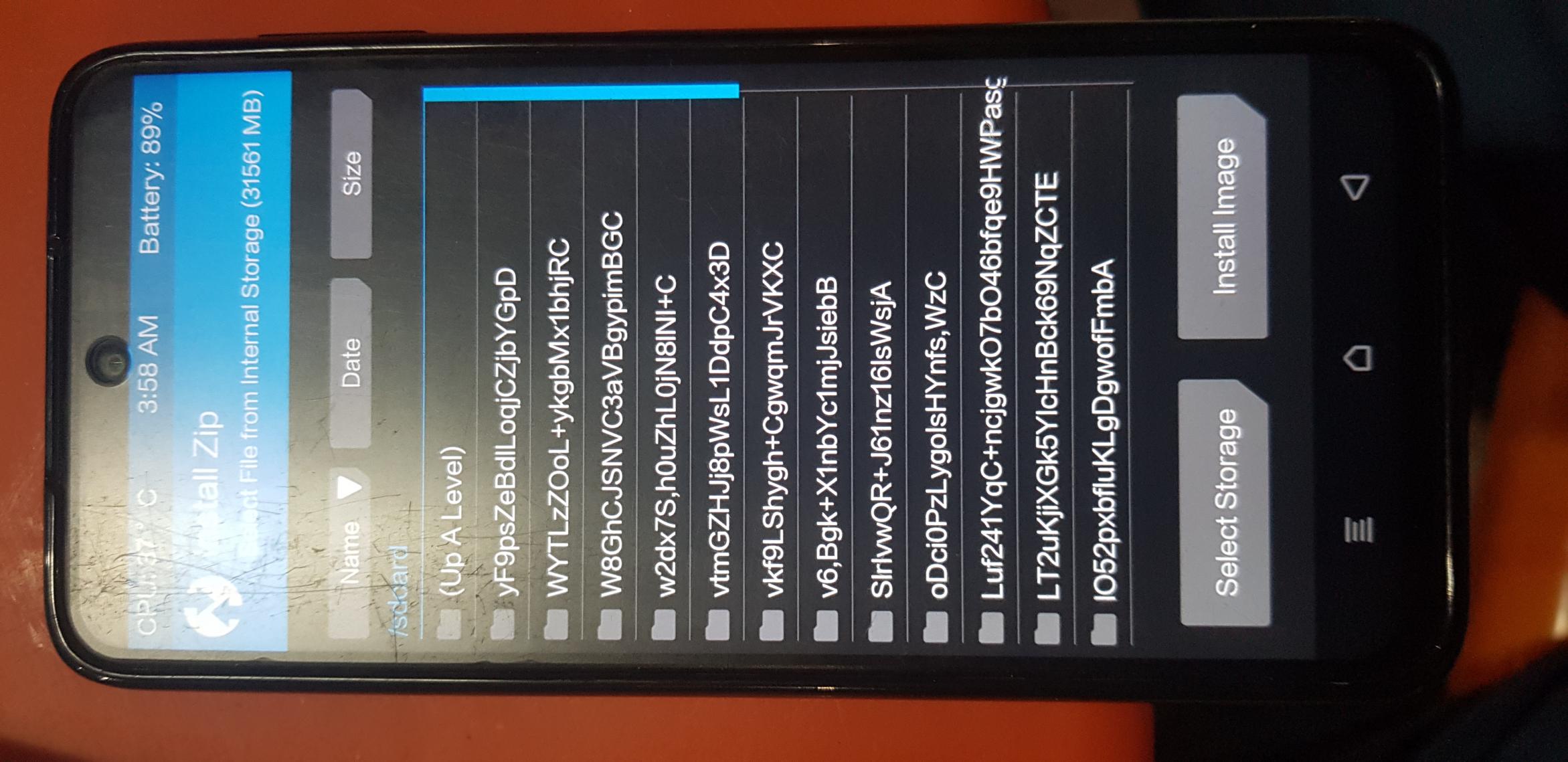

hi every one can any one tell me how can deal with this twrp
attached with post

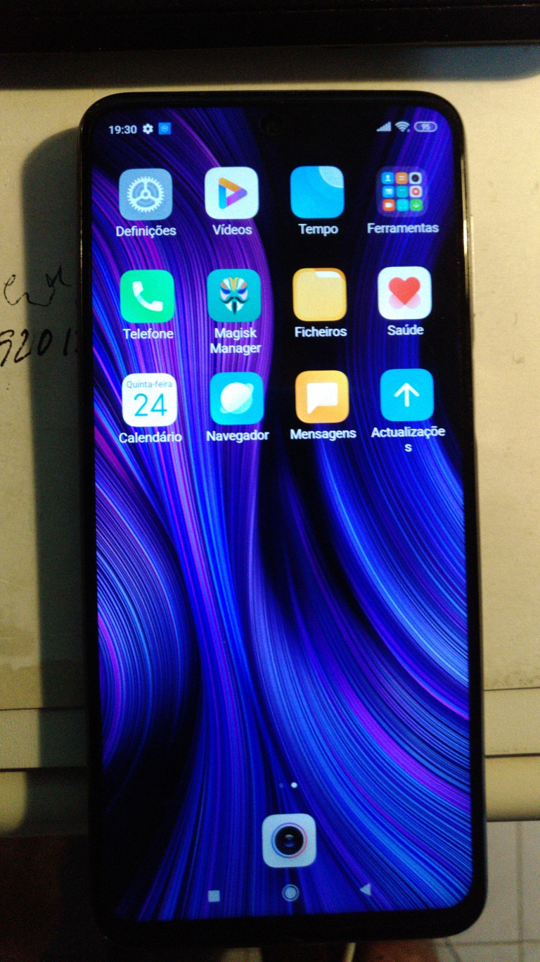

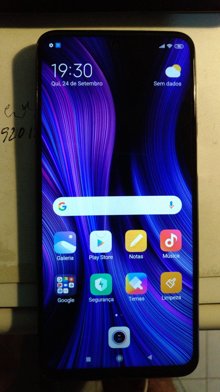

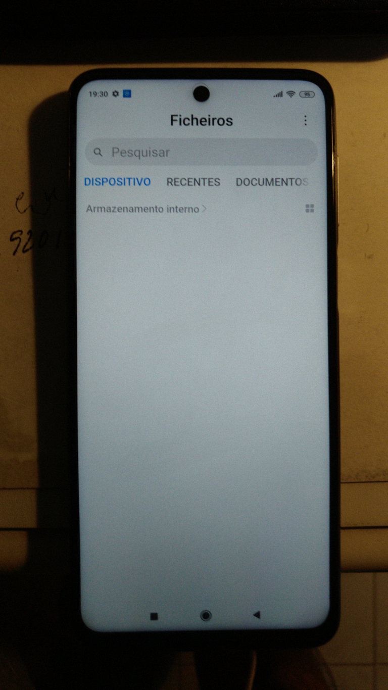

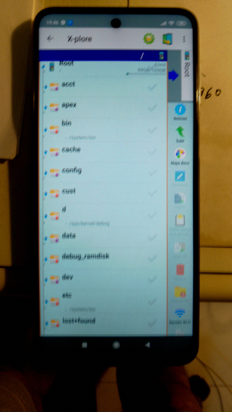

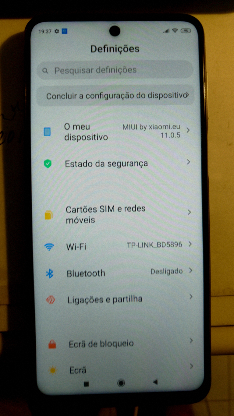

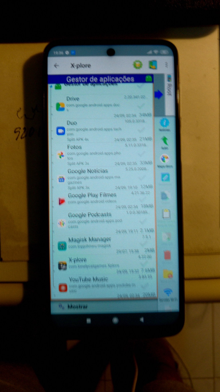

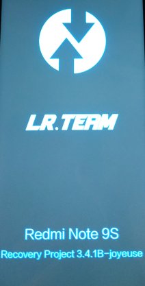

Hello
I have followed the instructions given to the letter, installed the TWRP with the executable file, rebooted in recovery, formatted the data partition, installed the recovery Rom and then Magisk cleaned the Dalvik cache and Cache partitions and restarted the system.
After a few minutes the system started and I did the system setup, after ready only the applications and data retrieved from Google are on the phone the internal storage is zero and I can't install anything else if it isn't through the Play Store and when I am going to take a picture, an error message appears, "you cannot use the application until you insert the SD card".
What did I do wrong?
Can anyone enlighten me on this matter?
Thank you
