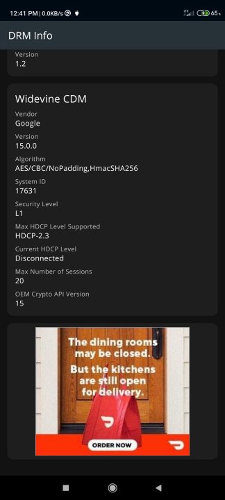

I am indeed on TWRP with 11.0.5 and widevine on L1 as I mentioned several times. And can be seen on the last 2 screens.
That's why I posted my steps here to help the guys keeping L1 BEFORE Going to L3.
There would be no reason to post another method which is a bit more complicated than flashing just 1 file if the outcome would be the same.
As I have written before somewhere there could be the possibility that while flashing the original Rom with miflash Tool and locking the bootloader again that widevine will go back to L1. That will indeed probably lead to another unlocking process of 7 days. Still there is no 100% guarantee on this. As im Sure no one tried it with the rn9pro before. As I am using Netflix and other streaming platforms regularely im happy I found out about L3 before flashing persist.img and could make out another way.
