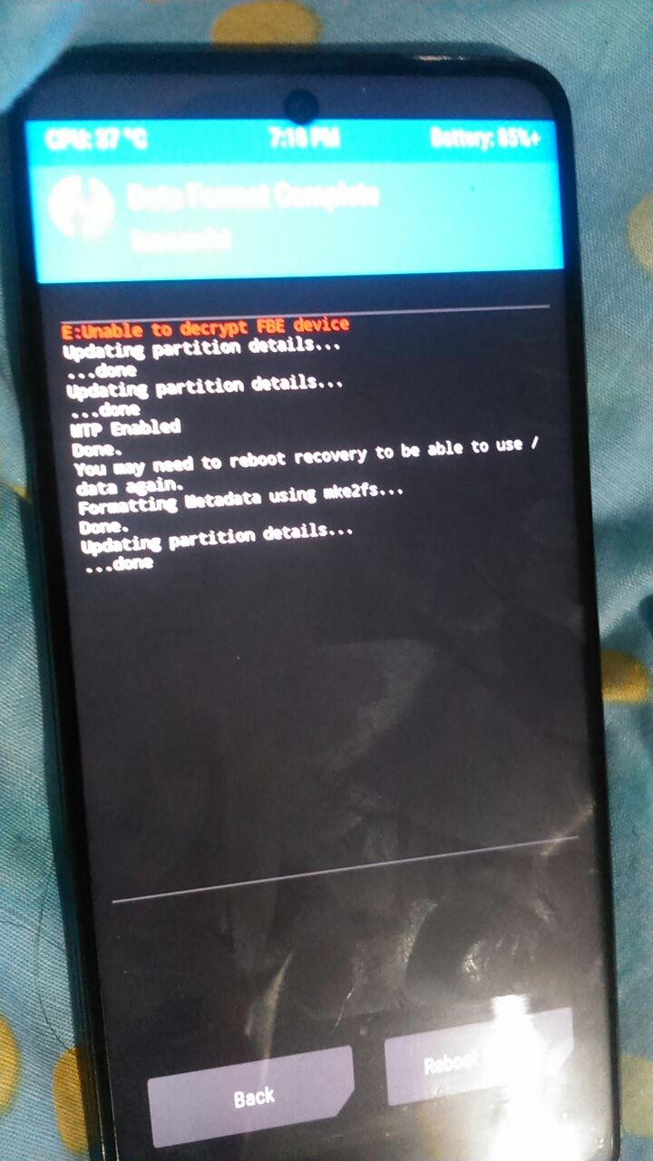

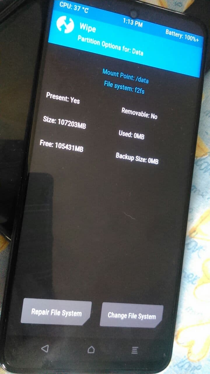

Hey guys, I´m having a problem for installing my favorite ROM in my Redmi Note 9 Pro (Joyeuse) . I´m using the latest firmware 12.0.2.0.QJZMIXM, I was using Android 10 Havoc 3.12 ROM, I decided to upgrade to Android 11 (ROM Havoc 4.1), so I checked this forum to upgrade my TWRP from 3.4.x to 3.5.x, So the first thing I did to clean flash was Format Data (and type "YES"), but now I have no access to the internal storage from my PC, I can see the device in my PC, even the data partition, but is not named "Internal Storage", and cannot see the storage capacity as before, when I try to copy flashable zip of the ROM, it is not possible to copy, I cannot copy any file, is like the Internal Storage is not working any more, the steps I followed were:
What I did was:
1) From TWRP 3.4.x, advance wipe cache, dalvik/chache and data, (not internal storage).
2) Upgrade to TWRP from v3.4.x to v3.5.x.
3) Reboot recovery to new TWRP 3.5.x
4) Wipe -> Format Data (typed "yes")
6) Reboot recovery.
7) Try to copy ROM.zip from my PC but Internal Storage is not working, i´m dragging he files to "data" but I´m having errors.
So I cannot copy or access internal storage, I though it might be because encryption, but I removed password/pin/pattern before format, also Format Data is supposed to remove encryption.
There´s something I noticed , in the log of TWRP before wiping data, there´s always an error message:
E: Unable to decrypt FBE device
What I did was flash MIUI again from Mi Flash Tool, everything works now, but I want my custom ROM, I tried all the process again, reboot fastboot, flash recovery, wipe Format Data, but this time using Orangefox recovery, but I´m having the same luck, after Format Data I cannot copy the ROM.zip or anythong from my PC to the device. Should I do something else? is it mandatory to Wipe -> Format Data -> to remove MIUI before install ROM.zip?
Any suggestions guys, in the mean time my phone is out of service :(

First, please use the new TWRP version I gave in my previous post here (post #396). ;)
E: Unable to decrypt FBE device means that your device is not encrypted. So it's normal to see this error after formatting the data partition. :)
And don't forget to reboot to Recovery after the "Format Data" process.
Thanks! my device is up and running again, finally Android 11. Just one problem, the Internal Storage was not working after Format Data, but I copied everything to the microSD card and installed from there. So in case another person is having the same problem, they might need a microSD card close.
