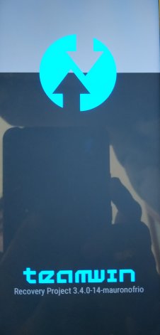

Edit eptember 3, 2020:
TWRP 3.4.0-14 by mauronofrio (developer working with official TeamWin Recovery Project)
-> multilanguage
![TWRP3.jpg TWRP3.jpg](https://xiaomi.eu/community/data/attachments/31/31671-6a159fa2871e8bdf3762b3edd75f1a23.jpg)
-> uni version usable for models Redmi Note 9S, Redmi Note 9 Pro, Redmi Note 9 Pro Max and Pocophone M2 Pro (Curtana, Joyeuse, Excalibur, Gram)
Mauronofrio's TWRP download folder: https://sourceforge.net/projects/mauronofrio-twrp/files/Curtana-Joyeuse-Gram-Excalibur/
For Curtana download latest file from 2020-09-28 "twrp-3.4.0-14-curtana-unified-mauronofrio.img"
It works well for me.
How to install:
- Install from old TWRP -> Install / Install IMG / select IMG file TWRP / select Recovery partition / Swipe to confirm
- Restart to Recovery

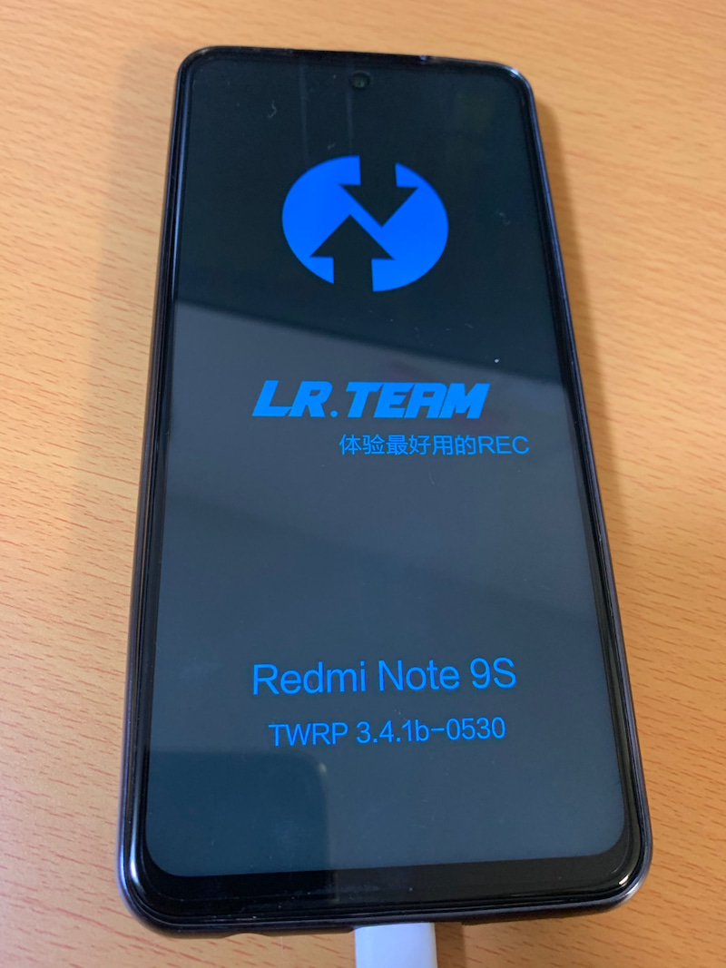

Edit August 8, 2020:
LR.TWRP 3.4.1B by russian 4PDA forum pages
-> english /russain languages
![TWRP.jpg TWRP.jpg](https://xiaomi.eu/community/data/attachments/30/30836-c56d3ef2fd1d7109226498a774894225.jpg)
Edit:
Redmi Note 9S uses two type of displays (Huaxing, Tianma), on Tianma display the "Swipe to unlock" button does not work well on version 0507. The solution is install version 0530.
Download:
version 0507
version 0530

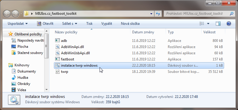

- Unzip the downloaded toolkit from the archive and insert the toolkit folder directly into the root of the system disk, add recovery to this folder, if recovery has a different name, rename it to twrp.img (if the downloaded recovery is also archived, unzip it to get twrp.img file)
The file name must be twrp.img !!!

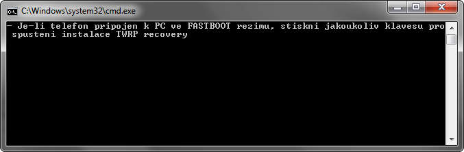

- Turn on the phone in FASTBOOT mode (start phone by holding together Power and Vvolume- keys) and connect it to the PC (in the Device Manager verify whether you have the appropriate driver for Fastboot mode - Android Bootloader
- Run it in the toolkit directory "instalace twrp windows"

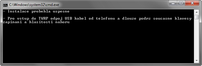

- Press any key (e.g. Enter) in the next black window
- Will appears this window:
- If it is written there "Instalace probehla uspesne", the installation was successful
- Now Disconnect the cable from the phone
- Launch the phone by simultaneously pressing and holding the Power and Volume + buttons
- Phone will start to new revovery
- done
