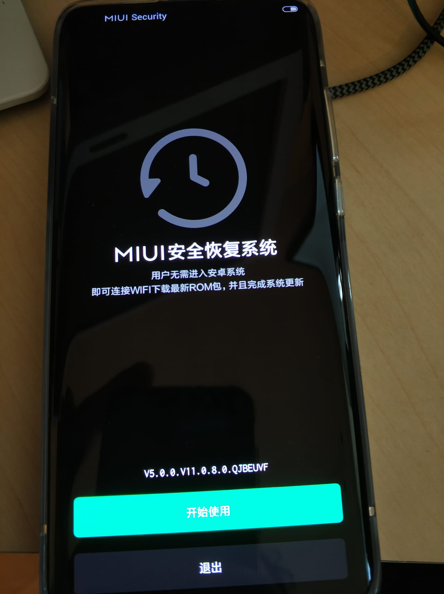

If I force to switch on in recovery (Vol Up + Power) it goes in what it seems to me the default recovery from when I cannot do anything (cf. attached pic.)

Yes. This is what it displays when I launch those commands. But instead of rebooting in TWRP it reboots in fastboot unless I do not force it.
Well, it seems to be installing the TWRP file, and then booting it, correctly.
I wonder if there is a corruption in one of the files, either in the installation on your computer, or in the TWRP file.
What was it that seemed to trigger the problems on the phone? New ROM? Flashing TWRP? or something else?
I believe that the problem has been triggered when my brother has tried to install the wrong rom (Mi Note 10 one) using XiaoMiTool V2.
Of course he had an error during the installation and at that point he called me.
At that point the recovery (3.4.2b) was installed but when I tried to copy the correct rom the file transfer was hanging at around 30%. No way of copying any rome on it.
So we tried to use the XiaoMiTool V2 restore feature for bricked phone, but after a bit it stopped saying "Flash Modem error".
So it restored the default recovery but now the phone is there and it does not seem to move from that point.
I hope there is some chance to re-life it.
