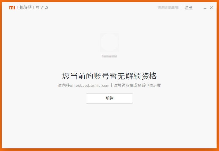

I am stuck on this page :
There's an error saying that the message cannot be sent to my phone number, and I cannot get the verification code.
Can anybody help me?

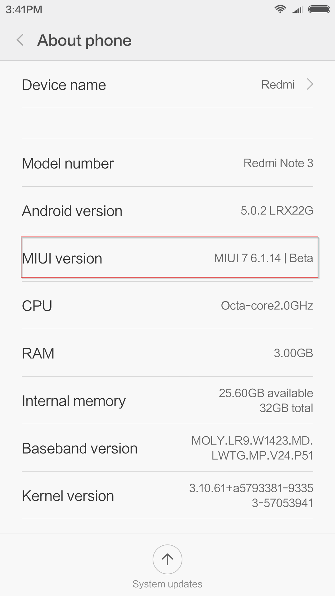

I had try to unlock my bootloader, but i get some Errors :-(
1. i`am on DevRom "MIUI 7 6.1.14 Beta" - see Screenshot 1
2. When i try to get on "MIUI 5.12.24 via Updater i get "Can´t verify Update" - see Screenshot 2
3. When i try the "MIFlashUnlocker" i get some Error because my Account is not Verified to unlock my Bootloader - See Screenshot 3
Have i wait for the Unlockcode or is there an other way to Unlock my Bootloader?

I also have a problem with unlock tool. I have verified mi account(with phone number too), redmi note 3 is connected to this account, it's on latest china dev weekly 6.1.14, entered fastboot and connected to laptop(no problem with drivers), logged in unlock tool, but can't unlock bootloader. I always get redirected to online application form.
Is applying for unlock only solution? Should i try removing rn3 from this mi account and connect it to another mi account?

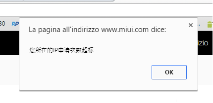

i'm stuck on this page/popup after i recieve and put the sms activation code
what did it means??? in miui unlock application so it say me i'm not able to unlock for this reason i think
