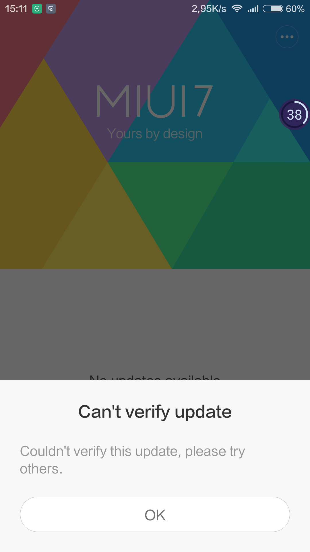

I succesfully unlocked the bootloader (after have waited for xiaomi permission) but after i flash your patched TWRP recovery and try to acces it (volume up + power) it goes in Xiaomi recovery. Is it possible? i read somewhere that i should delete the file "recovery-from-boot.p" . Is it safae to do?
Same problem here. Did you do it?

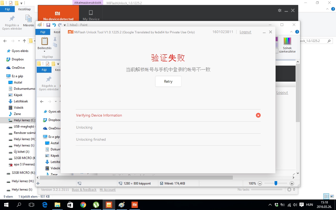

I am new in all this. I am on Global Stable ROM On RN3 Pro 2/16GB,
I am trying to unlock my bootloader but it stuck on 50% With Error : "Current Account Is Different From The Account On Device."
- I have confirmed that using same account to login as i have already logged on in my device. and checked i.mi.com also.
-Please suggest me solution..
Thanks In Advance
Thanks In Advance
Do you have official rom or a vendor rom?
Unlock bootloader works on china dev rom and/or china stable rom only if I remember correctly.
I was on Global Stable. Flashed Global Beta But Didn't Worked :(
Can I use this on Note 3 PRO and Stable 7.3.6.0 or I should install something different on phone? Please answer.
