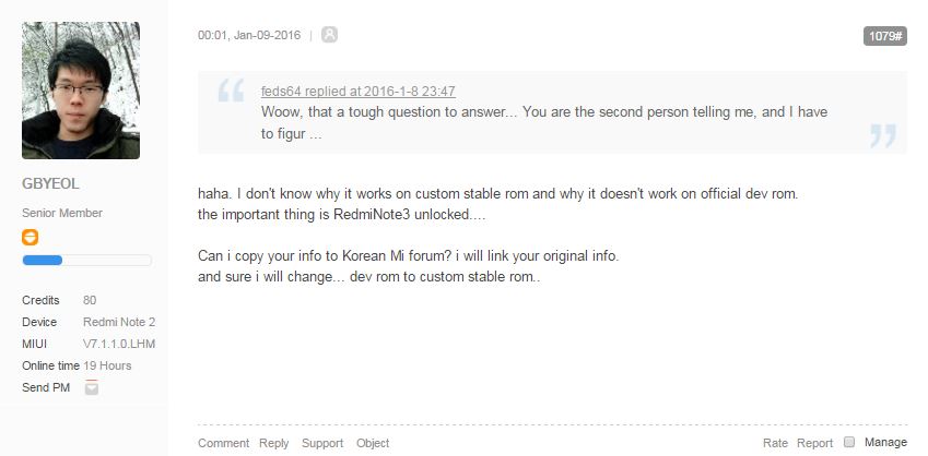

Look at this unique case, this is the second time it didn't for 5.12.31, yet working for Sphinx... Haha, I cant figure it out....
That the reply I got....
Hello. I finnally succese to unlock bootloader. Thanks.
But I have a question.
when I tried unlock on Official dev rom 5.12.31, it didn't work.
It stuck 50%.
then I tried SphinX v1d stable rom (7.0.22.0). Miflashunlocktool unlocked bootloader.
What's the problems on official dev rom?
It succesed on many Redmi Note3 with SphinX v1d.
http://en.miui.com/forum.php?mod=redirect&goto=findpost&ptid=199580&pid=3868533
This is even more interesting....
Go figure it out...
I am speechless...
