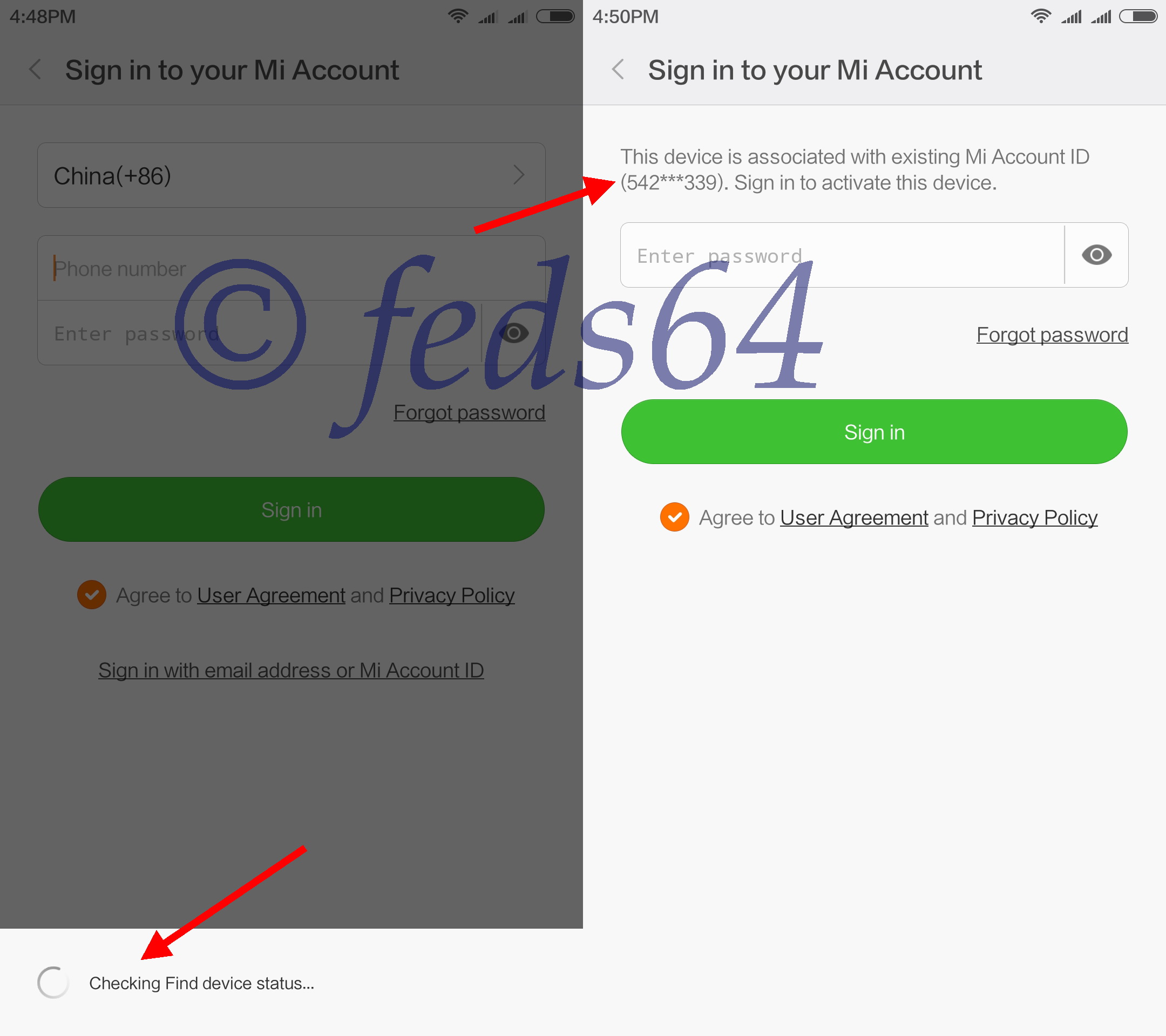

Can you show to us a photo about your recovery, twrp? Need to root pbone before unlock?I tried my method and got thru with flying colors... "Unlocked"
Is there a way to know if my unlocking was succesful?
When you have it, you tell me... I will assist you accordingly...Guys who said stuff about 10 characters message in the request box, try using google translate to make it simplified chinese, it worked for me. Now im waiting for the sms with a code i have no idea where to use. I didnt try this yet, can any1 tell me where i will have to type the code they send me?

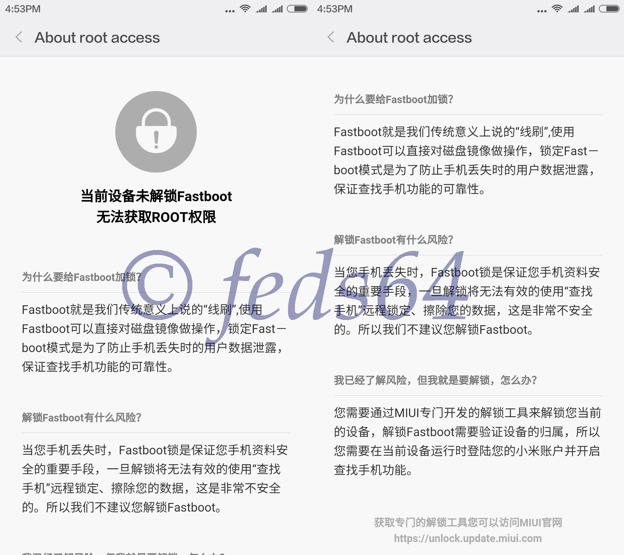

Simple, just check your Permission, and see whether Root access appear as one of the option, If it does, then it will let you proceed to root your device... Once you are able to see these images you are successful.Is there a way to know if my unlocking was succesful?

I heard that there were some bugs in the ROM, although I haven't met any, I'd like to have a back up plan. Also, the bootloader unlocking didn't work for me too. Pressing the chinese button lead me to the page where i applied for a code I have no idea where to enter when I get it.
Vin87 said:yes I've received my permission today. I have two MIUI accounts by accident. I have unlocking permissions on my account that was NOT connected to i.mi.com and was not verified fully on i.mi.com. This is a very new account, I was only 'senior' member on En.miui.com. I logged in on my phone with this account (by using the email login option) and started the unlock app. Unlocking was done in a few seconds. Then I've flashed the TWRP right away (using this thread). Shut down the phone and started recovery (vol+ and power). Then flashed SMiui and now everything is running like a charm. Thank you for this guide
So in short: the Only working guide:
-If you are a regular member and you open the Unlocking app and it redirects to the unlock.miui.com your only option is to apply for the unlocking and WAIT. For me waiting took 21 days
-Don't bother setting up the whole i.mi.com stuff, It won't help you at all. Don't bother at spamming en.miui.com to become a gold member, this won't help you either
-If you receive the unlocking confirmation by SMS flash the DEV rom using flash tools, download the latest xiaomi.eu or smiui rom and put in on your internal storage)
