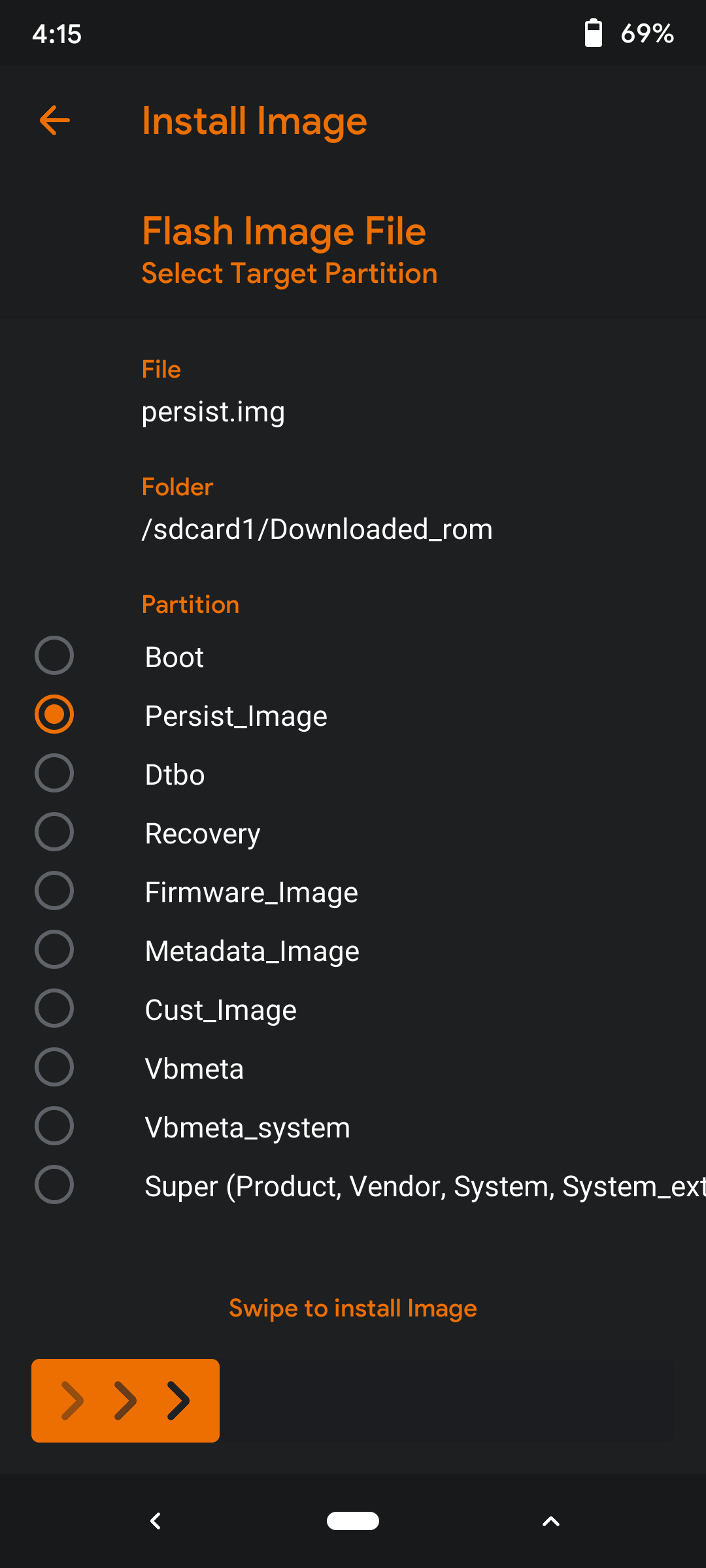

I`ll try this when i catch a little free time. Just one more thing, how do you flash IMG file in recovery ?
Tnx in advance
When you click the persist.img file, you'll see the persist_image, tap that partition then swipe to flash like the ones showed here
