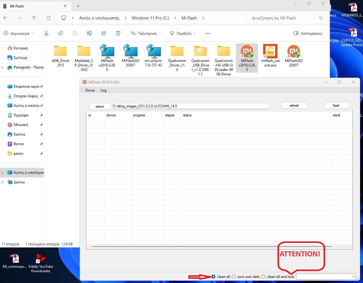

First instal the official China rom (diting_images_OS1.0.2.0.ULFCNXM_20231225.0000.00_14.0_cn_fd43607a5f), fastboot mode, use MiFlash v2018.5.28.0 or MiFlash20220507, never check "clean all and lock", recommend "clean all", when finish, boot your cellfone and select only English language, (unlocked Mi account with your password) then. reboot in fastboot mode, and use on windows PC, the xiaomi.eu rom, "xiaomi.eu_multi_DITING_OS1.0.2.0.ULFCNXM_os1-14"
and run double click the file: windows_fastboot_first_install_with_data_format.bat .
