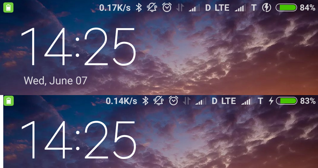

quick charge is not working here .charging like a sloth ! :/
anyone else having the same issue??
I flashed twice, different images of that version, clean installation, and I got the same problem.
I can't install anything in play store or apk/manual
they added quick charge notification
