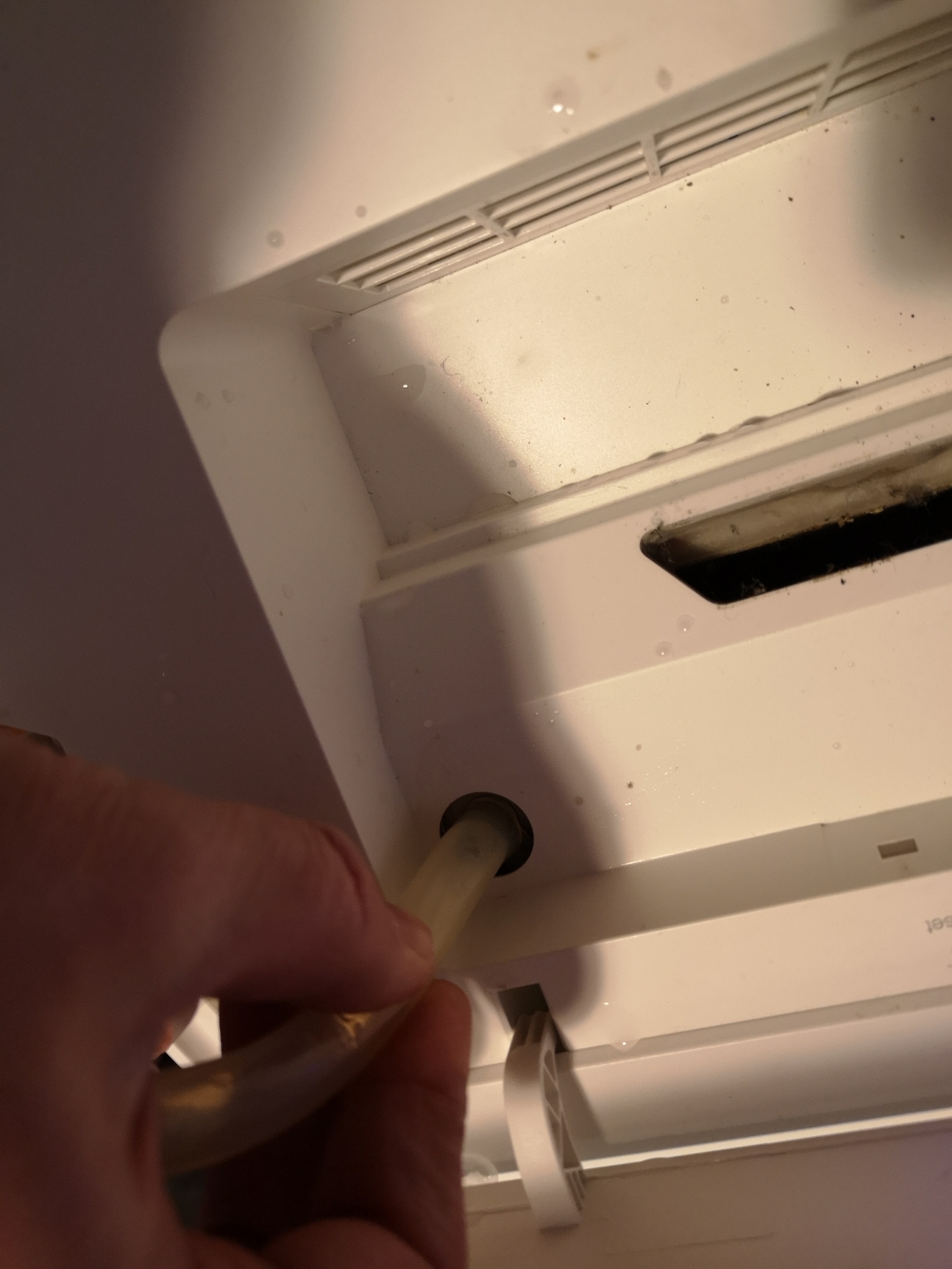

I had the same problem after 2 months of not using the vacuum (while tank being filled with water). When tried to reuse it, orange warning light was flashing the the known announcement was heard. The disassembly procedure seemed tedious and was reluctant to follow it. Here is what I did and worked in my case. I got a silicon hose with a diameter a bit larger than the water output hole. I pressed down the one end of the hose to the water input of the vacuum and with a mouthful of water, I "blown" the water into the vacuum water input. After that I reinstalled the water tank and worked normally!
I had the same problem after 2 months of not using the vacuum (while tank being filled with water). When tried to reuse it, orange warning light was flashing the the known announcement was heard. The disassembly procedure seemed tedious and was reluctant to follow it. Here is what I did and worked in my case. I got a silicon hose with a diameter a bit larger than the water output hole. I pressed down the one end of the hose to the water input of the vacuum and with a mouthful of water, I "blown" the water into the vacuum water input. After that I reinstalled the water tank and worked normally!View attachment 46406
Question, when you blown the water in the hose, the water came out in the mop side?
