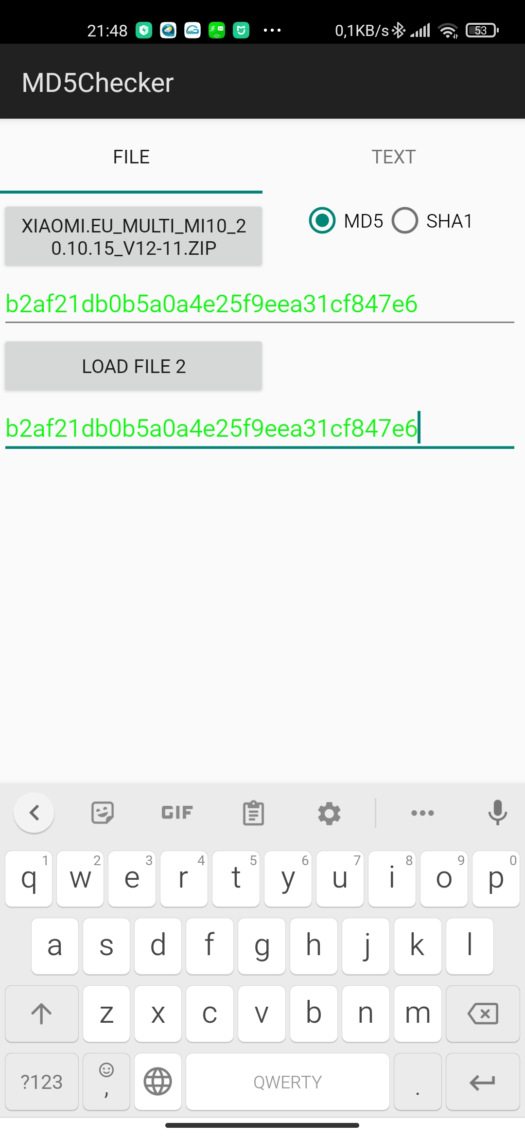

Mine Mi 10 went to bootloop. Entered twrp and tried to install the rom from there. Got an error message when I tried it. I rebooted the mobile and entered in bootloop. Reentered twrp and installed the previous version. Luckily it was installed ok, it boot. When it entered made a soft reboot. After the reboot seems to be ok for now. Also OTA still shows me that there is no update. MD5 is ok
