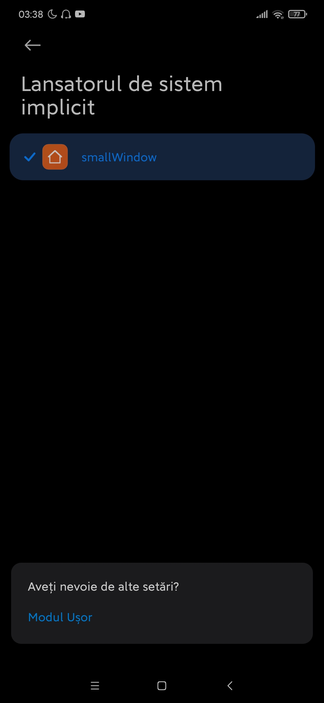

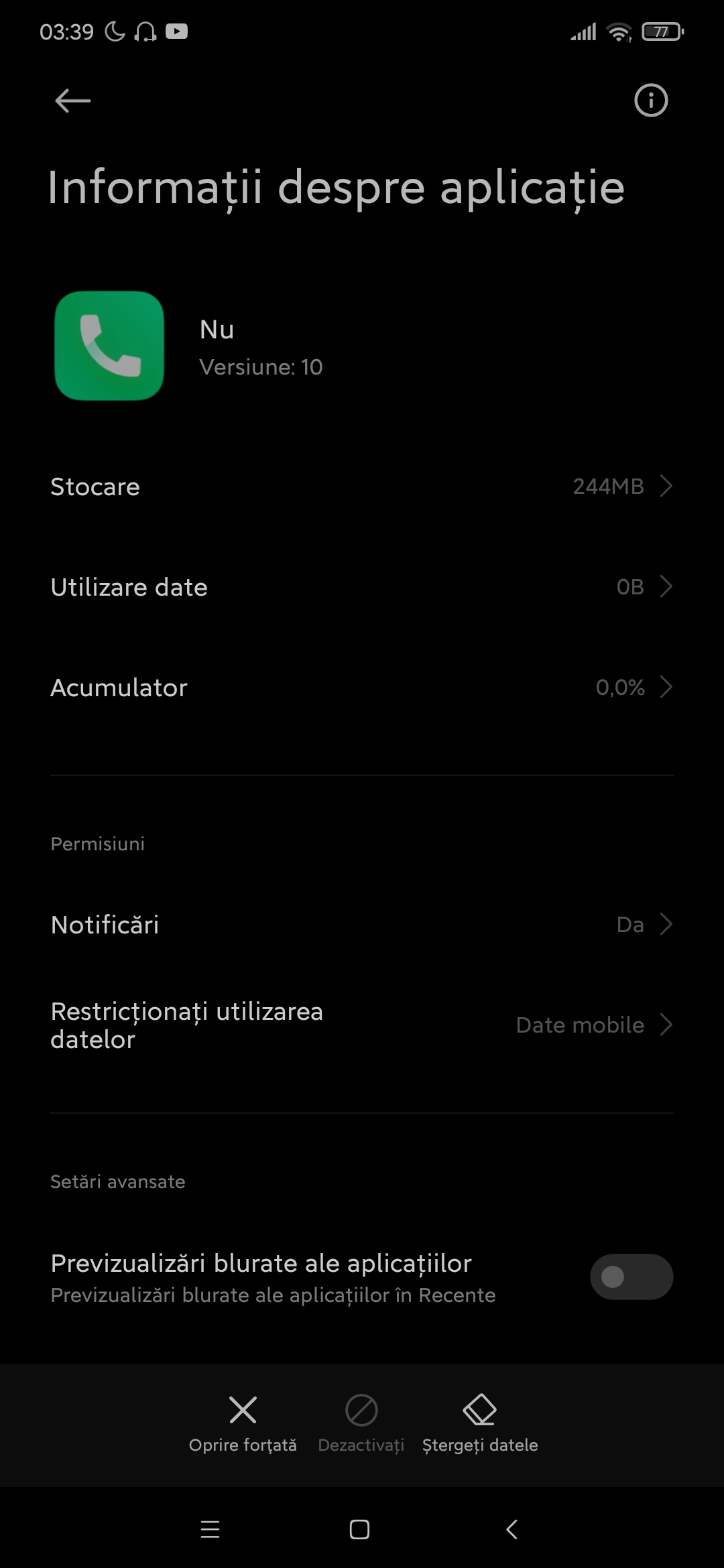

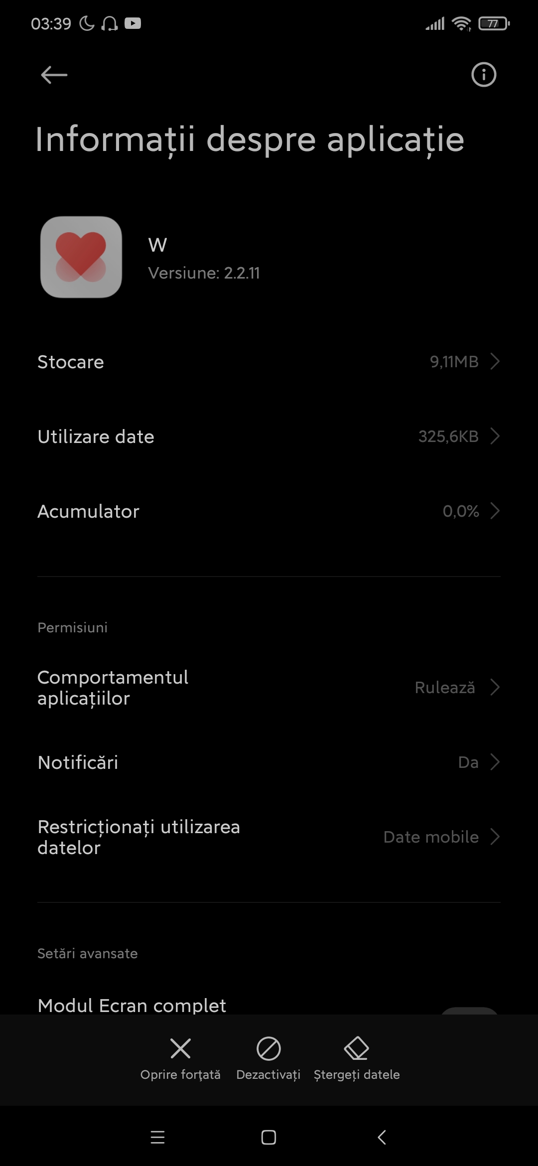

Again, great performance on Mi 9 Lite, but I think there's some silly bug (or maybe an issue only on my device) when dirty flashing from 20.5.28. Some of the apps have wrong names, as shown in the screenshots below. Switching to English still has this issue. Not a deal breaker, but I was curious if anyone else has experienced this.

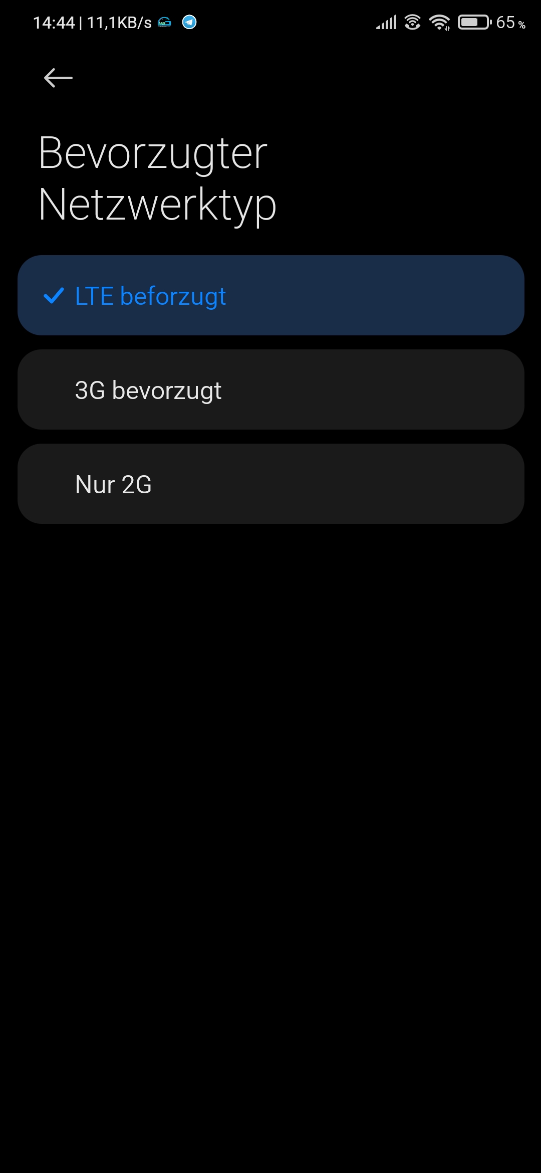

"If there was a problem with the network type they use, you wouldn't be even able to connect to your 4G/LTE network. Like, at all. "
That is not the issue. Network mode code 9 is what EU need. It's LTE / UMTS (auto) (LTE/WCDMA/GSM)
In mi.com global/eea ROMs there's still no mode 9 so when 4G is lost it will not connect to 3G but instead try to connect to a Chinese standard.
It will fail and try to connect to gsm (2G).
In previous Xiaomi.eu with the fixed network such as Xiaomi.eu for RN9P 11.02 the code is like this. It defaults to Mode 9. Perfect.
<integer-array name="support_networktypes_gsm_master">
<item>9</item>
<item>20</item>
<item>19</item>
<item>18</item>
<item>11</item>
<item>12</item>
<item>2</item>
<item>3</item>
<item>0</item>
<item>1</item>
</integer-array>
In this weekly 20.6.4 Xiaomi.eu it looks like this:
<item>32</item>
<item>20</item>
<item>18</item>
<item>1</item>
</integer-array>
Same as on mi.com Global / EEA just like promised. I've solved this problem for 3 years on 3 different phones and was happy to see the fix added to Xiaomi.eu. And too bad it's now removed. But ok, no big deal for me personally. But this is why people with poor 4G signals complain.
