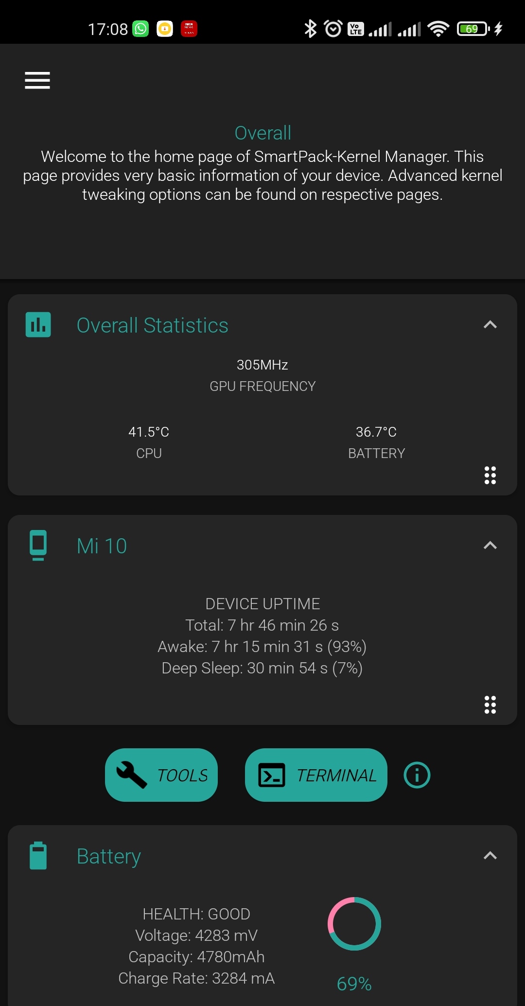

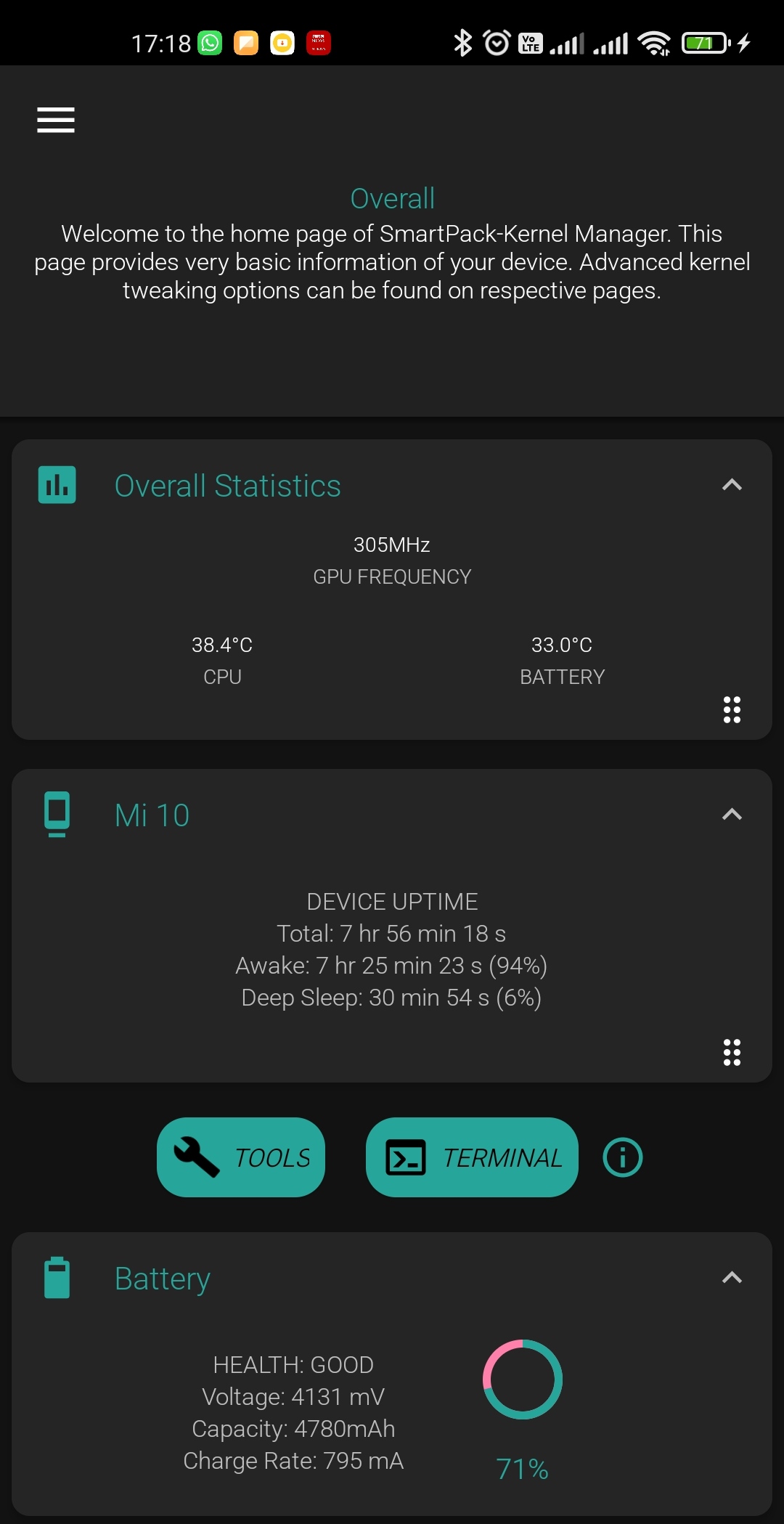

Lol, ~only the essentials @Iain_B (ultra power saving mode):
I thought that I would take similar readings. One is for the the turbo charge, the other is for for my Fastboot connection. I note that my temperatures are higher than yours.
Eh, well, before I changed to ultra power saving, the temps were at about 65c cpu and 37c battery when charging.
Also note that wireless charging I think is less efficient that wired, meaning more heat. Finally, the faster you charge, ~the warmer it gets. I charge at ~7.5W.
