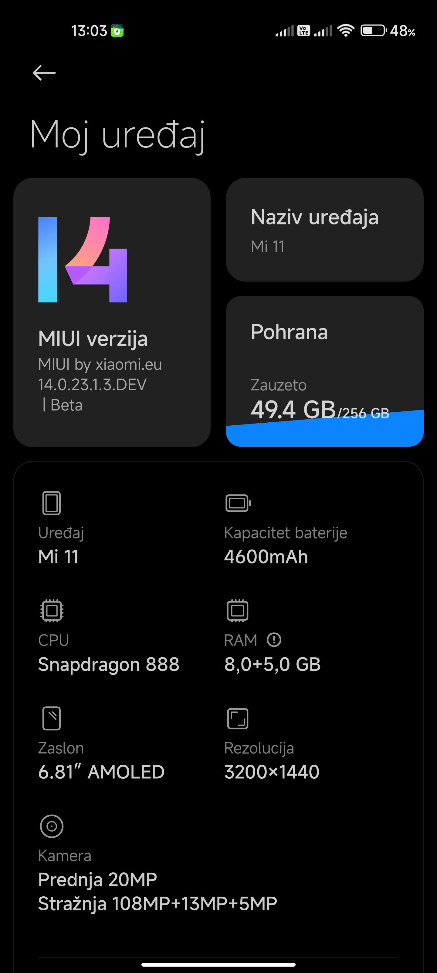

MIUI 14 23.1.3
Installed mine on 11pro yesterday because 11pro/Ultra was already on server. Flashing recovery failed with no partition, but resolved using this guide and method 1.
In advance I copied xiaomi.eu zip and twrp.img to phone main storage.
From fastboot I had to "fastboot boot twrp.img", once in recovery I did "install recovery ramdisk" and selected trwp.img and installed. After that rebooted into recovery and installed the zip with new ROM regular way via recovery.
No issues at all after first 16 hours of using it.

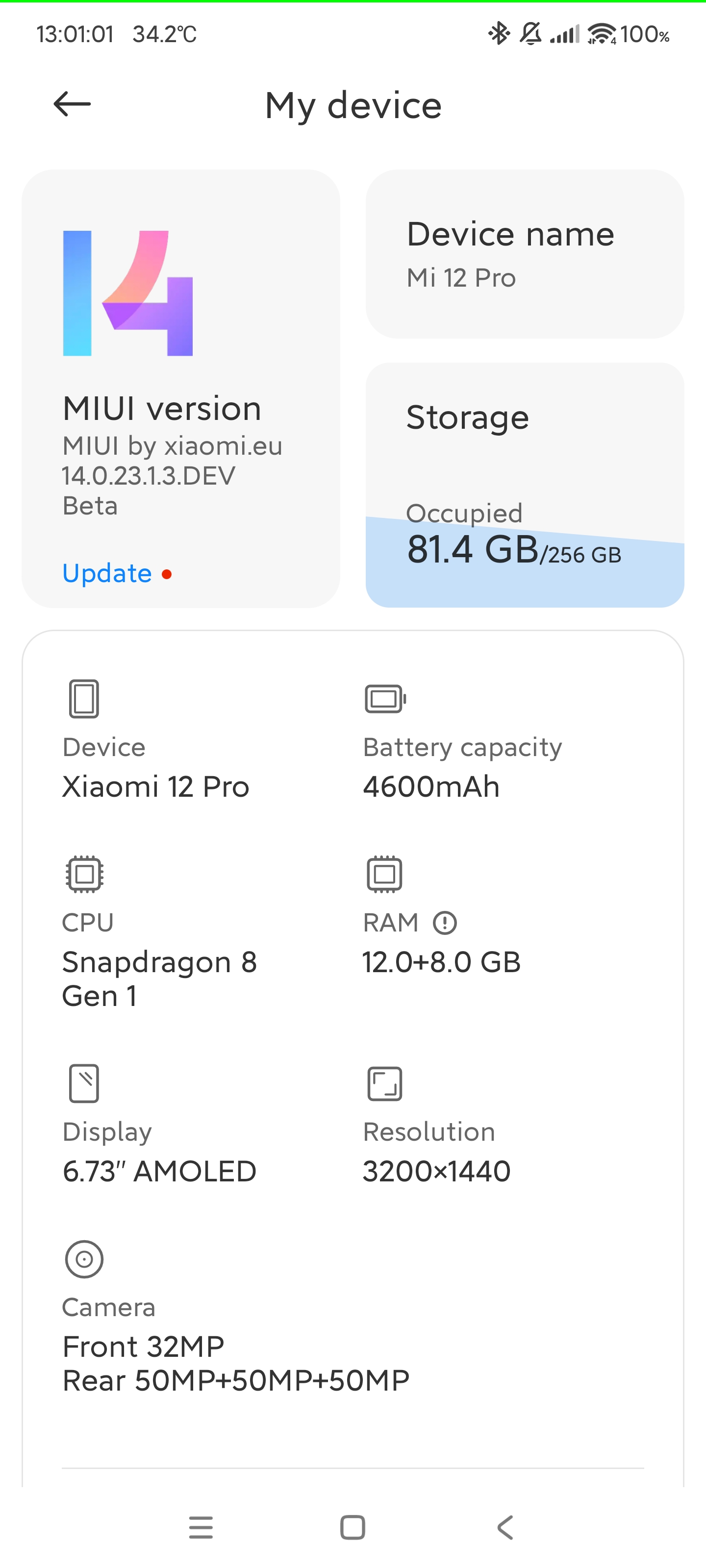

Updating via TWRP worked perfectly on my MI 11 and Xiaomi 12 Pro. Rooting via Magisk.zip diractly after worked too. So far happy with this ROM, aside that the settings still show the update dot.
Quick edit: The "update available"-dot disapperad

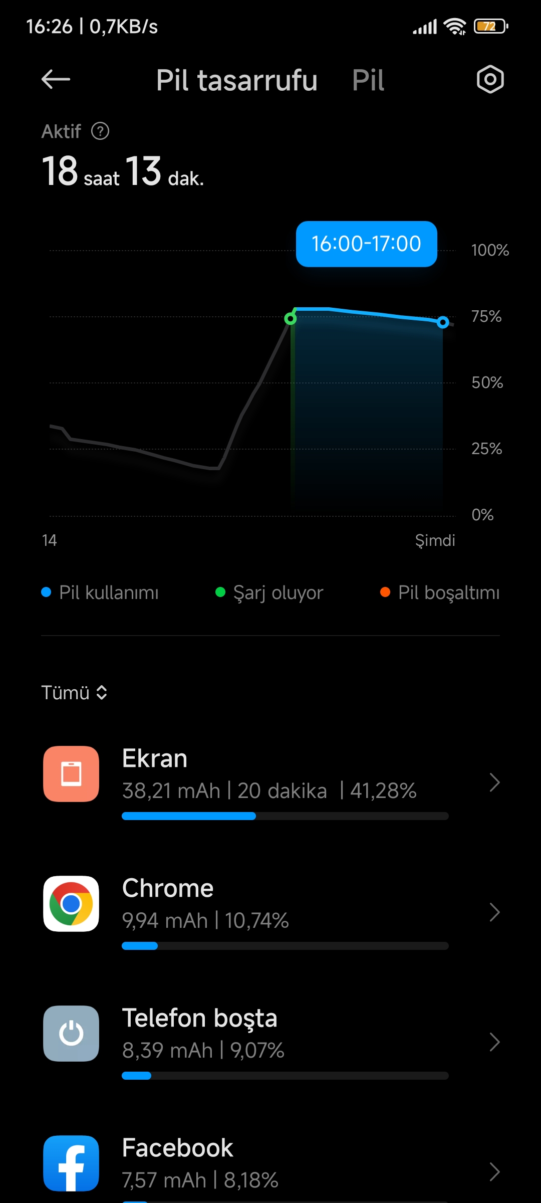

I don't think that draining 10% in an hour is a problem, depending on how heavy the use is. Browsers like chrome tend to drain more battery because it actually is a bit more processor-heavy than some other normal apps
Dude, it's been 20 minutes. Normally it took up to 50 minutes
