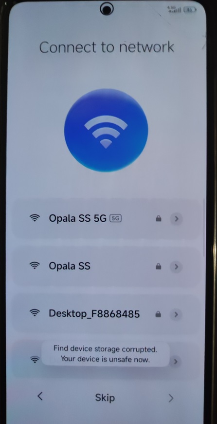

Does anybody know how to solve this?
I made a mistake in the command to install twrp, I used the command "fastboot flash recovery_ab twrp.img", could this be the possible error caused?
Install the "persist.img" file from the factory ROM in TWRP.
