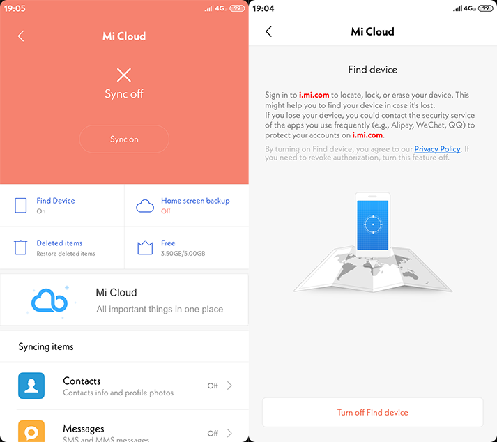

Why remove xiaomi's "Network Location" services? Now xiaomi's find device app keeps crashing.
Is it just due to the following link?
https://xiaomi.eu/community/threads/redmi-4x-santoni-bad-network-location-and-no-camera2-api.47575/
Removing MetokNLP may cause unexpected behaviours in Xiaomi's services..
MetokNLP is intended for use in China only. Keeping it there will prevent Network Location from working in certain regions, mainly in the EU.
Global ROM doesn't even have this APK, hence it is not mandatory.
Not sure what you mean by Xiaomi's Find device crashing. Mine works fine. Post a crash summary or a log.

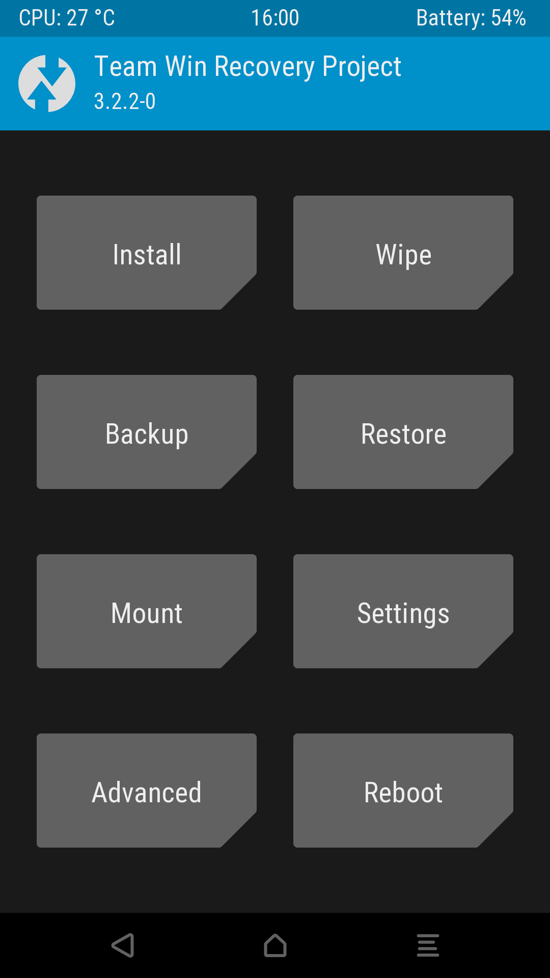

With twrp 3.2.2 there is no black screen in mi5x, all works fine!
Is evrything working? cell network? battery?, and how did you flash it, wipe cache, dalvik cache, data??
Do you have this version of twrp? (See picture)
For MI5X users with black screen
Flash this fastboot image http ://big o ta.d.miui.com/8.11.15/tiffany_images_8.11.15_20181116.0000.00_8.1_cn_6ea7e322a8.tgz (delete the spaces) and try MIUI EU again, using the TWRP 3.2.3. I had the black screen bug, but after flash this fastboot image it was solved
