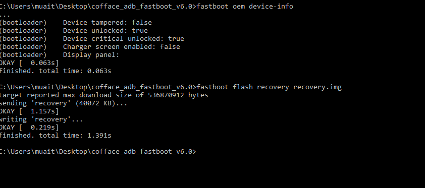

Mi5 comes with a locked bootloader and no recovery mode available.User can request an unlocking code and unlock bootloader(after long waiting it....)
I unlocked bootloader and flashed twrp recovery in fasboot mode but i still can't access to recovery.
My output in fastboot for checking bootloader status is
after imput fastboot string : fastboot oem device-info
Please share your fastboot output for locked and unlocked bootloaders with MI5.Simply put phone in bootloader mode (vol - and power ) open adb fastboot (use cofface adb fastbootv6.zip) and imput command:

try use
Code:
fastboot boot recovery.img
Thank you ingbrzy for your reply
With fastboot command twrp recovery is available now how can i load recovery mode directly from device with vol + and power?
Did you flash recovery..?
follow my guide here
As in 1 post picture i flashed recovery (not edited boot .img only recovery) after 1 flash still no recovery..after 2 flash still no recovery.Now i flashed recovery and modified boot img and its working.Strange things :)
