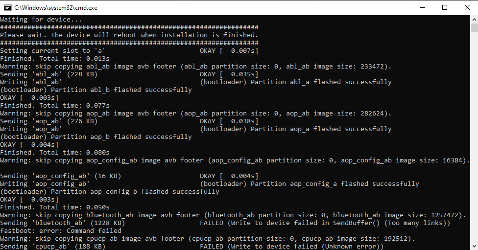

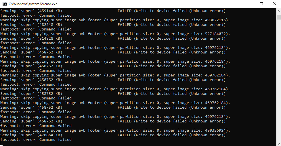

Started the update and my device disconnected and reconnected a couple of times in a row and now this is how the update looks like, what can I do? My device stuck in a bootloop, FUXI. Also adb devices command doesn't show my device
Change cable and try to reach fastboot mode and flash again.
