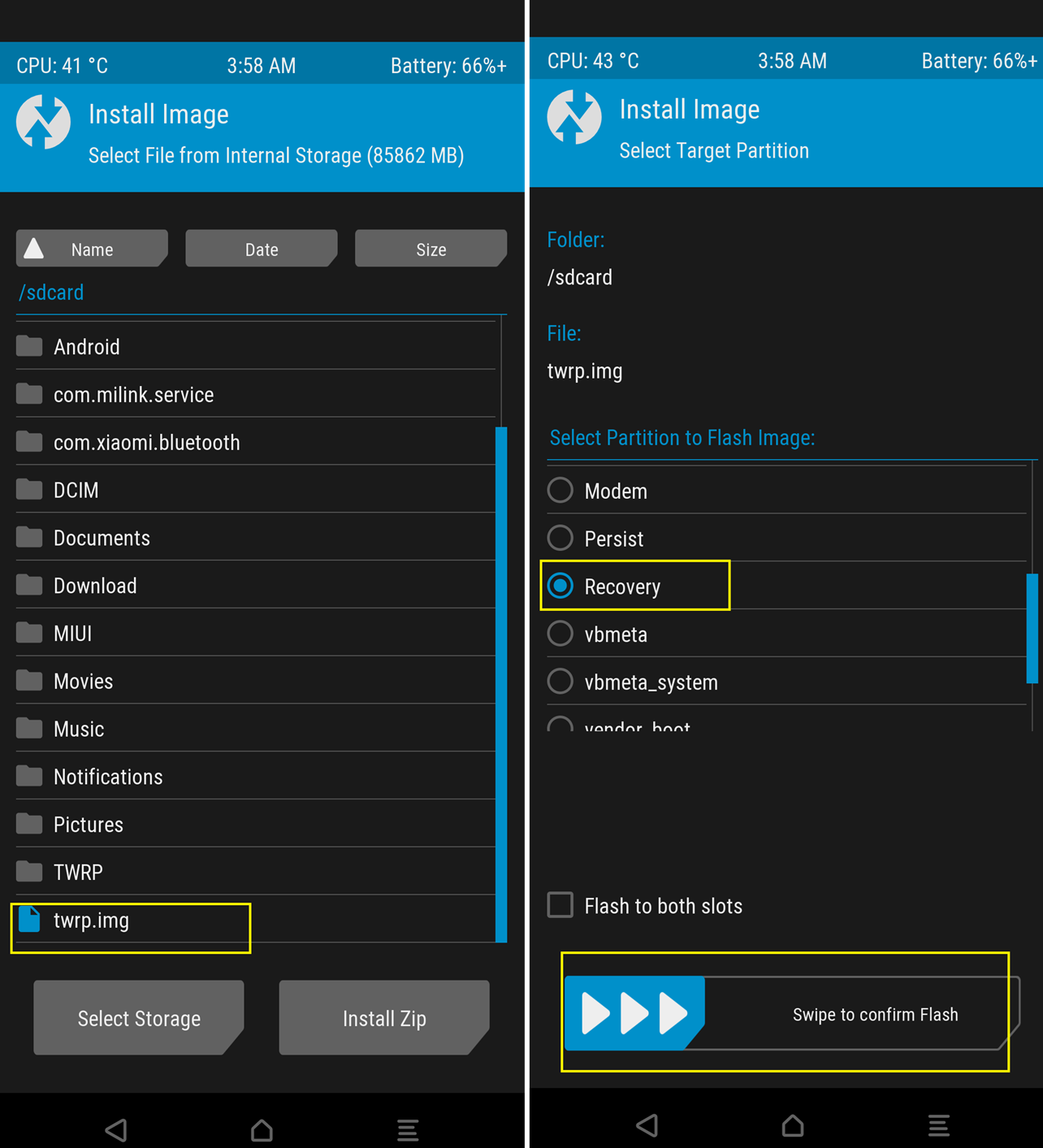

Good afternoon, I wanted to install version 1.0.6, but I have outdated twrp on my 13 pro, I already downloaded the file to update twrp but I have no idea how to do it. Any tutorial for noobs to avoid turning my cell phone into a paperweight? Thanks

I told you yesterday what to do.
Don't use a custom ROM without a minimum of basic knowledge.
Regarding your question:
1.) Go into TWRP -> Install -> Install image
If you don't find the image, you didn't select "Install image".
or
2.) Use USB-OTG in TWRP.
or
3.) Enable USB debugging, go into fastboot mode and run these commands. Before rename TWRP file to recovery.img
Code:
fastboot flash recovery_ab recovery.img
fastboot reboot recovery

Thank you, I bought the phone with the .eu rom and updating it has been easy, now with hyperOs I have to update some things that I don't feel like I have the knowledge to do.
In method number 1 the image doesn't appear, maybe I'll try method 2 as I feel more comfortable. I apologize and thank you for your help

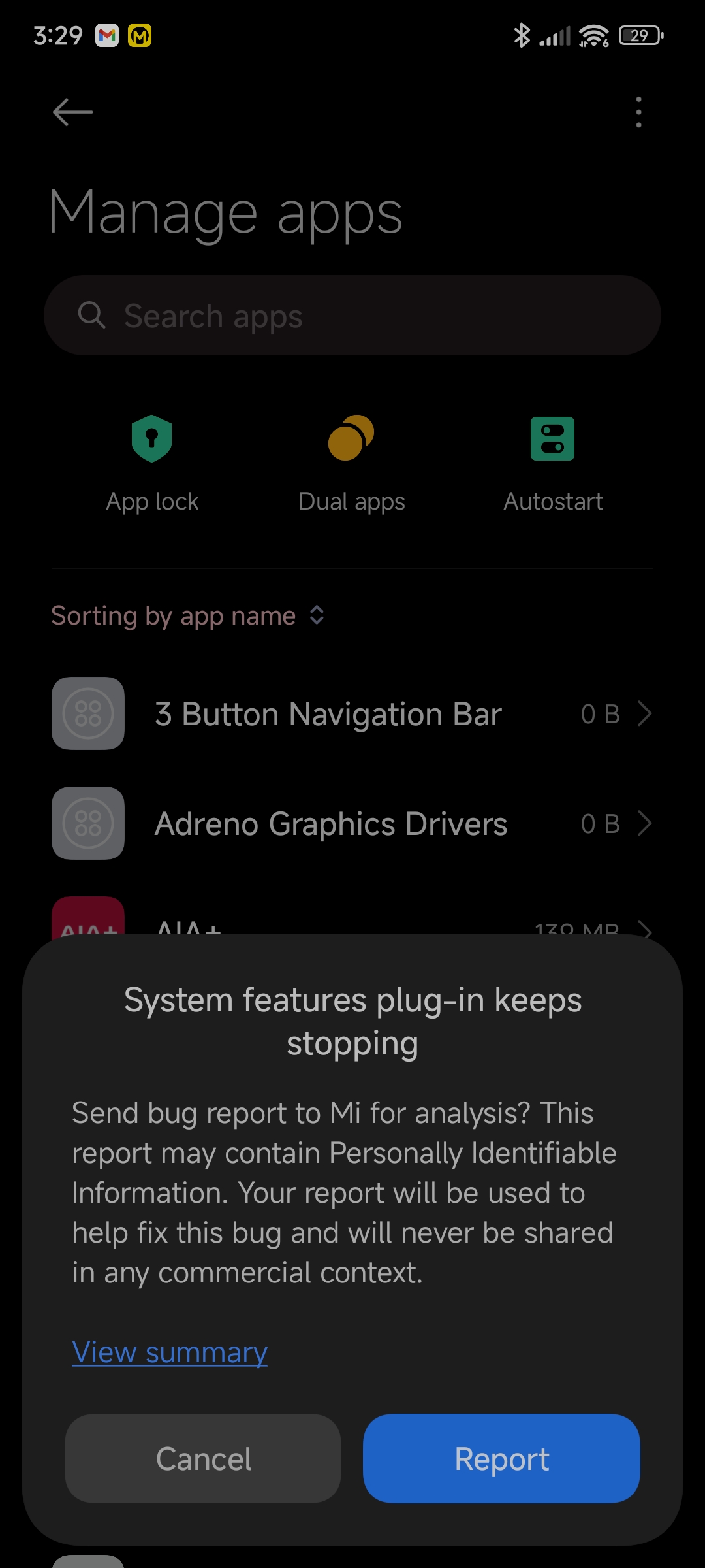

Sorry if this issue was mentioned here before, but I have an issue with dual app, I get this error when I try to open it.
My phone is Poco F5 and it's rooted.

Good morning, I'm trying to install via OTG, it asks me to choose which partition I want to install on, which one do I choose? Thanks
