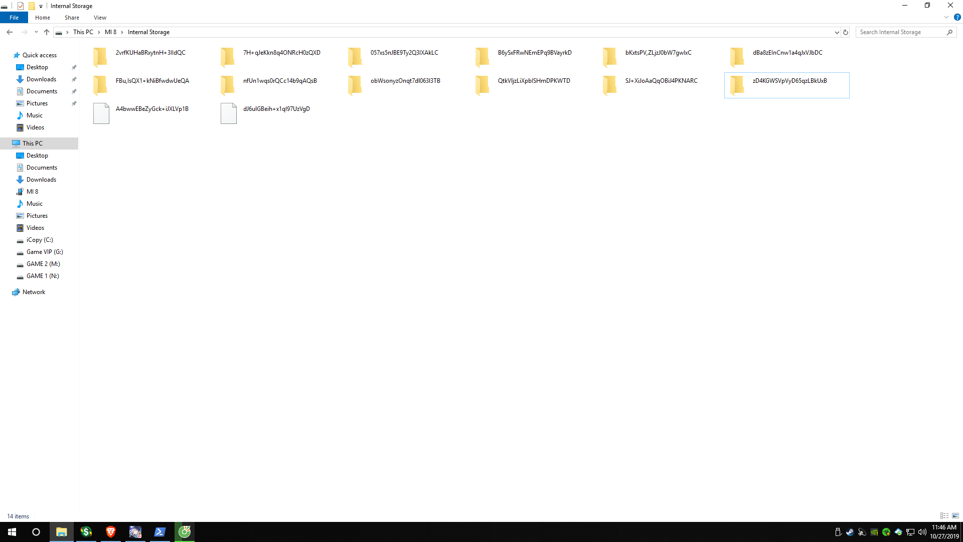

Can anyone help me with this? Im using a Mi 8 device on global rom ver V10.0.2.0.OEAMIFH. After I flash twrp, my internal storage becomes this (see attach files below), I cannot transfer files to my phone. When I reboot my phone, the recovery comes back to stock miui, so I cant flash custom eu rom. Somebody help me solve this problem please?
Your device is encrypted. Please read first post.
