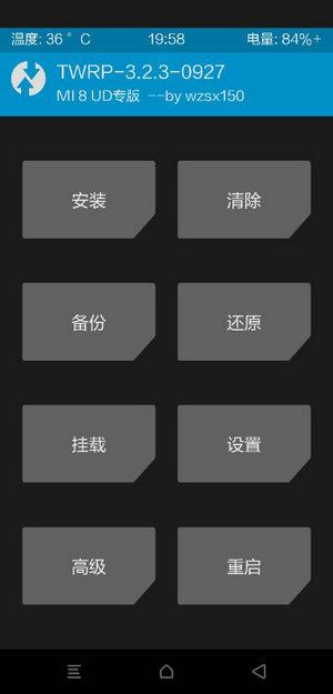

TWRP-3.2.3-0927 for Mi 8 Pro (UD) equuleus
Akune Media
Aug 24, 2014
10
Just found this on miui.com. It works perfectly. I could install EU ROM already.
Source link from miui.com: https://pan.baidu.com/s/1QbEKj6sRHeudjeoiLstAmg extraction code: i2f4
This pan.baidu link is really slow so I upload here: https://www.androidfilehost.com/?w=files&flid=127243
Credit: LR.Team
Source: http://www.miui.com/thread-18542963-1-1.html

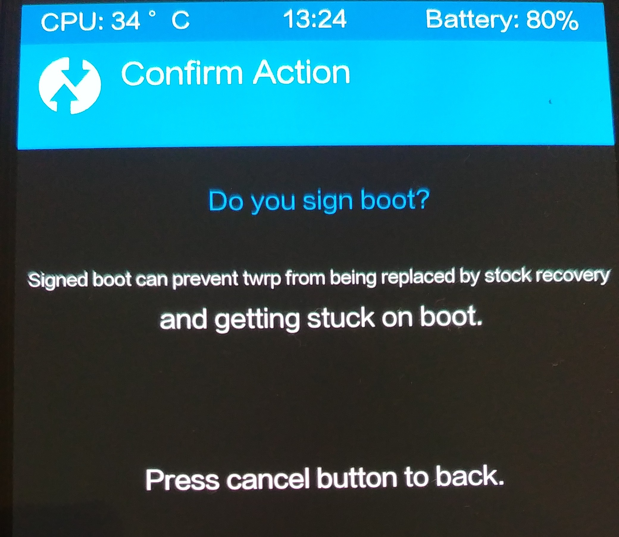

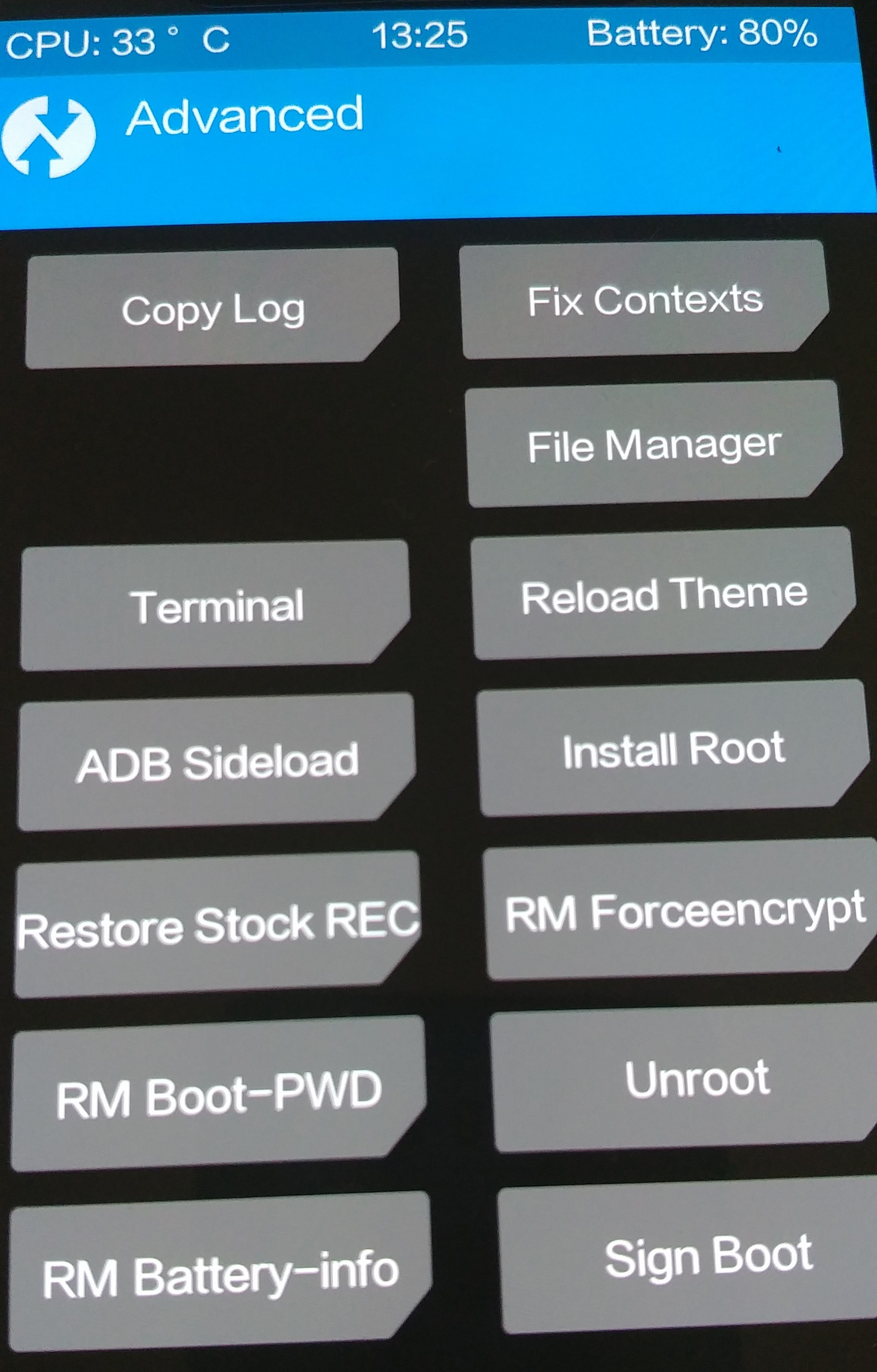

Yes, I flashed global rom, you're right...
However, I fixed my problem with Boot Sign option, TWRP 1102 Italian...
