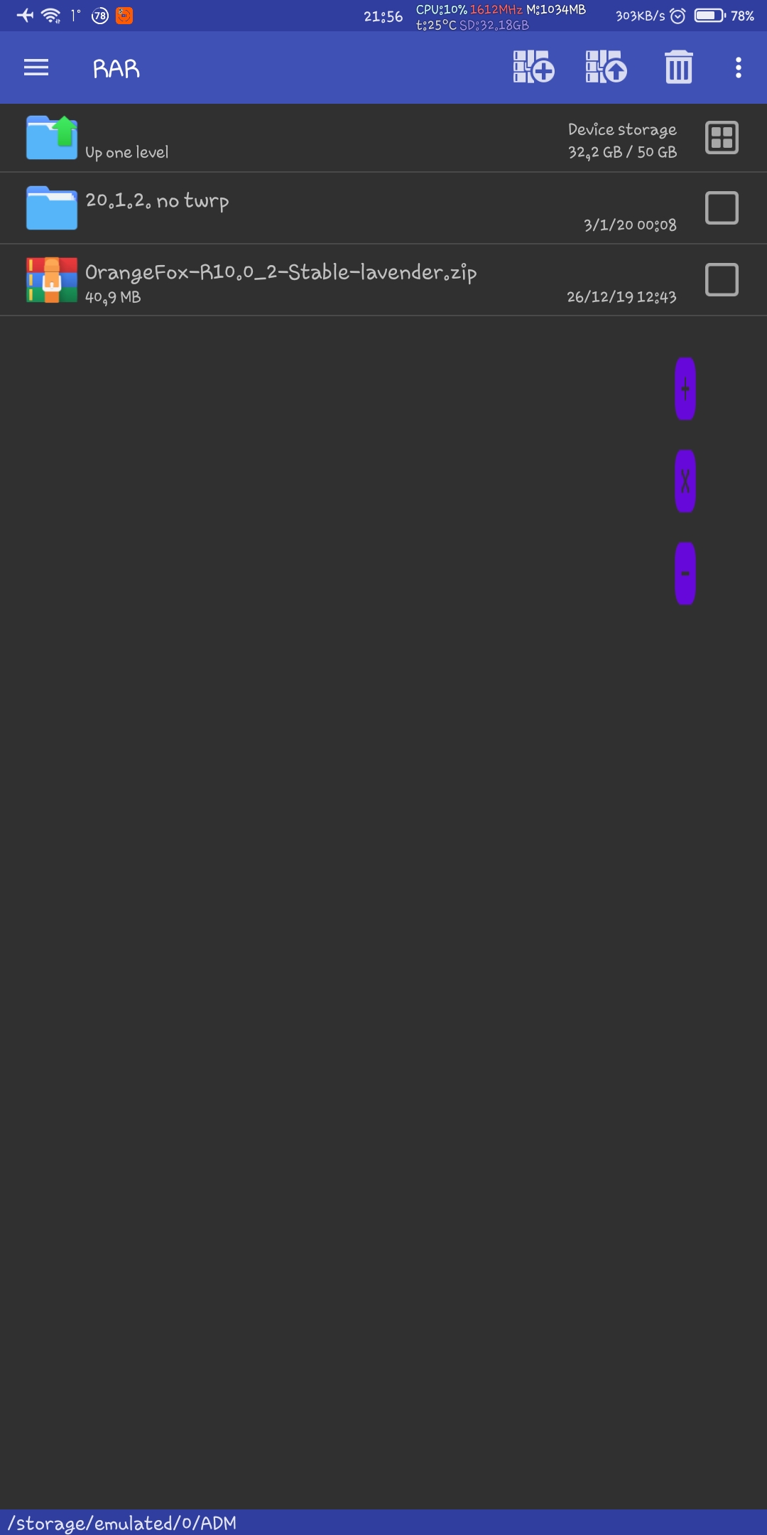

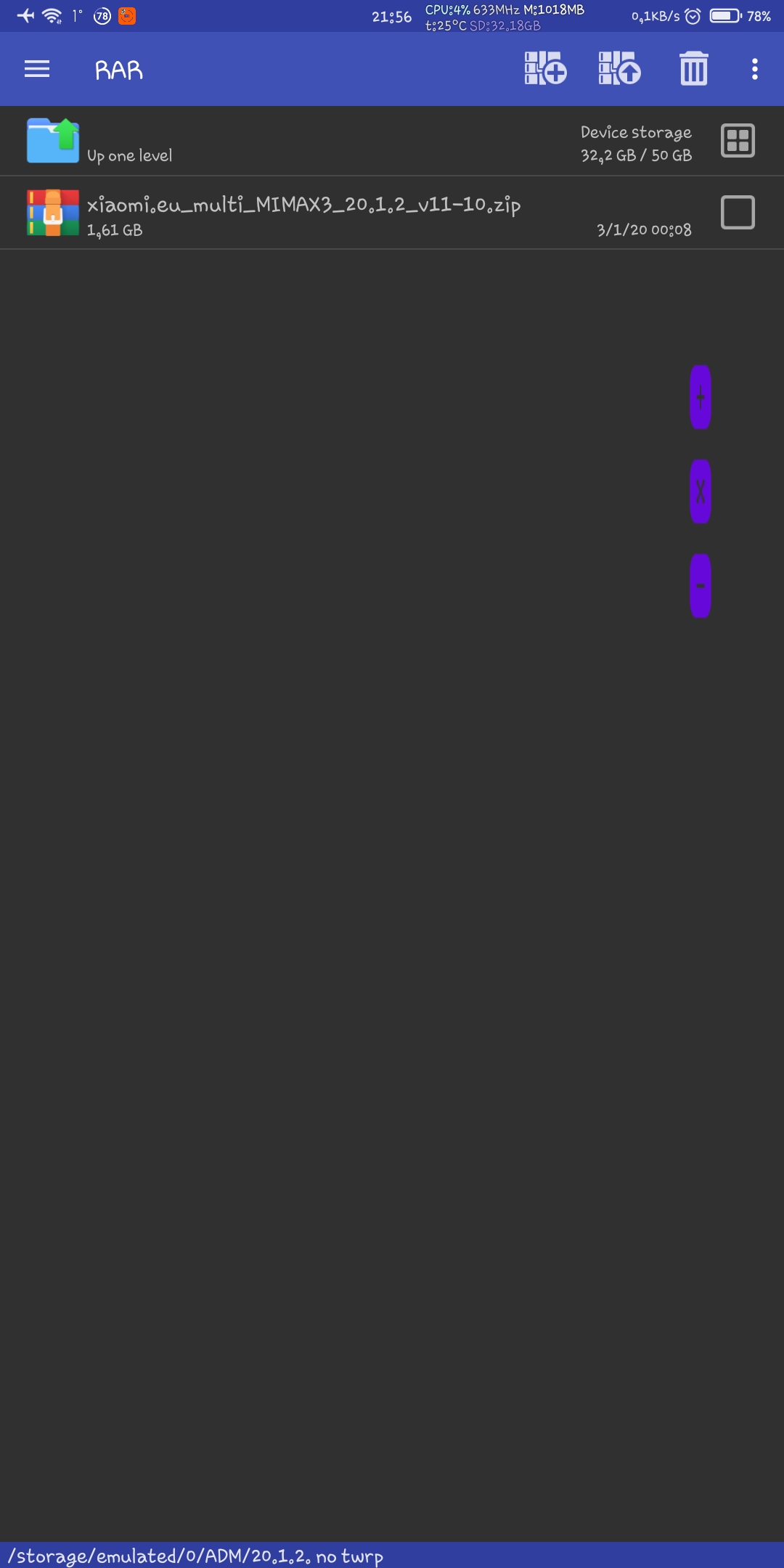

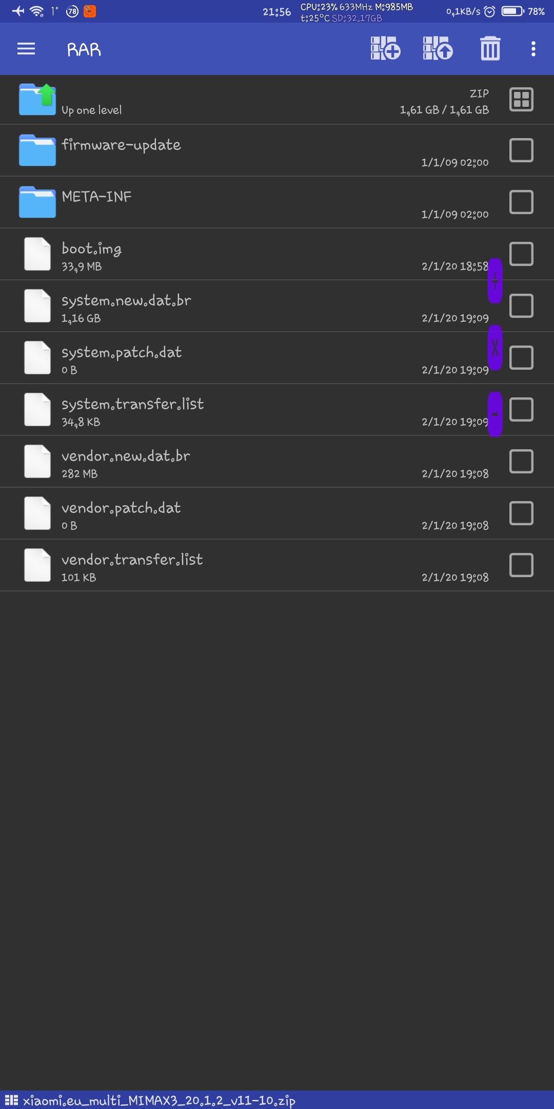

If I do so, i get an Error 7 while flashing the changed rom.
Ok do exactly want I say. Download the WinRAR app from play store, open it open the build just tick the box on recovery and press delete wait to finish press the back check with a file manager if the zip opens I use the rom toolbox and go to flash with orange fox.
