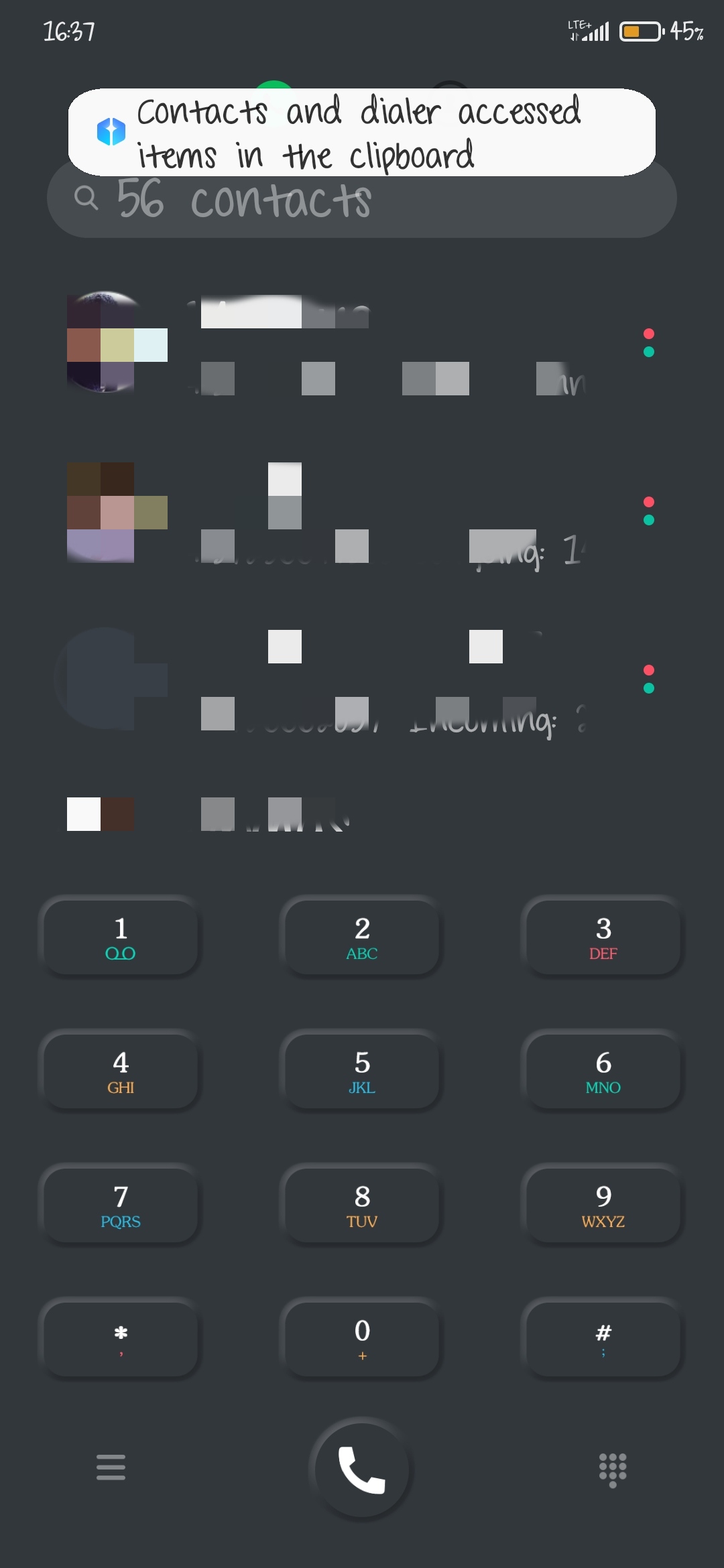

After the update, this message appears repeatedly, what caused it and how to close it

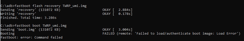

Mi10 (umi) success install this rom. After reboot boot only to fastboot.
I try install recovery via fastboot but its still boot only to fastboot.
Boot to recovery from fastboot doesn't work also:

I've already try astboot boot TWRP_umi.img but got this error: Failed to load/authenticate boot image: load error" fastboot: error: command failed

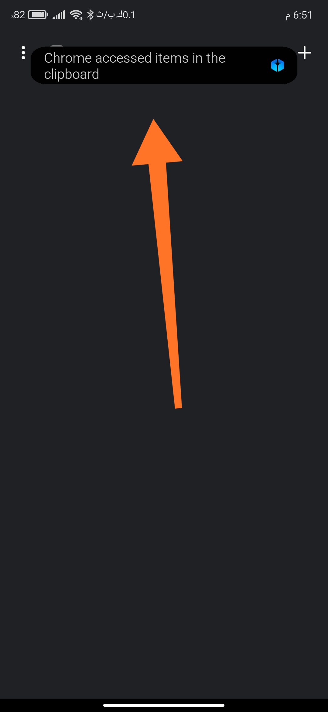

This message will appear for 3-4 seconds just before call. Is it possible to disable it from somewhere. MI9
Yes , i saw it .. but did you try only fastboot boot TWRP-umi.img without firstly flash the twrp ..
As i saw first you wrote .. fastboot flash recovery TWRP_umi.img ..
I told you to try to re-enter fastboot mode , not after these commands , close phone and enter fastboot mode again , then try fastboot boot TWRP_umi.img first..
Gives the same error ??
