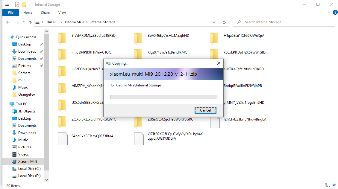

I tried to install magisk 21.2 the last time after the but it did not work... however .... what is the order ROM>Magisk uninstaller>Magisk?
I tried but there is no "download" folder where i store the files its all "gibberish" folders.... and no file there to try to flash again
EDIT: If u ask me why i didnt boot the first time again in twrp is because when u get the fastboot thing its usually not very good... and i spend almost all day today and cant install again so this proves my point and also im starting to regret trying to flash magisk after i had perfectly working phone before that.... anyways... again after the last attempt to install rom then magisk nothing happens u can boot to orange fox in my case (tried twrp aswell) but the folders are gibberish and the files are gone
Order is fine.
In TWRP: Wipe => "Format Data" is required then. ;)
EDIT: Reboot to TWRP to be able to transfert files between your device and your computer. :)

Order is fine.
EDIT: snap it wont save the files...... attaching screenshot.......
