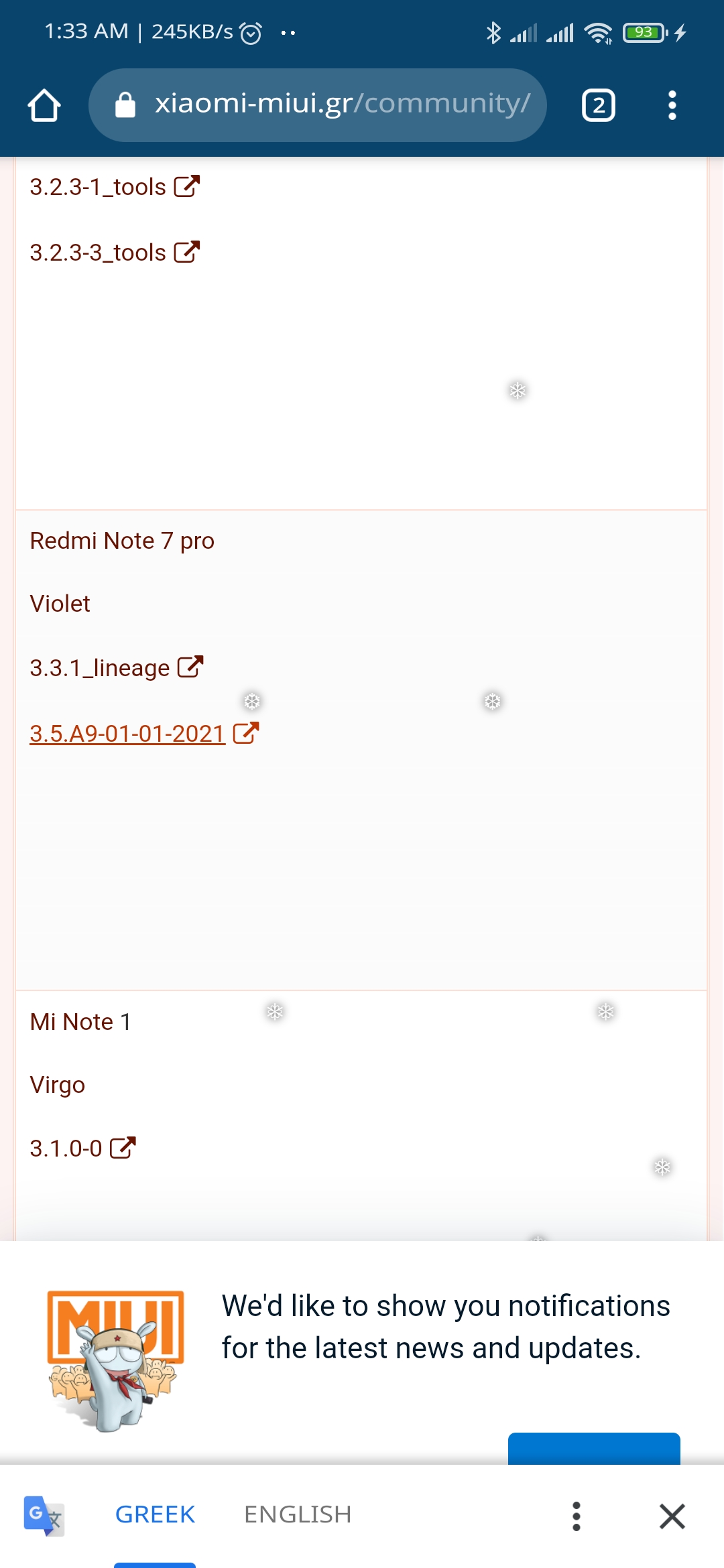

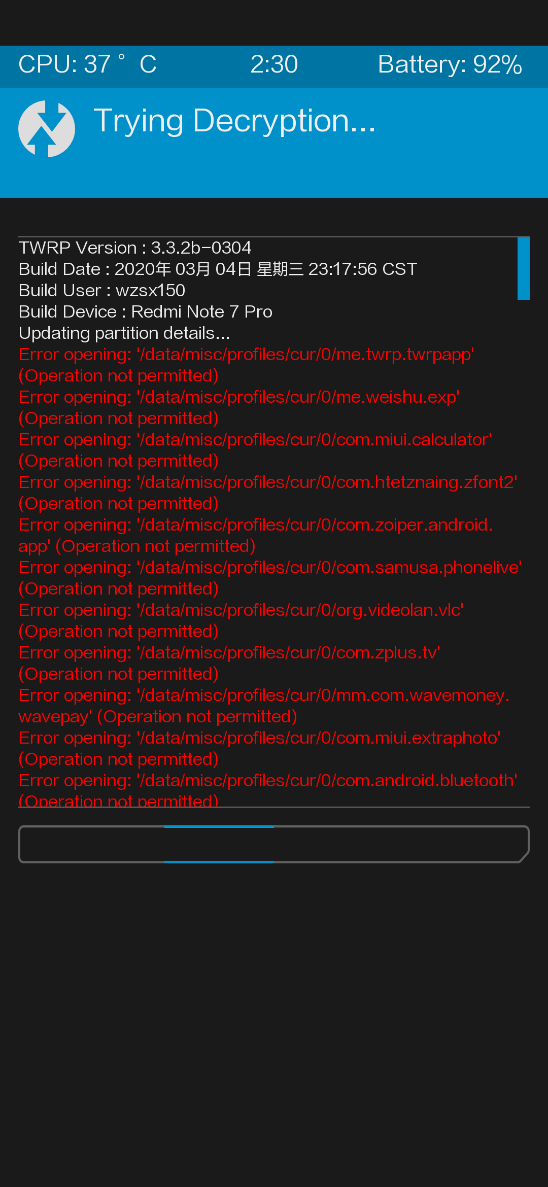

Hello, Bro
Thanks for your information.
I also have same decryption issue on my TWRP.
Can I directly upgrade from my current TWRP 3.3.2b to your suggested TWRP 3.5.A9-01-01-2021.img file?
And anything need to do?
Thanks and Regards,
Paing

Fine thanks .. i was pretty sure that official twrp will not work but i wasn't 100% sure cause we didn't test it ..
But as i said this build for Violet was tested and works without decryption issues ..
We update more twrp's , we allready update for some devices ..
We trying to solve the pin issue for decryption also , we allready have a twrp for Mi 10 Lite 5G ( Monet ) , which decrypted with pin numpers on latest Android 11 stable rom , we continue to try to solve the pin numpers decryption issue for other devices also ..

You can flash this twrp.img through your existing twrp and you can proceed to update..
You can use fastboot commands also , whatever you want ..
EDIT
We have working twrp's and tested for below devices..
Apollo ( mi 10 T/Pro /HMK30S ) ..
Surya ( poco x3 nfc )..
Toco ( mi note 10 lite )..
Monet ( mi 10 lite 5G )..
Joyeuse ( Redmi note 9 pro EU )..
Reactions: paingpeace

Dear Bro,
Thanks for your prompt reply.
I'll try to upgrade that TWRP then I'll try to upgrade MIUI 20.12.2 rom.
Best Regards,
Paing
