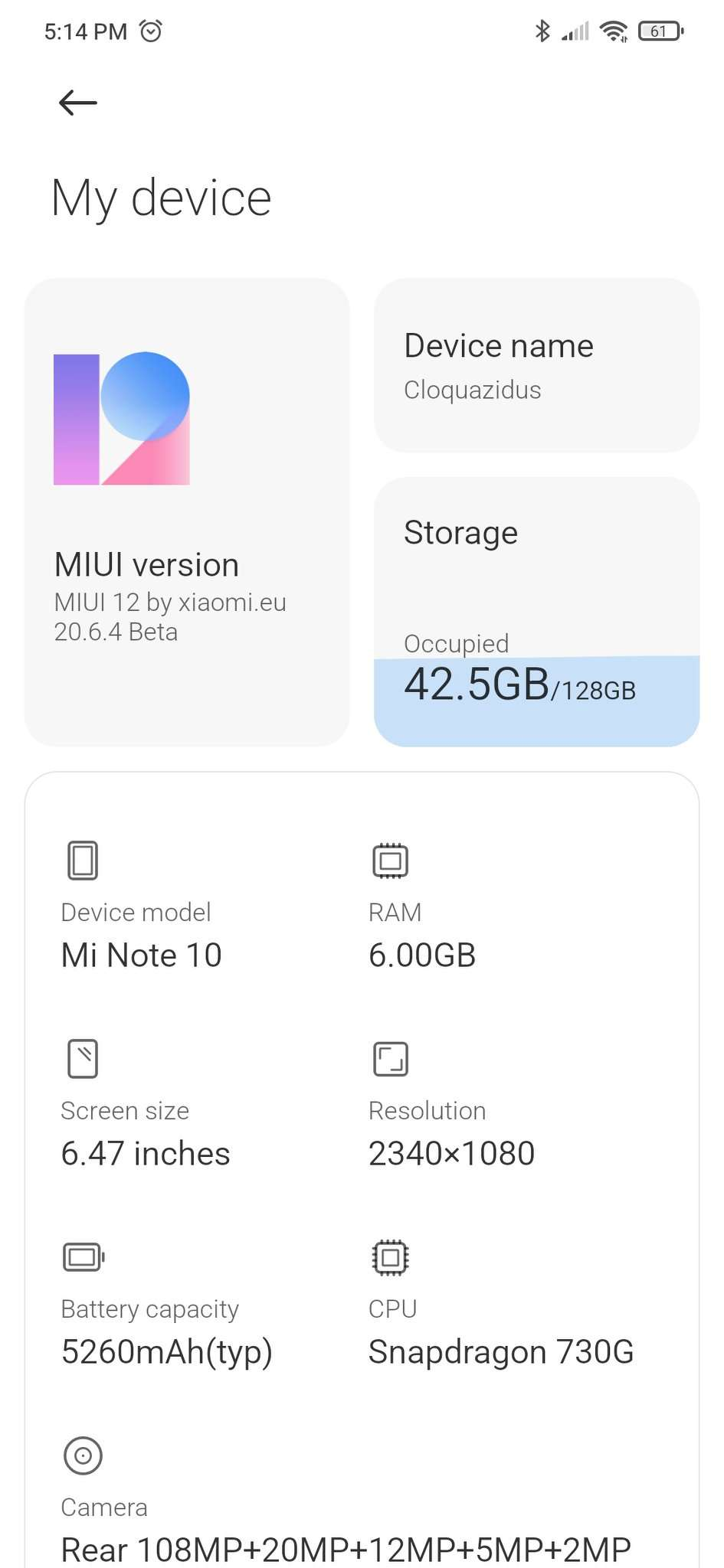

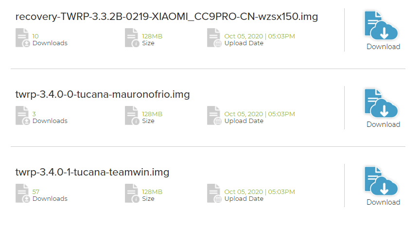

Hi guys. Hmm, I rarely update my ROM, I am coming from 20.6.4 and want to update again after 6 months. Just wondering which is twrp I should use on my mi note 10? And are there special instructions needed or I'll just follow again the usual step on the instruction. Just making sure before I start downloading all files needed again.
