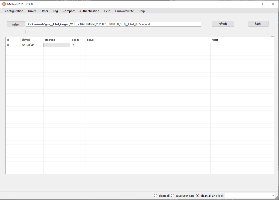

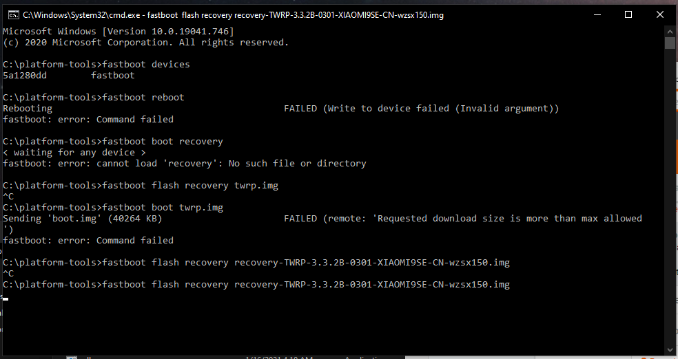

Nope. Fastboot now simply refuses to flash anything to my phone. And so does MiFlash (what's that with their official ROM packages and 'flash script not found', by the way?). Here's how it looks in the cmd. When I try to flash recovery, it simply freezes and nothing happens. I really need someone's help at the moment.

First try to put in fastboot manually (if phone have bootloop and got automatically in fastboot mode) with power + volume down.
I say this because i had my phone with fastboot image, but my notebook did not see the phone. After the button combination it see the phone.
After try if you see the phone with cmd "fastboot devices". If you see the phone open MiFlash to try to flash a stock rom. Remember the package extracted wiil be in a path without spaces (example D:\Xiaomi_Mi_10\stockRom and NOT D:\Xiaomi Mi 10\stockRom)

I do see, well, some device:
C:\platform-tools>fastboot devices
5a1280dd fastboot
It is the same device MiFlash sees. However, official instruction fir MiFlash on Xiaomi website suggests I should see a list of some scripts after I 'decompress' ROM image. This isn't the case. Also, trying to flash the stock ROM to the phone causes it to go from fastboot to a small 'press any key to shutdown' line in upper left corner, and MiFlash gives me the 'couldn't find flash script' message. Maybe I'm doing something terribly wrong?

Change the directory name where you have extracted the image. Its maybe to long.
E.g. D:\image\
But I would prefere the, method from my link

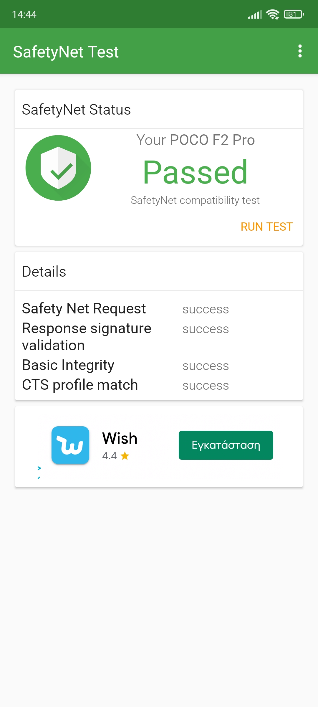

Safety net still doesn't pass on K30 Pro (CTS profile doesn't match).
Is there any solution without root?
With the new rom that you're going to download you will be fine , no root needed to pass safety net on Poco f2 pro ..
34214
BUT , do not forget to delete data and cache from those 3 apps , then reboot phone and you will be fine..
